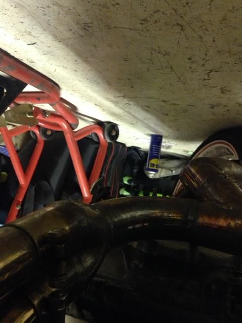

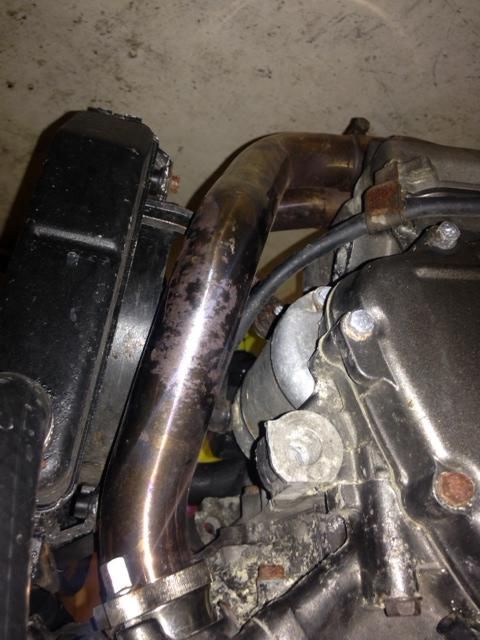

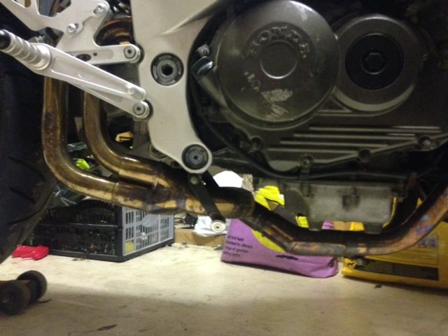

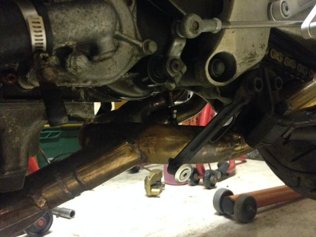

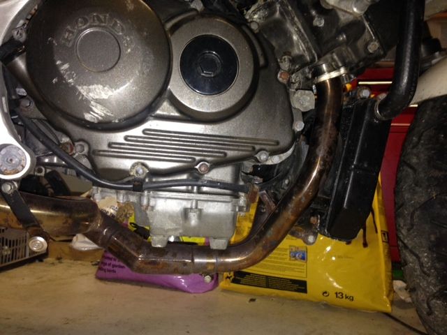

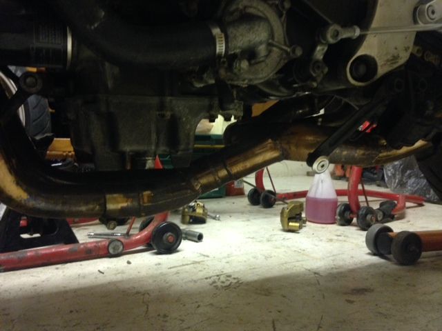

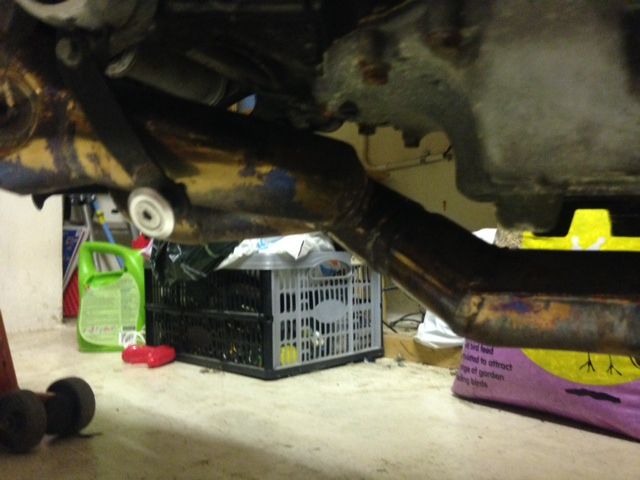

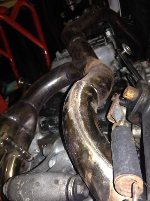

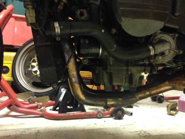

Jeff id say that the stock front pipes have been cut and a new section put in there to join them to the system, no idea what the system is but only a few route that way, micron, two bros.

that system ofyours is strange Jeff.. Looks like a DIY job under the front...

Yes I thought it may be made from a few different exhausts.CMSMJ1 wrote:that system ofyours is strange Jeff.. Looks like a DIY job under the front...
