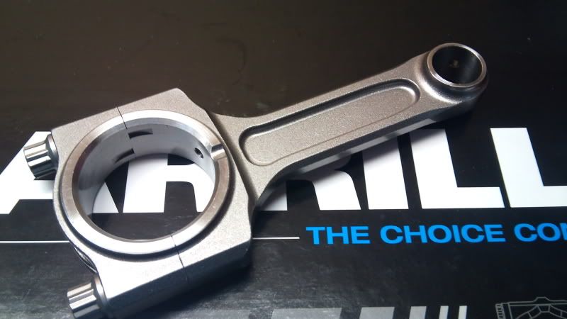

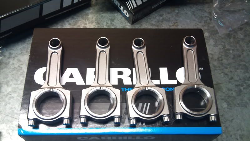

Re: SELEXON'S NC29 Pre Modern Racer
I finally received the new rods from Carrillo.
Talk about little hotties...
Very nice?

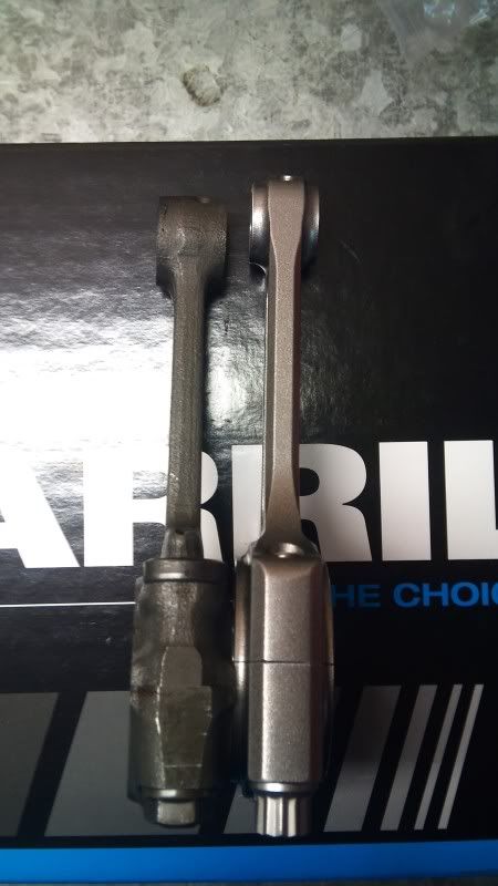

As I see new rod little bit longer. Are you going to change pistons ?
The length is the same as std, I just haven't lined then up even when taken the photo.PARUS wrote:As I see new rod little bit longer. Are you going to change pistons ?
The lower part of the rod where the bolts screw into is larger so gives it that little bit bigger look.
[quote="selexon"][quote="PARUS"]As I see new rod little bit longer. Are you going to change pistons ?[/quote]
The lower part of the rod where the bolts screw into is larger so gives it that little bit bigger look.[/quote]
What about weight compare with stc? Are this titanium or steel?
What is the part number, because I can't find them on manufacturer website ?
Hi Parus,
The Rods are 12g heavier then the std Honda items.
They are made from Carrillo's own proprietary chrome, nickel, moly, vanadium alloy mix.
I had to specially order the rods, it took them about 6-7 weeks to complete production.
