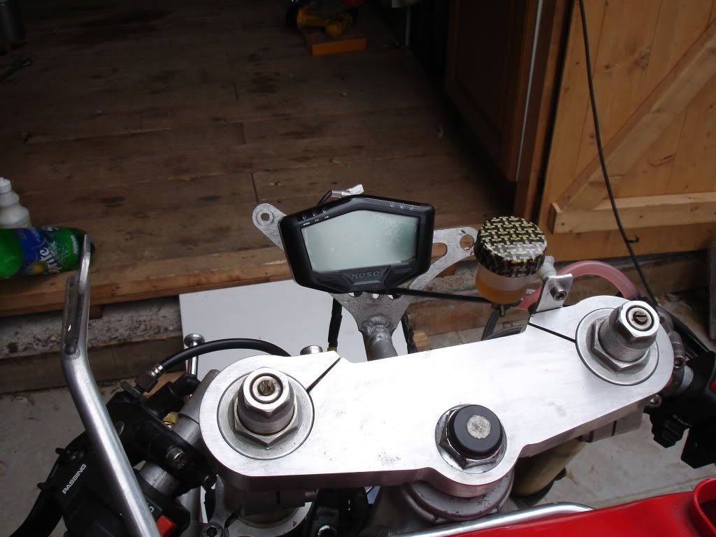

KOSO dash rocked up this morning
Not quite a translogic but at £125 with the correct speed sensor thrown in you cant complain. Packed with features too inc shift light.

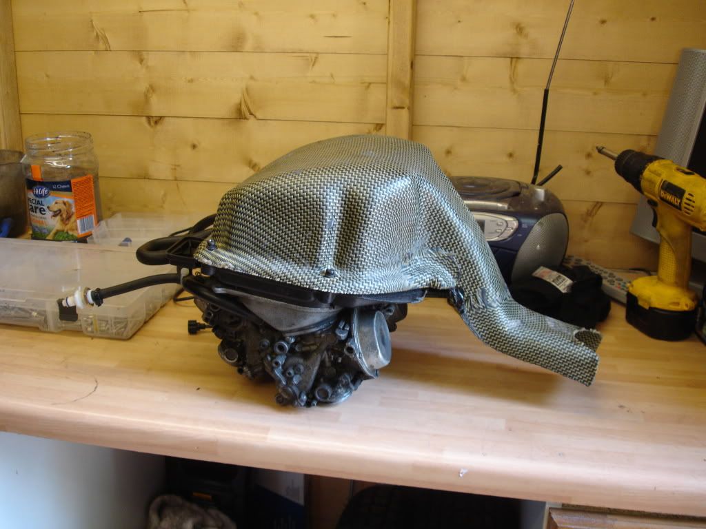

out with the old
Ram air modded 30 carbs and kevlar box

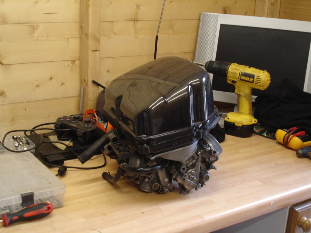

And in with the new
Standard 30 carbs, Tyga carbon box and K&N filter. On rick's advice im going to fit 122 dynojets, RO needles, no snorkle but keeping the rubber air deflector.
Im not going to get the power that the ram air setup gives but im gaining a filter and hopefully a slightly more road mannered bike
