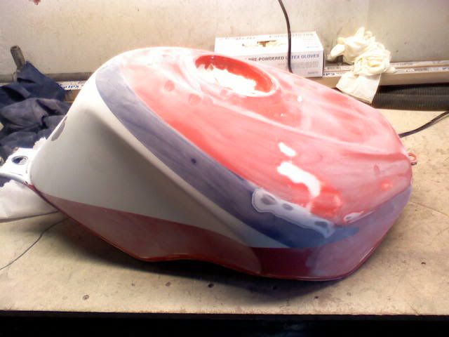

Thought the tank looked a bit out of place, so after a quick sand here it is
Will prime and spray black next.

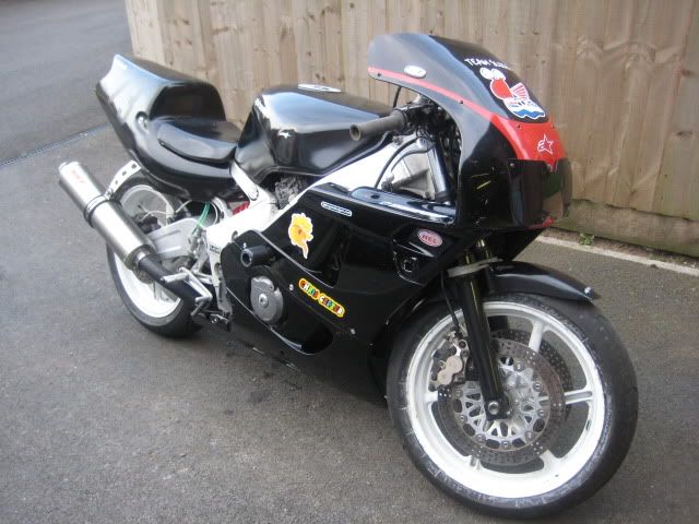

Right here she is, in the final stage of work really. Im at Donington on the 11th of July so i need to be happy all is ok. Took her for a quick taz up and down the road, but with the front tyre being new i couldnt test the brakes too hard. Seemed to be ok though, started and stopped so thats gotta be a good place to begin. The steering felt a bit heavy though, maybe its the 70 profile front tyre?
Will just be a case of tweaking as i go along now, although i do have a wish list of upgrades as and if the funds become available.
A front track fairing would be nice, as would a better shock and fork springs. But the main purpose of this was to build a track bike for the minimum money really.
Will post up how the TD goes and if anything gets upgraded.
Chris.
Chris.

Re: My attempt at building a track nc29(On a shoestring budget)
I like it man - that is cool.
Well done for sorting it!
done a nice job, like u said it'll just be a case of tweaking it as you go along gettin the setup u want.
so the big question is how much did it all set u back?
Total cost £443
£400 for a nearly complete bike, minus fairing and a few other bits (cheers DS)
£8 clutch cable
£4 oil and neutrel leds
£10 tyre changes
£5 gear rod clamp
£6 fork oil
£10 rattle can sprays
Chris
£8 clutch cable
£10 tyre changes
£5 gear rod clamp
£6 fork oil
Chris
Absolute bargain Chris, now to get out and enjoy it..........
