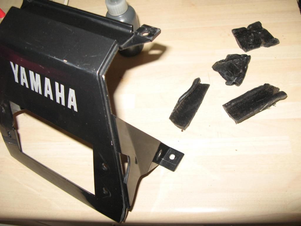

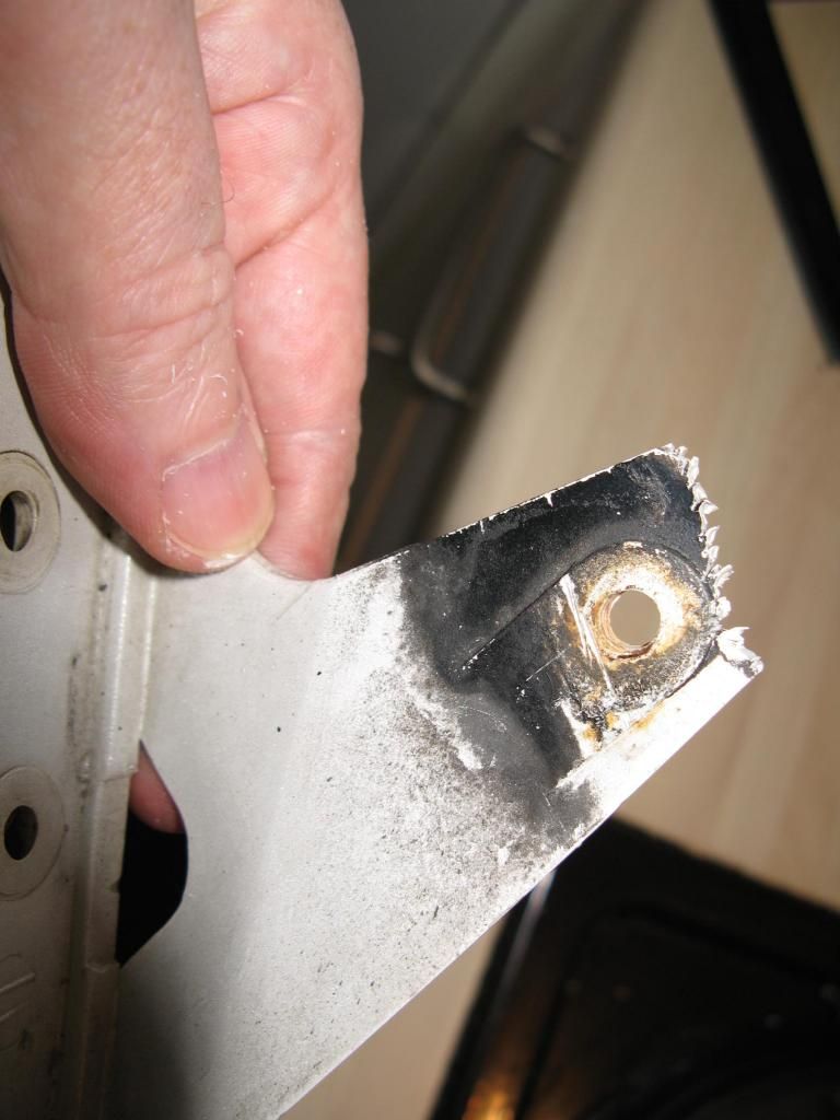

Well 2 weeks was a little optimistic huh. First I was jetlagged then I got a cold so it was Sunday before I got into the garage and then it was just to clean the frame + engine I bought recently. I did find my good mid tail section fairing bit though, I bought it back to the flat and set about patching up the other two with my Plastex kit.

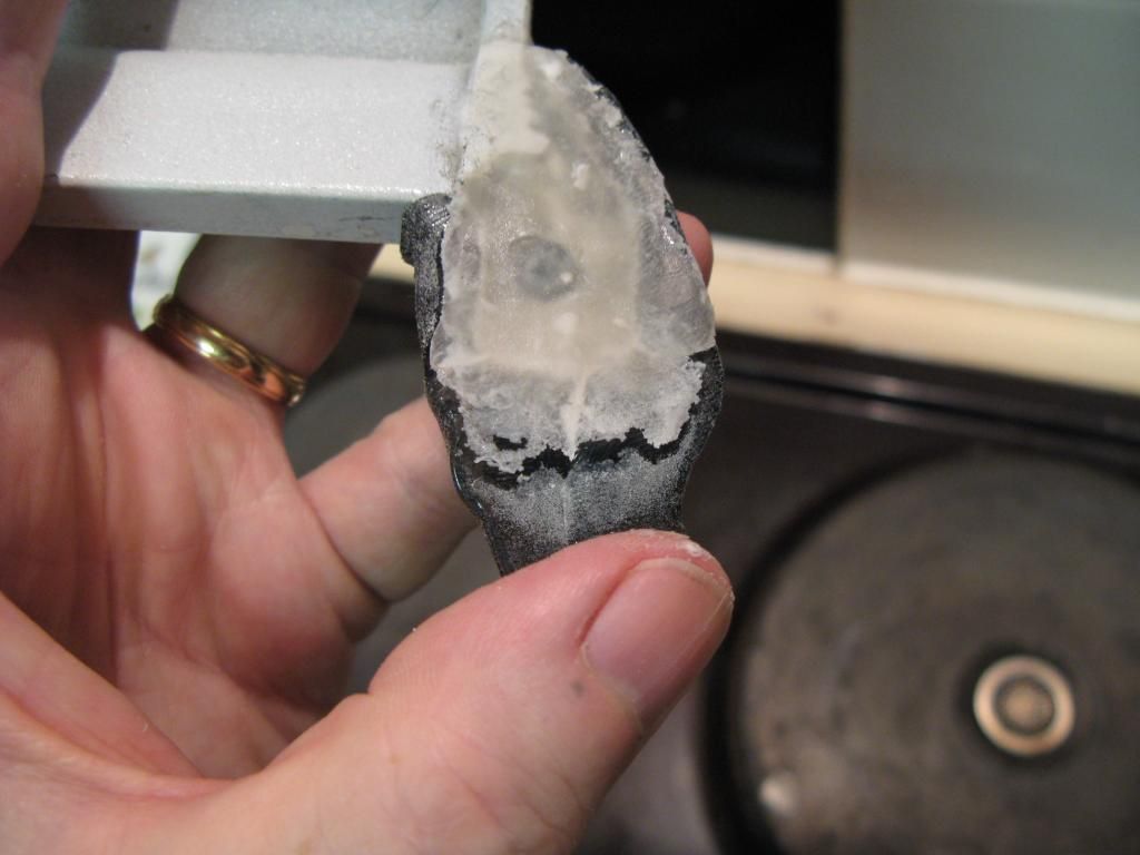

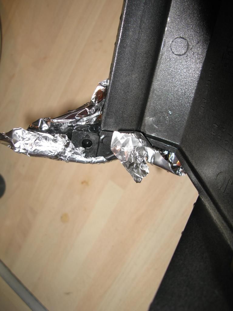

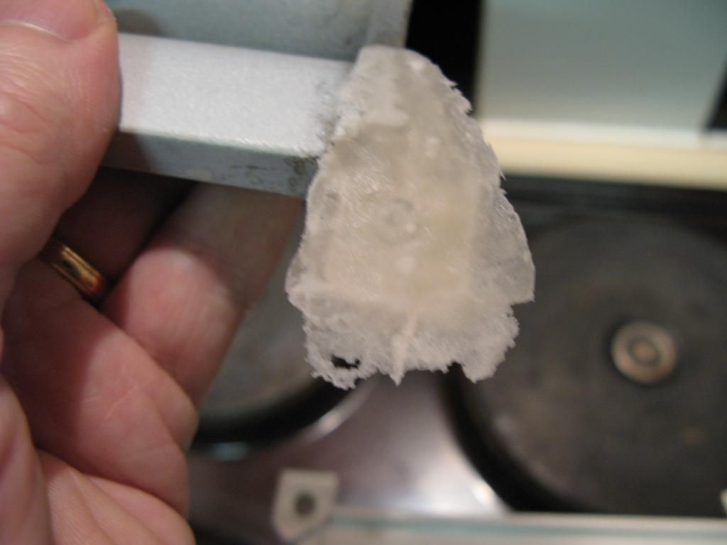

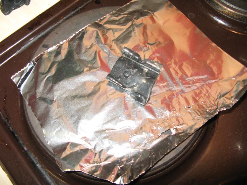

First I made some moulds to cast the missing lugs. Us clean new tin foil and a low temp oven. Squash the mould medium onto the lug and make sure you've got some way of locating on the broken fairing, a screw hole is best.

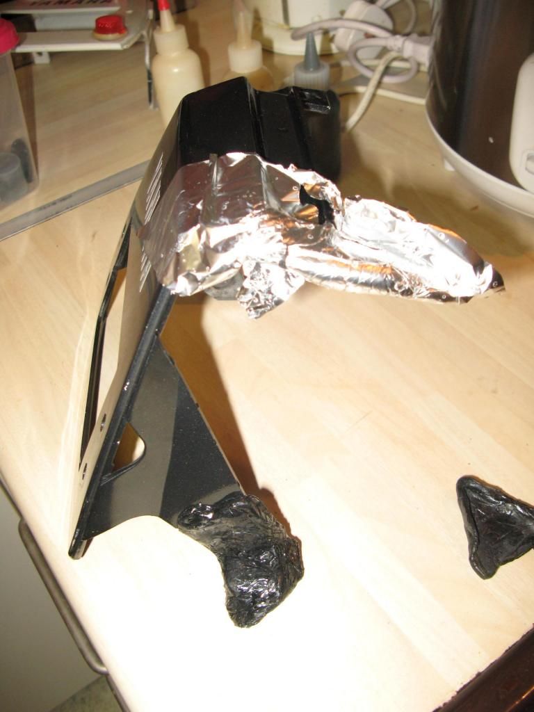

Rough up the joint for the new lug I cut into the fairing with a scalple
Then place the mould on
And fill the mould with the Plastex. Plastex is a plastic dust that is dissolved by a spirit then when it dries the plastic is left
I used white and clear for these the clear is a little easier to use. Leave it to dry for a while and then ease the mould off
Trim it with a scalple when it's still soft but other wise you'll need a palm sander - I'll be doing this tonight. Ad lib till fade ...

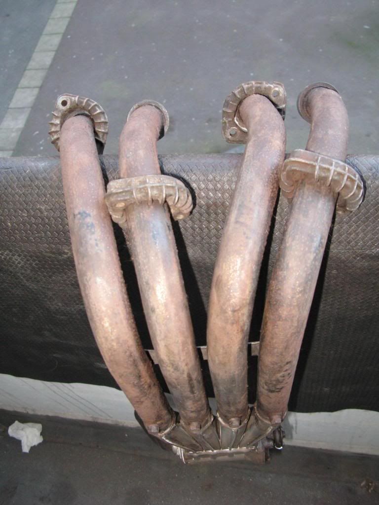

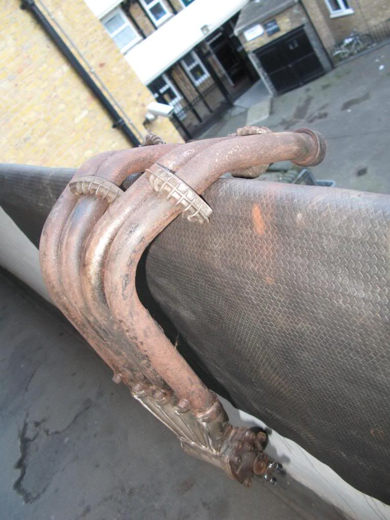

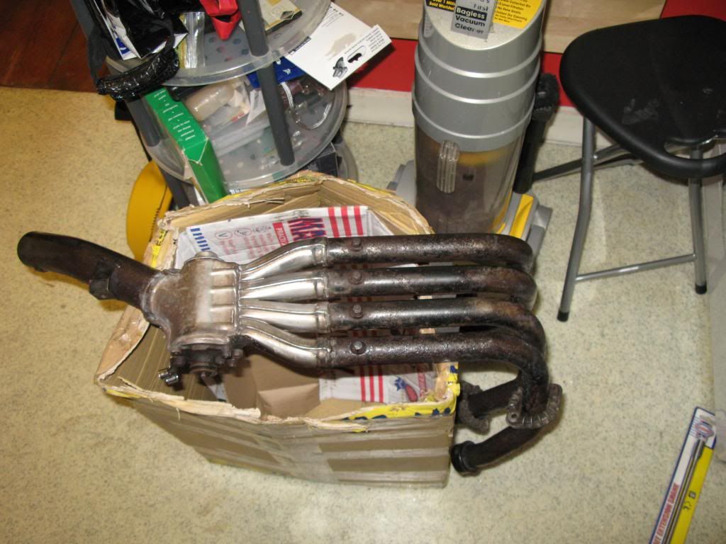

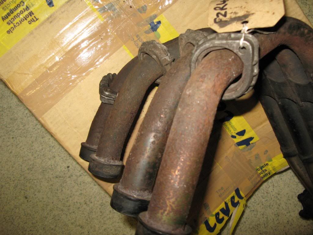

I've been on the lookout for some downpipes since I got this bike so when a rusty set turned up on the bay I bit the bullet and bought them.

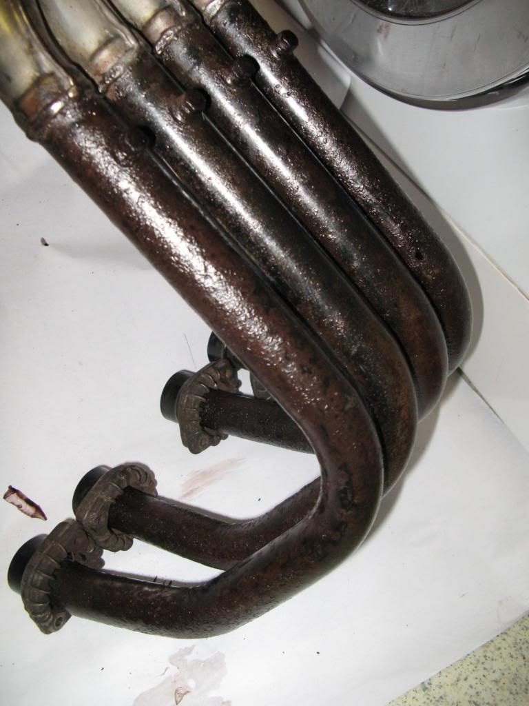

The first job was to get the worst of the rust off them, I used a brass wheel on a slow drill and then gave them a coat of rust killer.

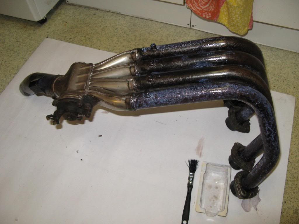

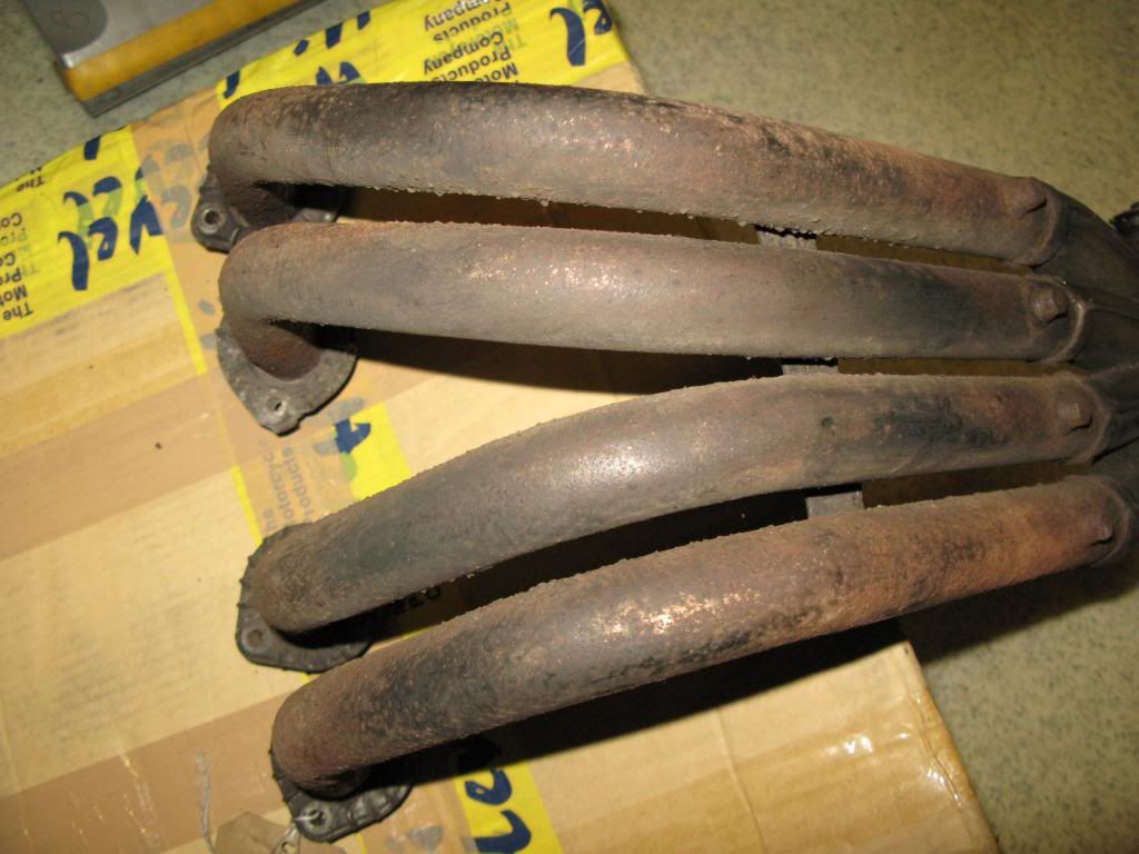

The next weekend I used a fine grit paper with my Mouse palm sander
And another coat of rust killer

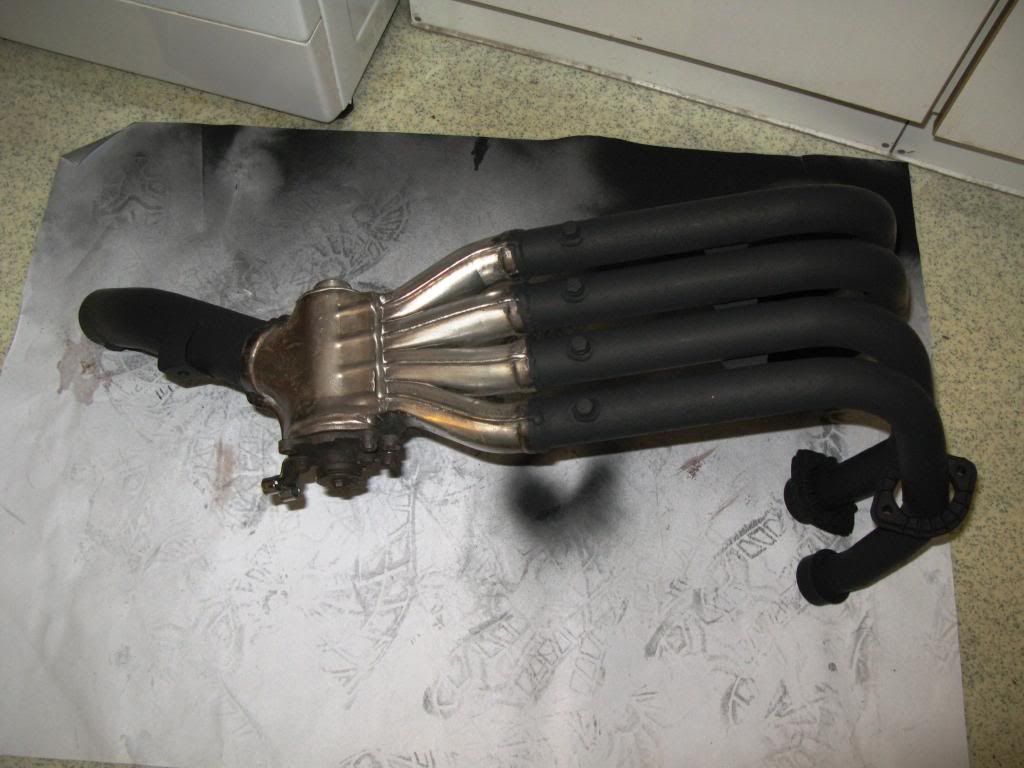

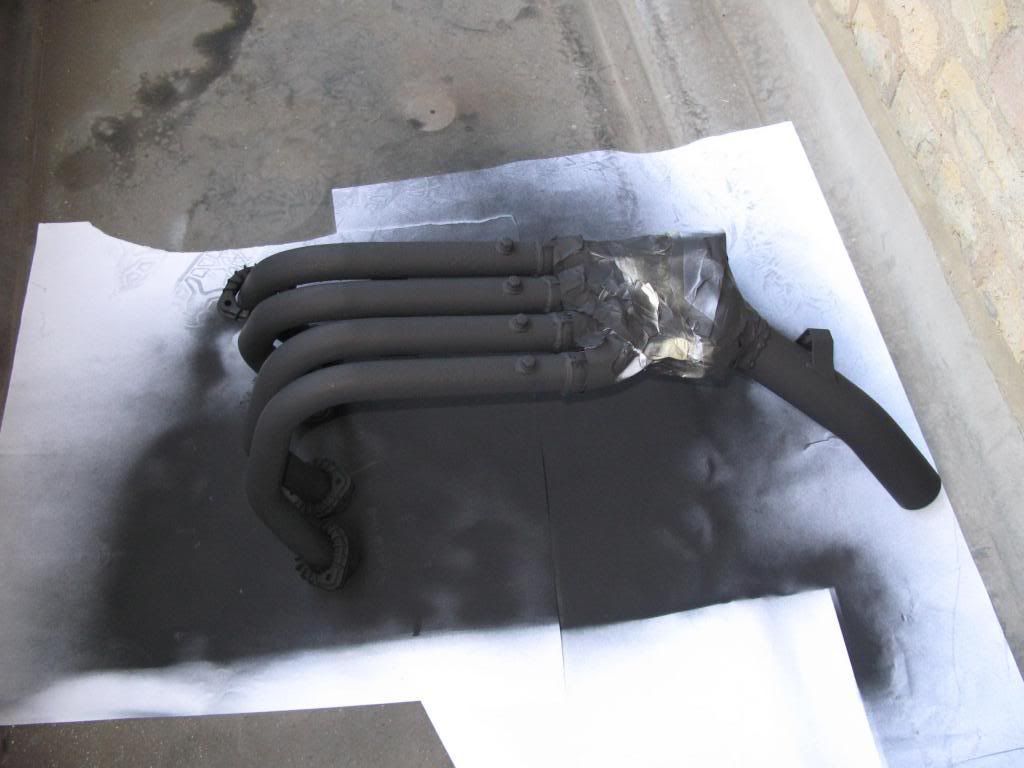

I missed the light or it was raining so I had to wait another week before I painted them
I't not the best set in the world but they'll at least be servicable.

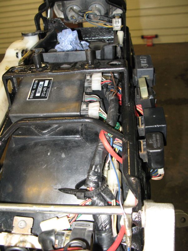

It was a little while ago but I put a different wiring loom on the bike. The last one had a live patched in from the solenoid to the kill switch and a 1WG reg rec hard wired in. It's a bit of a long job because when I found the wires went in certain way I had to unbolt the plate hanger and the undertray then of the CDI would fall out ... oh how we laughed.
The clutch and brake levers were put on too, with luck I'll get the exhaust can, pillion pegs fuel pump and carbs reinstated this weekend

nice job on the pipes
i had to get a new/SH set for mine and although the exup had been overhauled and cleaned up, as had the pipes themselves, and tbh were in excellent condition not even any pitting, i still give em a coat of ultra high temp paint every year when i take her clothes of for the pre-MOT inspection, getting rarer and worth keeping in tiptop condition

I reckon an exhaust maker could restore a set of down pipesby cutting the old ones off and welding new ones on. You can see the exup chamber on the 3TJ is stainless so they stay in resonable condition on the outside at least.

anyway your right any decent pipe bender could come up with something to suit, but it's the one off price that'll kill ya, and like you say the valve housing is stainless so you could go for a full on stainless setup but it would cost some more on top
