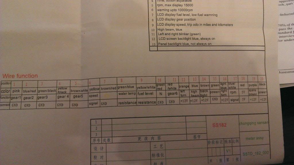

Ignition coil primary drive signal? that is the two spade connectors at the back of the coils right? if so... no i have not tired that yet.
here is what i got from my chinese friends. these are the only instructions i got, plus the wiring numbers and its function.

Re: NC30 clock change and no start.
Try either the blue/ yellow or yellow/blue wires at the front or rear ignition coil. Can you post up all the info that came with the unit.
