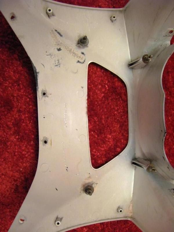

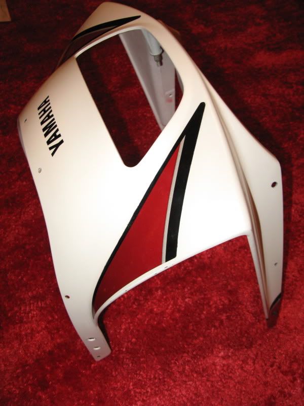

This is the one I sold on the bay - it wasn't as good up close - I'll see if I can find some more pics.

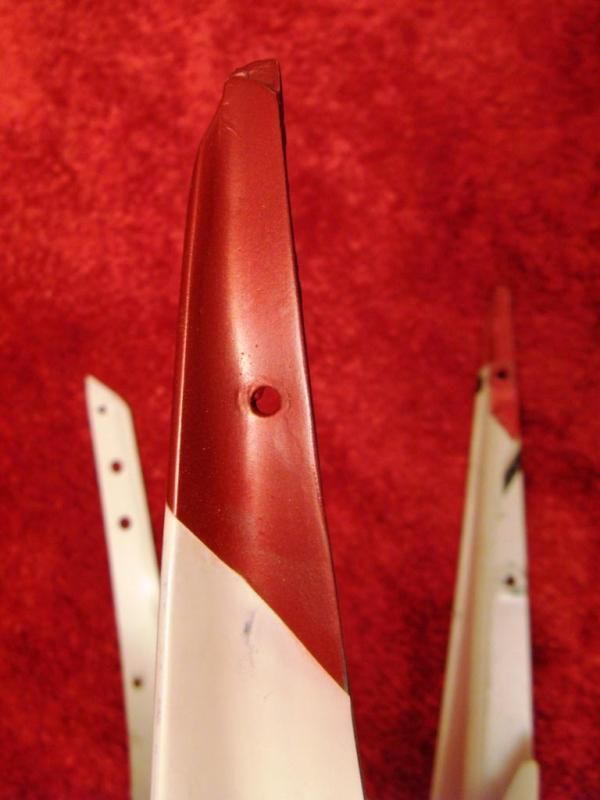

Both the two top mounts had cracked; one of the mirror ears was broken but there the other (on the photo's side) was cracked; the bottom end joining the fairing was broken so I made a new bit; all the screen holes were drilled out to a bigger size so I filled and redrilled them.
I sprayed the white, retouched the red - not a great job but ok from a few paces away, I put a new Yamaha sticker on it.
I used cans to spray it which is ok. I don't mind sticking them together but it might be better to get a sprayer to blow in the paint. Cellulose would be more resistant

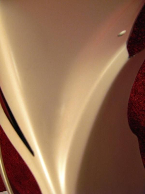

Here you go
Inside - shows some of the repairs
New piece cast and attched - I didn't have the stripes to put over the paint edge

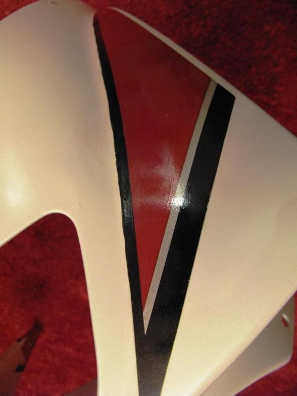

I had to paint where the sticker was broken ... not so straight lines huh ?
Still some visible imperfections
