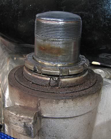

Headstock bearings
While grubby on the outside, I was surprised to find the headstock bearings inside were clean. A first inspection suggests they don't need replacing but experience tells me it's not until the bearings are thoroughly de-greased that it's possible to spot tell-tale pitting and traces of wear.

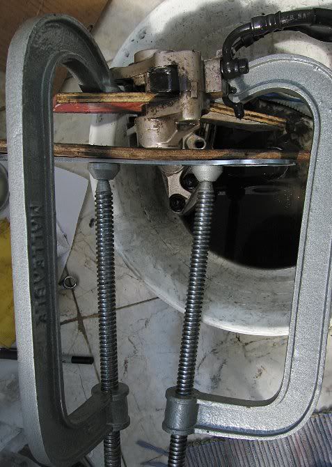

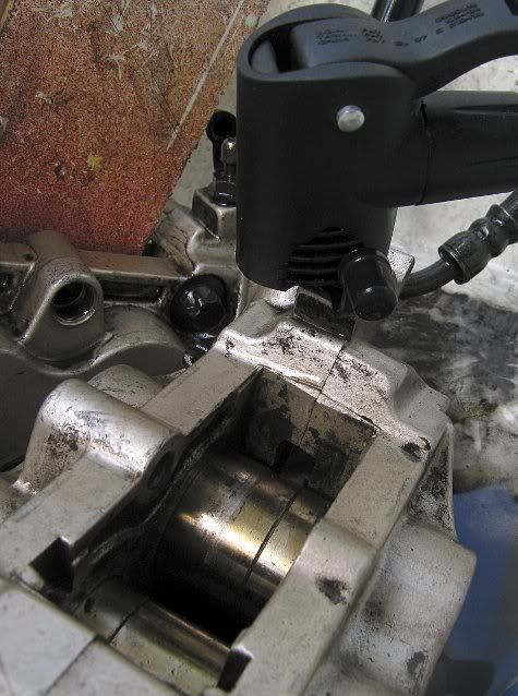

Currently stripping down the brake calipers. Out of eight pistons, seven were stuck solid. Astonishing the brakes even functioned. Probably because the discs had "adapted", which explains why they measured 3.4mm.
As of lunchtime, three pistons are moving. In the absence of a high pressure line, the "bicycle pump" technique is working fine. Clamp the pump to the bleed nipple, slacken the nipple's seal bolt, and administer 40-140 ft. lbs.. Be sure to place some wood between the pistons to absorb any shock as they jump forwards.
Do NOT forgot the pump isn't connected to your push bike, and disconnect the pump without tightening, and thereby shutting off, the bleed nipple. A brake fluid fountain awaits anyone who forgets...

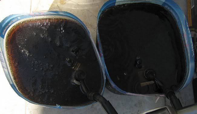

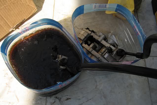

To remove the last two stuck pistons the brake calipers are enjoying a Coca-Cola bath.
I haven't tried the Coke bath before, so it'll be fun to see how they turn out. I'm told, twenty-four hours ought to do it.

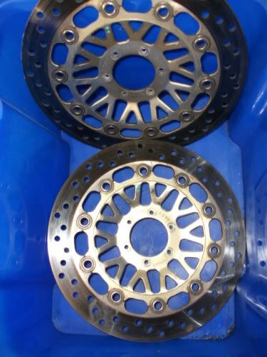

Brakes
The need to pay for new brake discs - Abrmoto's Yamakatas - means I'm trying the least destructive piston removal methods first! If I had to buy new pistons, some secondhand SP2 calipers from the US might be better value. Thankfully, the pistons extracted so far all look fine. That said, the time taken to remove seized pistons does make one think about retro-fitting non-OEM stainless steel pistons.
Yamakata NC30 brake discs
For generally humid Thailand, esp. the rainy season, stainless brake discs make sense, too. The question is, how will they stand up to the local mountain descents? At least the EBC HH rated sintered pads that arrived today look substantial. With a full overhaul and a new set of shiny Goodridge SS brake lines & fittings, carefully bled, these brakes ought to be pretty good. I hope!

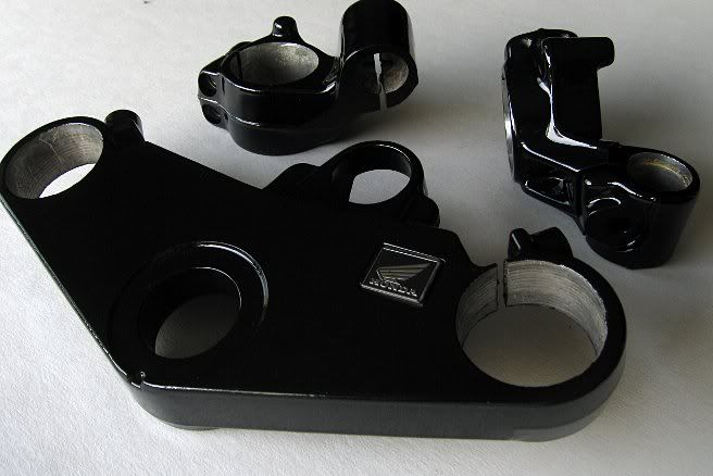

Powder-coating
Picked up some powder-coated parts today.
I'm very happy with the finish. The gloss parts came out an almost liquid black.
Dropped off the fork lowers for their powder-coat, and the nice lady from Honda Chiang Mai gave me a new Honda emblem for the fork yoke when I collected a handful of parts that had been on special order.
