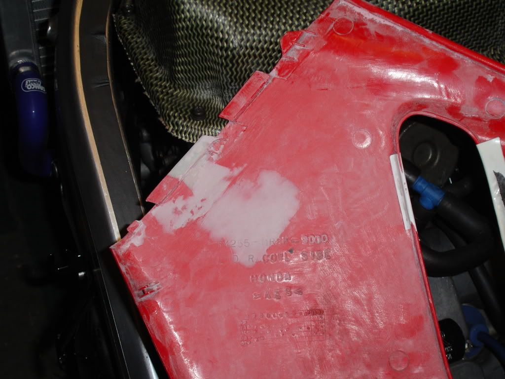

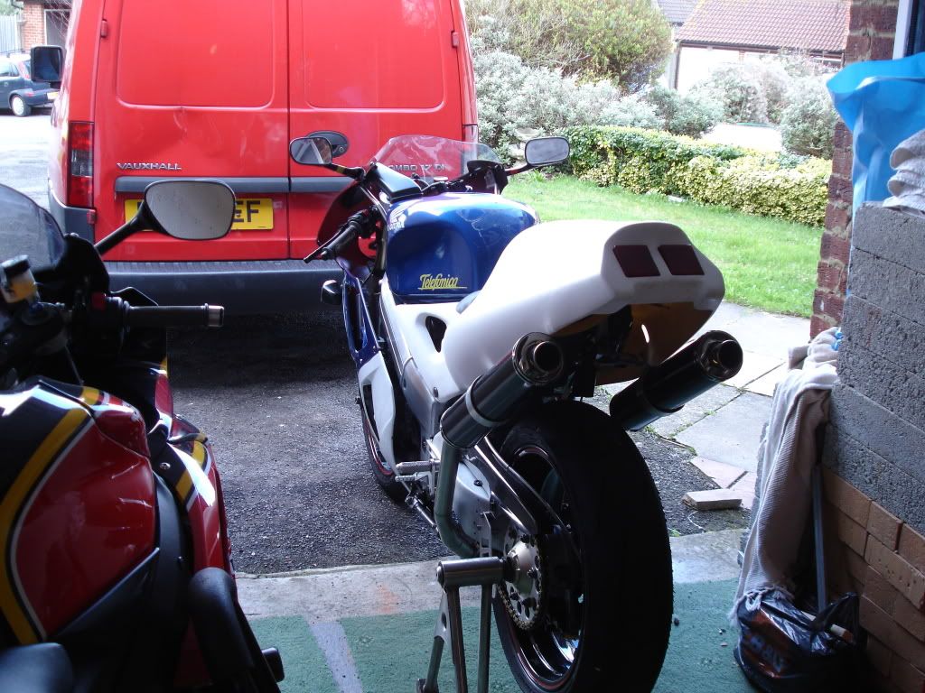

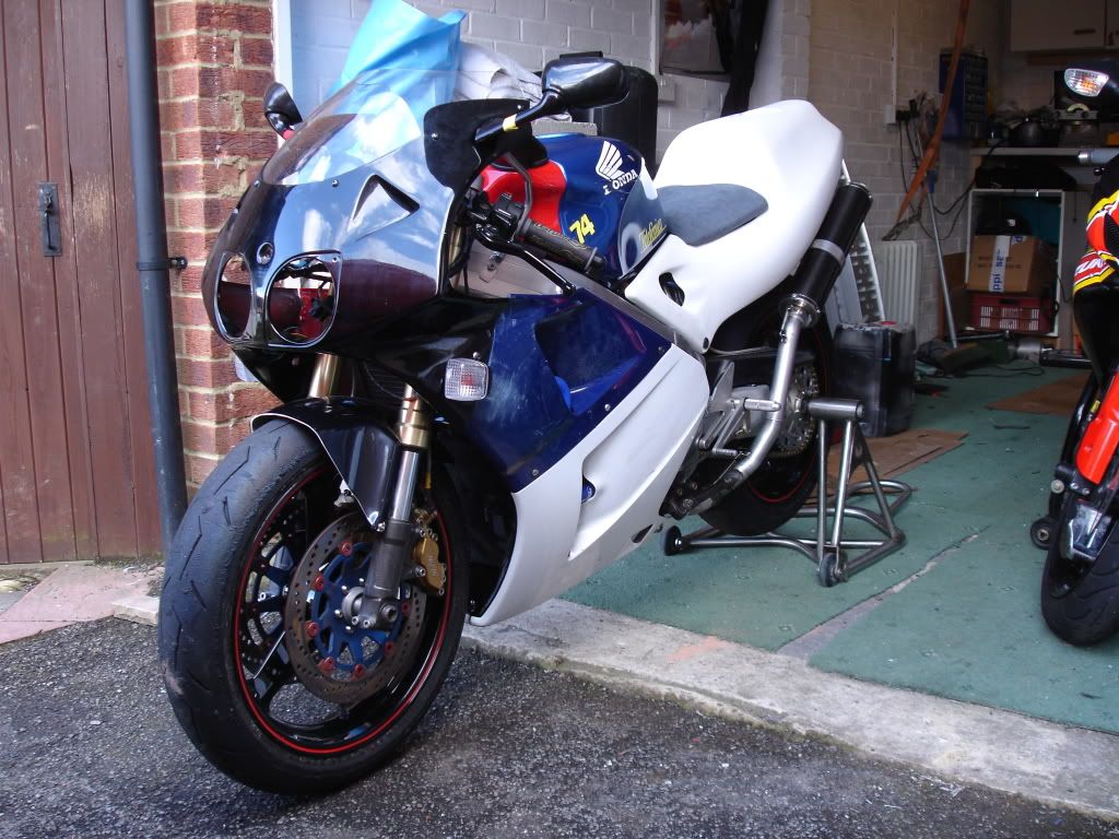

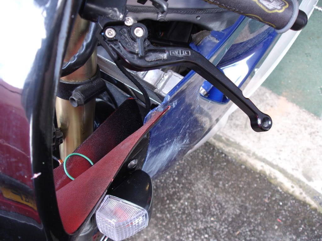

Finished repairing all the lugs and cracks in the panels so trial fitted them all
After lots of bracket tweeking it all fits really well apart from where left mid panel meets the nose cone, might be able to get it better but may just make a lug for the nose cone to straighten it up.

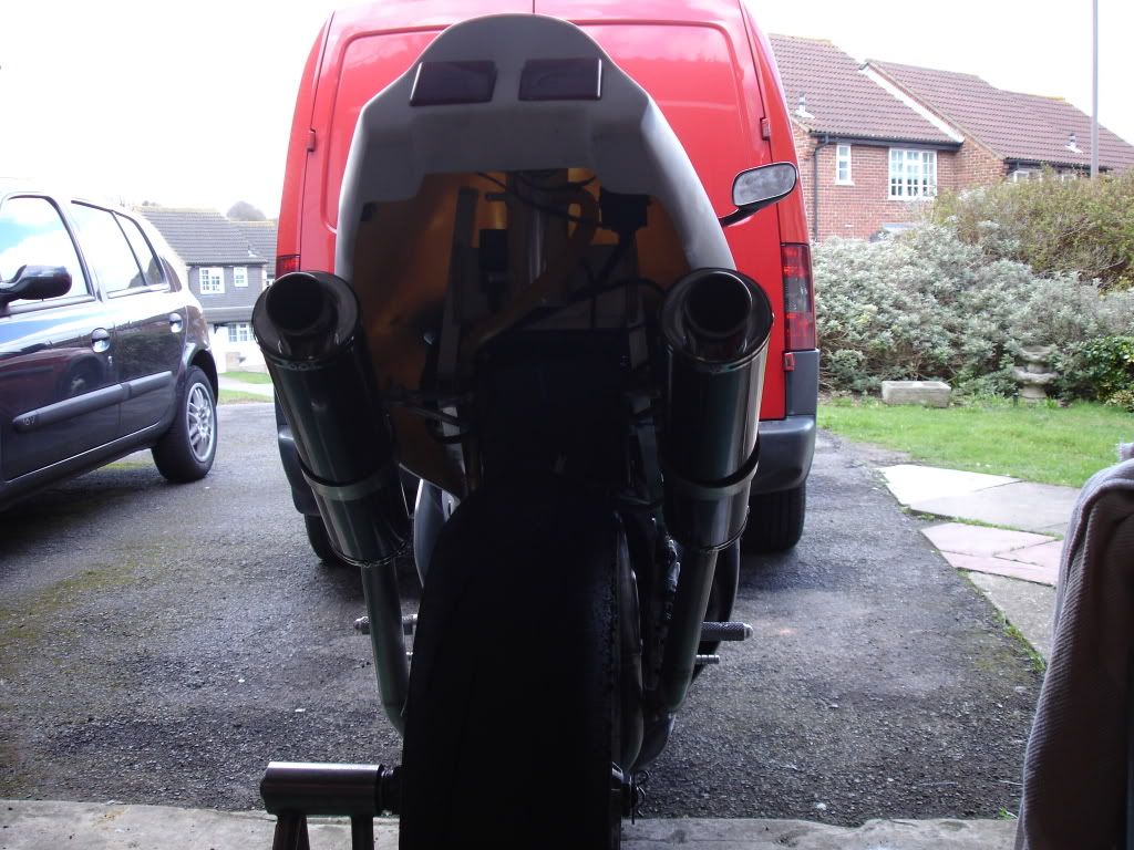

Rear light doesnt fit that well, gunna have to re-drill the mounting points as too the left seat unit mounting point so the lug fits in the tank. Still need to make brackets for the headlight, dash and rileys old carbon tail tidy.
The bottom rad isnt fitted in these pics, the lower panels are going to need cutting to fit around it and the bottom left rad hose sits lower squashing against the panel so may re-shape that

Glad you put that panel to good use, was going to bin it. It's starting to come together nicely tony. Is that a tyga seat unit as i am looking to single seat mine.
- micpec
- Posts: 1298
- Location: The Netherlands
Tony, you have made good progress with the AM-PM bike. Really would love to see when the new paint scheme is on.
PS: did you made the blanking cover for one of the headlight gaps?
Yeah seat unit is tyga, great quality but rear light mounting points need re-drilling to fit properly.Micro Monkey wrote:Glad you put that panel to good use, was going to bin it. It's starting to come together nicely tony. Is that a tyga seat unit as i am looking to single seat mine.

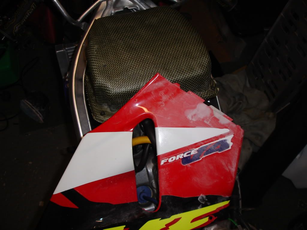

and thanks for that panel, couple of hours with some plastex turned this
Into this
Ive since cut a notch in the lug i made so it fits the nose cone. Plastex, fantasyic stuff
Yeah i made 2. one for each side but im not tottally happy with them. I may still bite the bullet and get some from silhouettemicpec wrote:Tony, you have made good progress with the AM-PM bike. Really would love to see when the new paint scheme is on.![]()

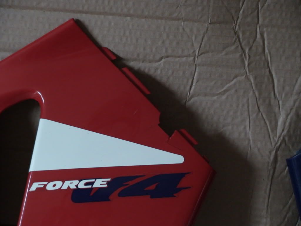

Been sizing up for the decals this morning and im not happy, there just isnt enough room to get a decent sized am-pm decal along the side panels
Really dont want to change the design of the theme but its gunna look so naff sqeezing the am-pm decal between the 2 side panel vents.
I need to fit this
On to this
Anyone got any ideas? the way i see ive got 2 options, 1. redesign the theme to fit the panels or 2. mod the panels to give a bigger surface area.
Im siding towards option 2 but its hard to vision how its going to look. Size wise there is 1 1/4 inch between the lower vent and the panel join and 1 1/2 inch for the top vent. Id like the stripes to be 1 inch wide which leave no room for the am-pm bit without folding it round the vents.
