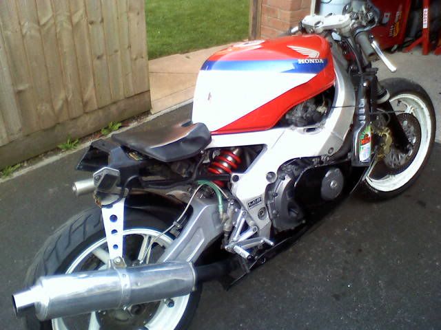

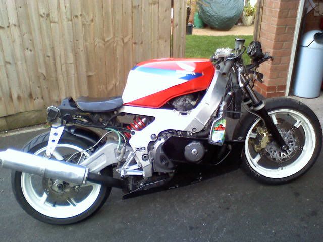

Sorted the track tank out now with the fitting of the race fuel cap and fuel tap. New clutch cable fitted and adjusted. Started her up and was going to tootle up and down the close but was cutting out when i put it into gear. Took tank and seat off and went through the race loom again, eventually traced to a poor earth from the cdi. Maiden journey complete, all 10 metres of it.
So now im going to go over every nut and bolt again, then its just need to source some part worn 090s, then off to the local tyre man to get them fitted.
Chris.

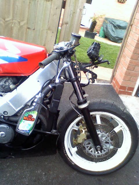

Loving the expansion bottle, do you have the HRC part number for that????

I like this HRC Mr.Muscle coolant bottle :)))

It loves the jobs i hate!
I think GF is selling 160 rears, so no good to me as i have the standard chain and sprockets. The fuel taps just the standard one mate. The Mr M bottle is temporary unfortunately. Will check that date in August.

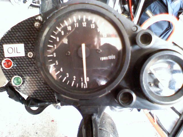

Anyway ive now tidied the cabling to the clocks and warning lights, after soldering in the oil and neutrel leds. Got quite excited seeing that they work, i know small things etc.
