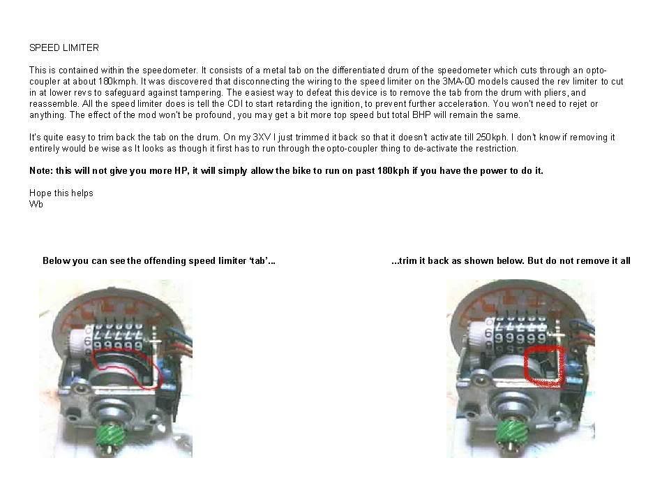

Thanks for posting that up.maccas wrote:
Adding to the above. DO NOT!!! fully remove the tab it will restrict in all gears.
Dan
Have you tried this method?
Is the 3MA speedo of the same construction as a FZR (restricted models) ?
The reason asked is;
Quite a few have tried to remove the speedo entirely for race purposes.
One stated categorically ; just remove the sensor and sender tab from the speedo, discard speedo , Gaffer tape sensor/sender and tuck it and the connecting wiring in behind the tacho.
I cannot see how this could be accomplished if the innards of the speedo are as pics.
The drive cable would still need to be connected to the restrictor unit. !
Unfortunately ; I have no spare restricted speedo head to experiment on ; only a 4DX unit clock assy.

Yes the speedo internals are identical to a 3ma 3xv and 3tj. My 3tj had the tab trimmed back when i got it and it would pass 180kmh no problem.
I've since removed the speedo as its become a track bike. I removed the circuit board from the clocks, left them plugged in and screwed the circuit board to the side of the rev counter. I place a piece of plastic inbetween the optics prior to turning the ignition on then once the engine is started i remove it then the bike is in unrestricted mode.
If you leave something in the optics it will restrict at 12500rpm in all gears.
If you unplug the circuit board it will restrict in all gears same as above.
Dan
Dan

Thanks maccas; quite a good idea and explanation,
now we are getting somewhere with this !

Re: 4dx cdi problems again
The workaround bit is a new method, using a removable tab of plastic.
