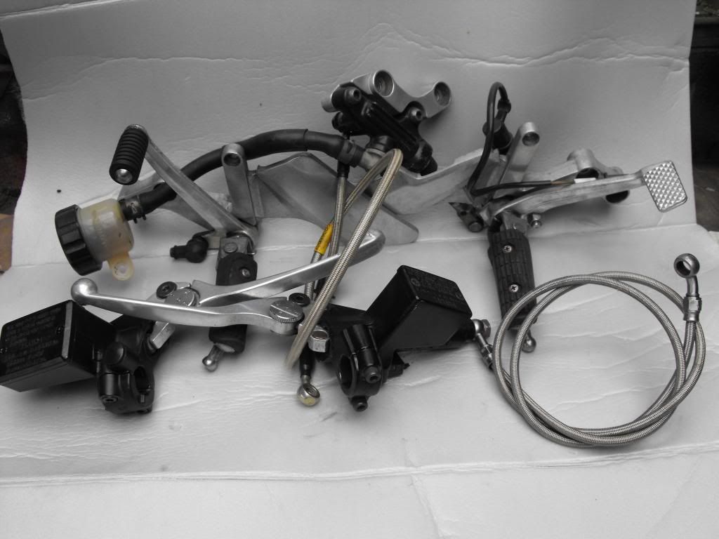

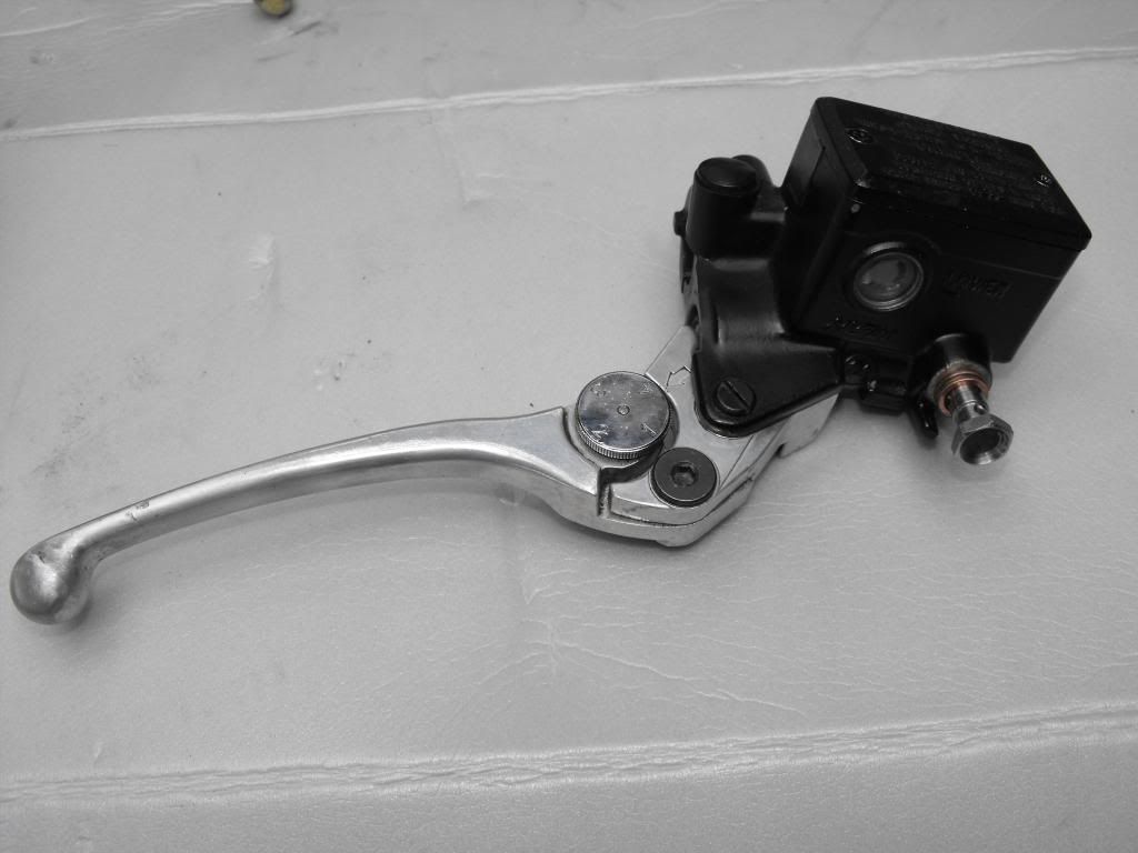

I changed plans from using Zxr remote reservoir units to this from a Fazer and will retain the fitted Yzf clutch master cylinder; frankly I could not be arsed to start fabbing up reservoir mount brackets.
The footrests got a quick clean and grease, replaced the bent brake pedal and worn gear change rubber.
Retained the somewhat worn footrest rubbers as they are still serviceable.
Cheap braided hoses for clutch.
Levers stripped, greased and crash damage polished out.

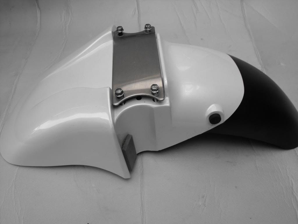

99p ebay front mudguard cleaned up nicely;there was not a lot wrong with the original though.

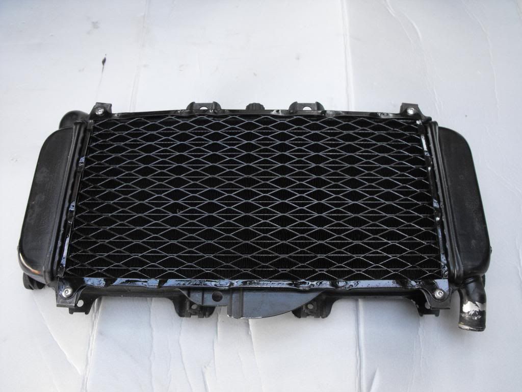

Rad is in very good condition,quick coat of satin black on the mesh guard and its ready to refit.

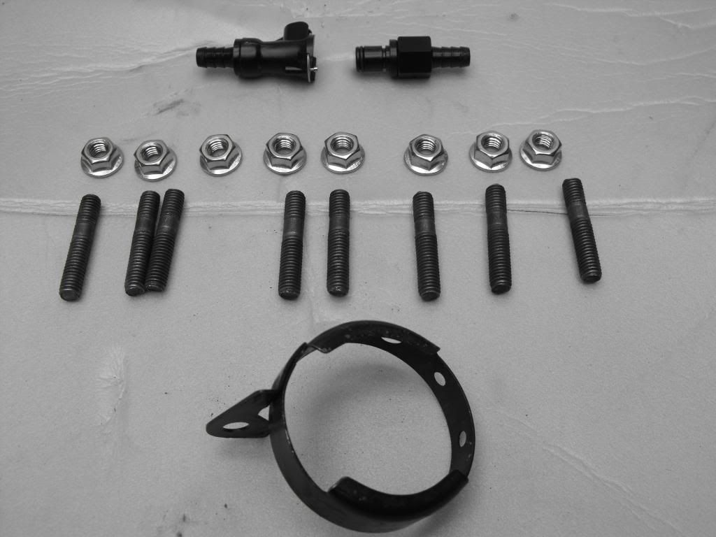

A few parts were delivered this week.
Quick release fuel coupling (no fuel tap fitted to tank)
Stainless nuts for headers.
Header studs to replace incorrect bolts.
Locking ring for rear brake reservoir.(another 99p ebay item.)
