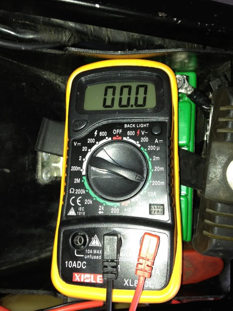

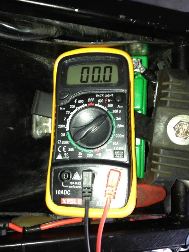

Right, multimeter set to 200mA no readings between negative lead and frame at all.
Multimeter set to this :
Reading of 0.3 when alarm disconnected, and no reading when reg/rec also disconnected. Didn't test with the main fuse out.
