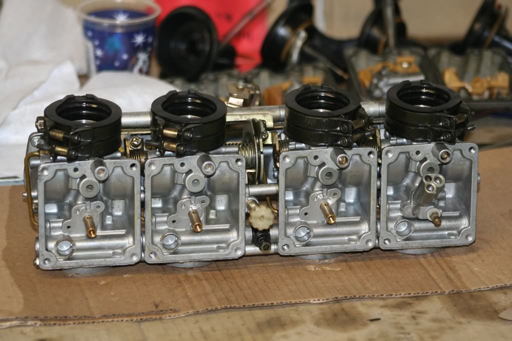

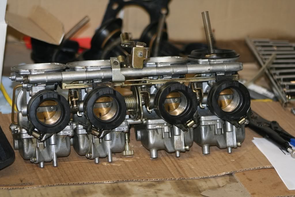

I took the carbs off tonight to give them a clean.

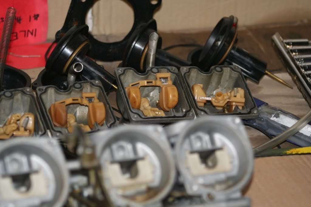

First off I removed the float bowls and floats, then took the caps off and started removing the diaphrams.
Don't forget to take the little O-rings off aswell.

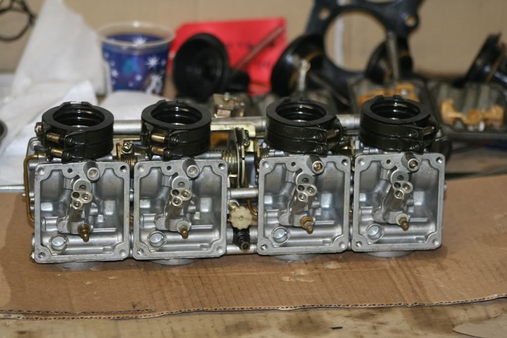

I turned them over and removed the jets.
MMMM, evidence someone has been fiddling. The retaining nut on the end one is different to the others.
I then removed the holder for the jets (I don't know its proper name)

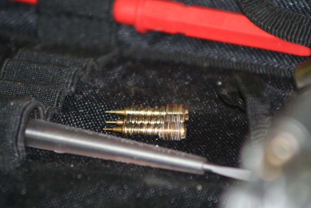

While I was blowing the carbs out I noticed one of the mixture screws was leaking (it was blowing small bubbles). I removed them all and noticed the one that was leaking was different. Here's two of the screws and the odd one!

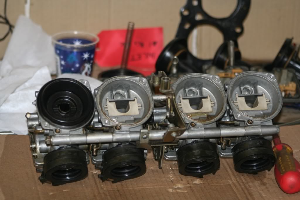

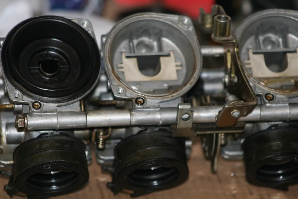

I gave all the carbs a good blowout with the airline. I also removed the guides for the slides and needles when I did this. Then started reassembling them.
I put the carbs back on the bike and connected everything up. Time to push the button again.........

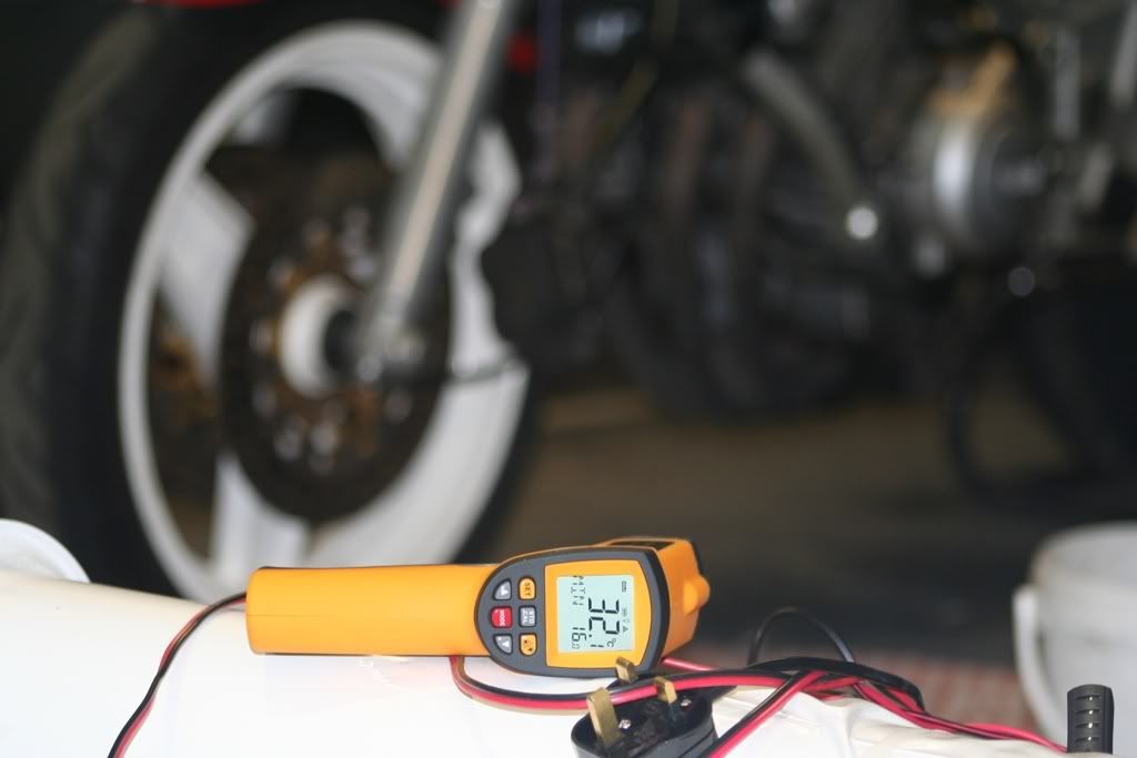

Another new tool, I'm going to use this for measuring the temperature of the headers. I gave it a quick go and 1 & 2 are running hotter than 3 & 4.
It took a little persuasion to start with, but then she fired up. Still running rough but with the mixture screws and balancing to sort out I expected that.
I should be getting another set of carbs soon so I'll replace the odd parts then. It will give me time to try and find a supplier for new screws, etc. (I've got a couple of phone numbers to try).
