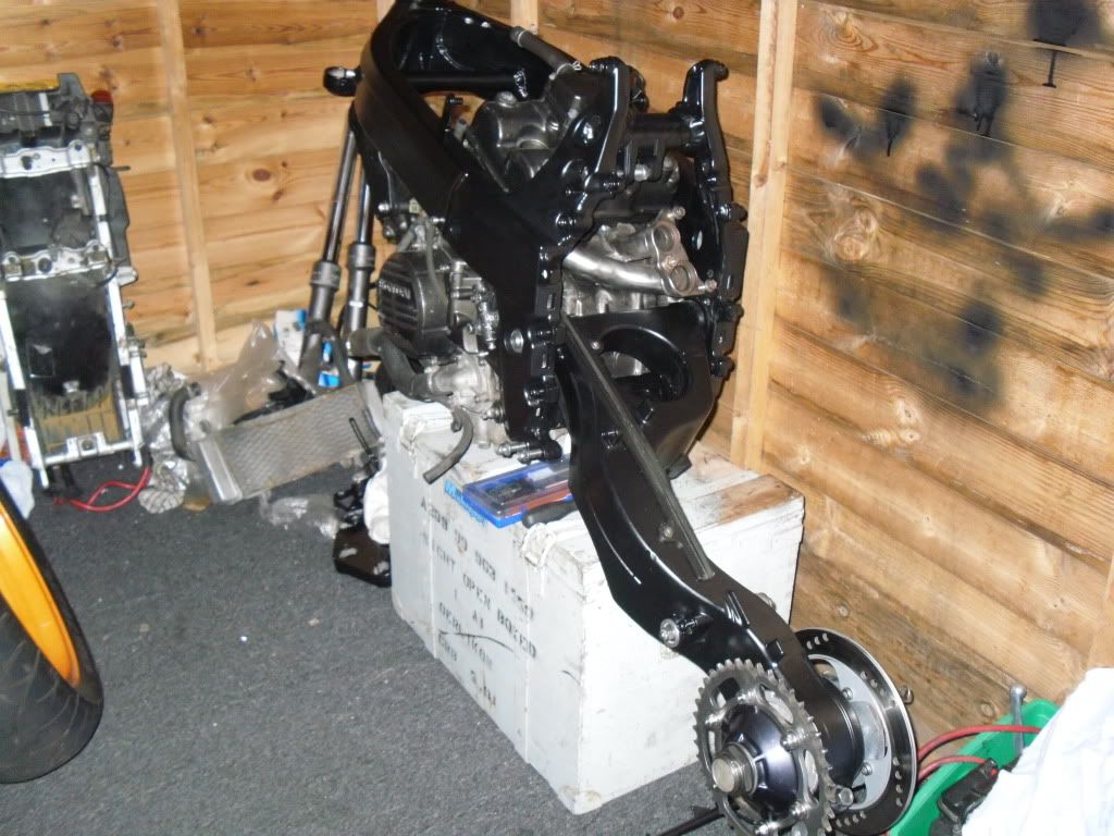

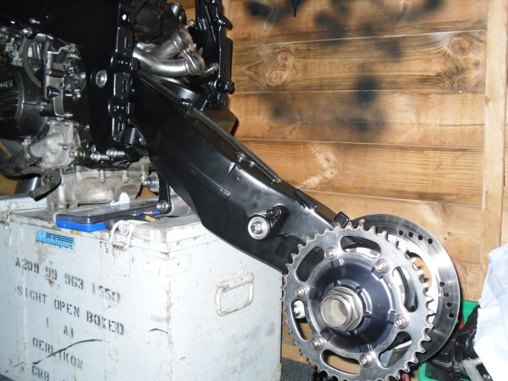

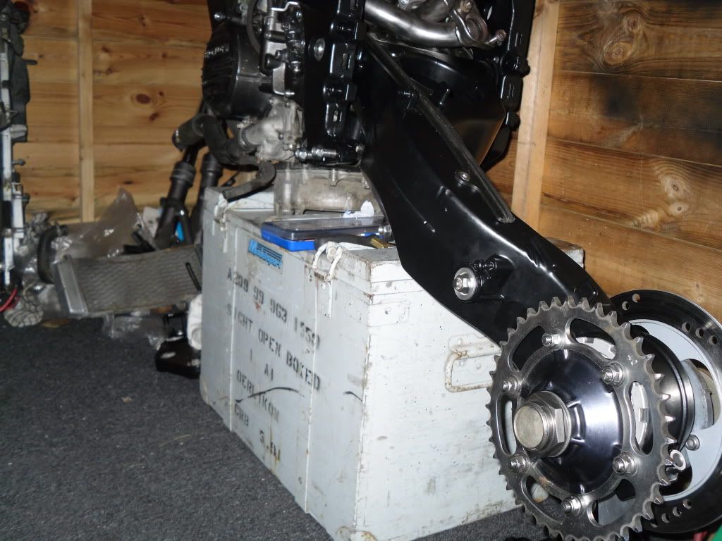

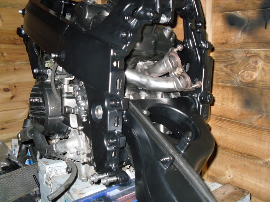

a little more progress made, got the swingarm back together and the engine back in the frame
the engine has had a fairly good clean up but needs a few paint touch up's, then will remove the water pump housing and the thermostat housing and polish up along with the sump and spray the speedo drive , some carbon covers should tidy it up a tad more,
i didnt really want to start pulling the motor apart as it really runs quite well so dont want to end up causing any probs by doing so, so i just chucked it back in the frame,.

Re: Deviants nc30 strip and rebuild
Looking mint!

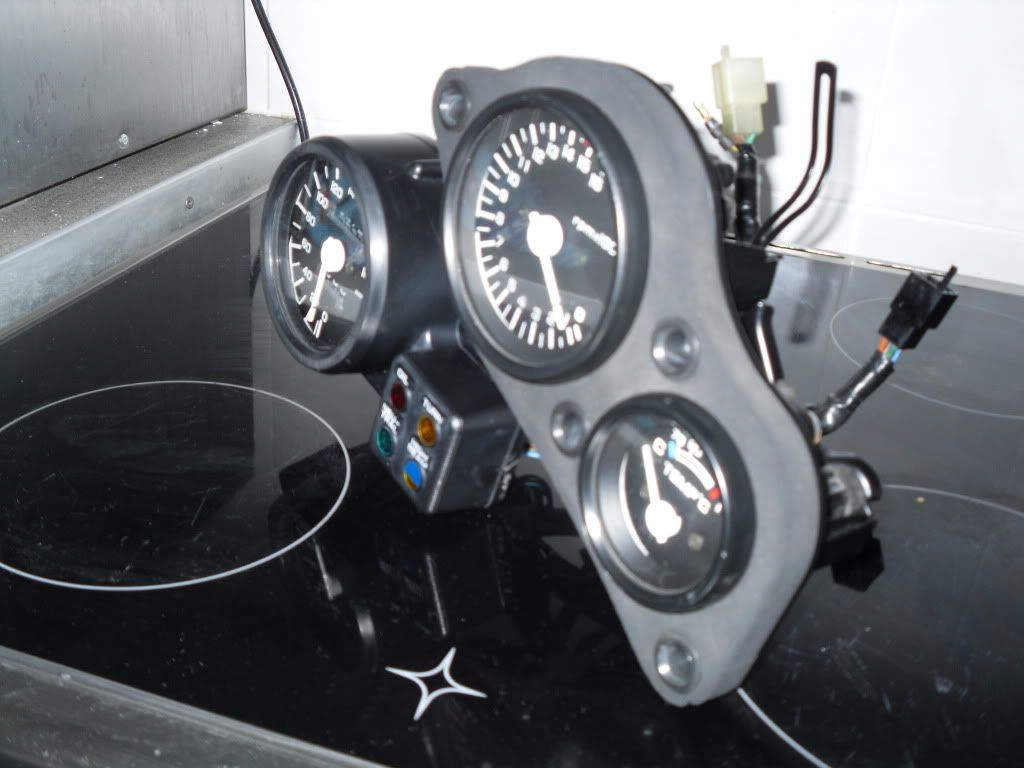

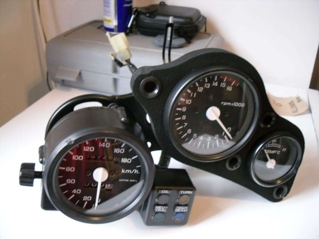

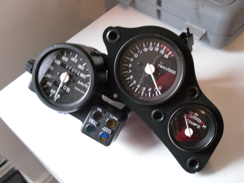

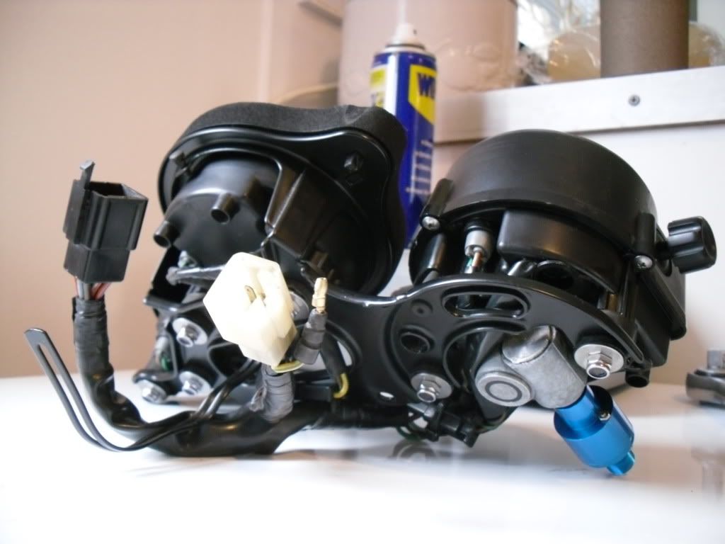

clocks have had there treatment too , all cleaned up and plonked back in there fresh powder coated brackets with new stainless allen bolts, new tape and shrink on the looms,

You did do the valve clearences before chucking the motor back in the frame didnt you, its a hell of a lot easier with the motor out the bike.
Its all looking very clean tho, good job
- Deviant400
- Posts: 769
- Location: Trowbridge
yeah tony, i did the clearences last summer , and was a pain while in the frame , she aint done many miles since so im assuming there be ok for now , cheers for the comments

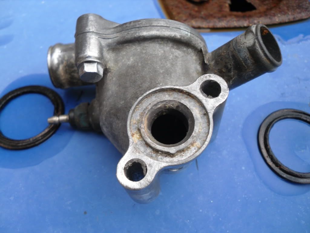

ok not done much over the last couple of days as ive been a bit hectic but cleaned up the thermostat housing today from this ...

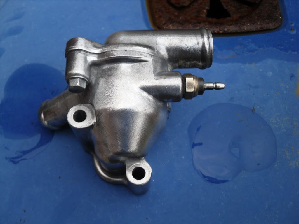

to this....

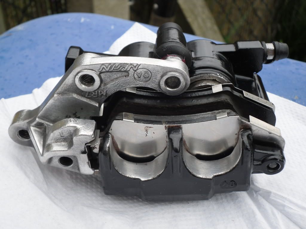

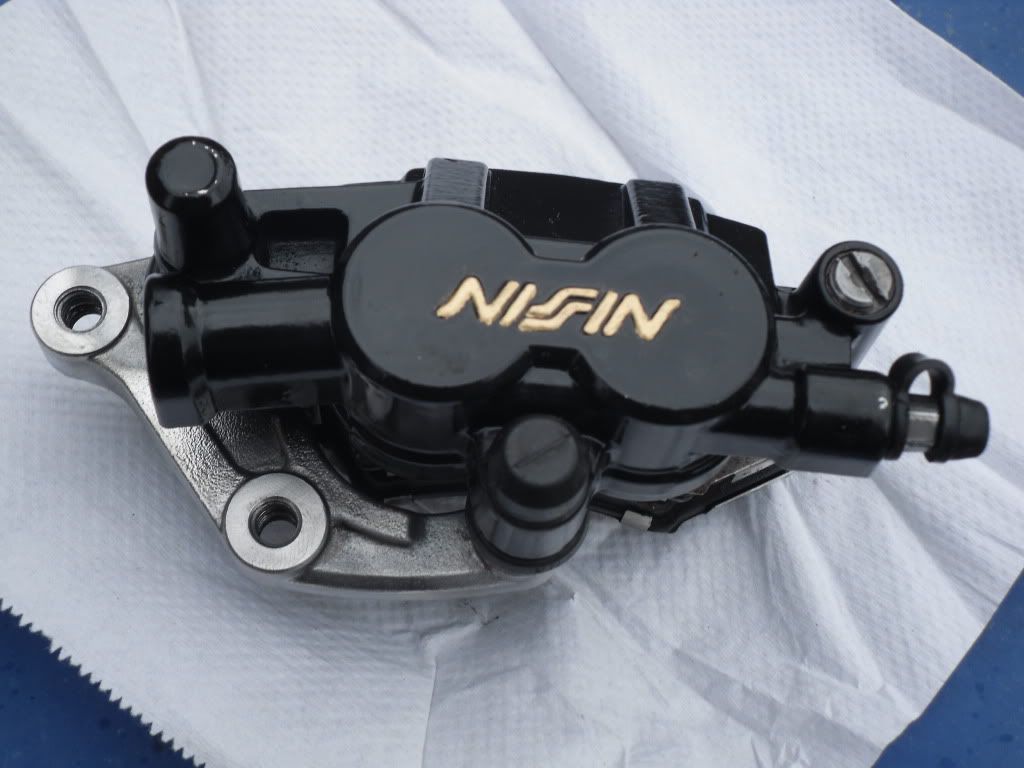

few more bits and bobs done , real caliper overhaul
also found a great little torque conversion tool as my wrench is in ft/lbs or kg and not the nm in the haynes
