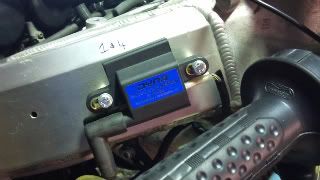

selexon wrote:Hi Yak,Yakama wrote:Do you know which coils on the dyna site you used?
http://www.dynaonline.com/skins/product ... yna_Coils/
The coils are the DC1-3 dual output 3 Ohm mini series.
Cheers for that

[quote="selexon"]Hi Tanuki the Dyna coil bodies are a little bit bigger then the oem ones but bolt up to the same diameter spacing which makes them an ease to fit. I had to make some longer alloy spacers to lift the coils from the frame 5mm or so. The coils are 3ohm not 5ohm as I quoted before. The std plug end can be kept and new HT lead was used.
The difference you get is they are a stronger spark about 40,000 volts, which leads to a better combustion and slight difference in throttle response could be felt as well.
[img]http://i38.photobucket.com/albums/e138/ ... 0278-1.jpg[/img][/quote]
Hi,
Just wondering as far as stock coils standard impedence = 20 ohms. Are this fine to use 3 Ohms ?
Hi,

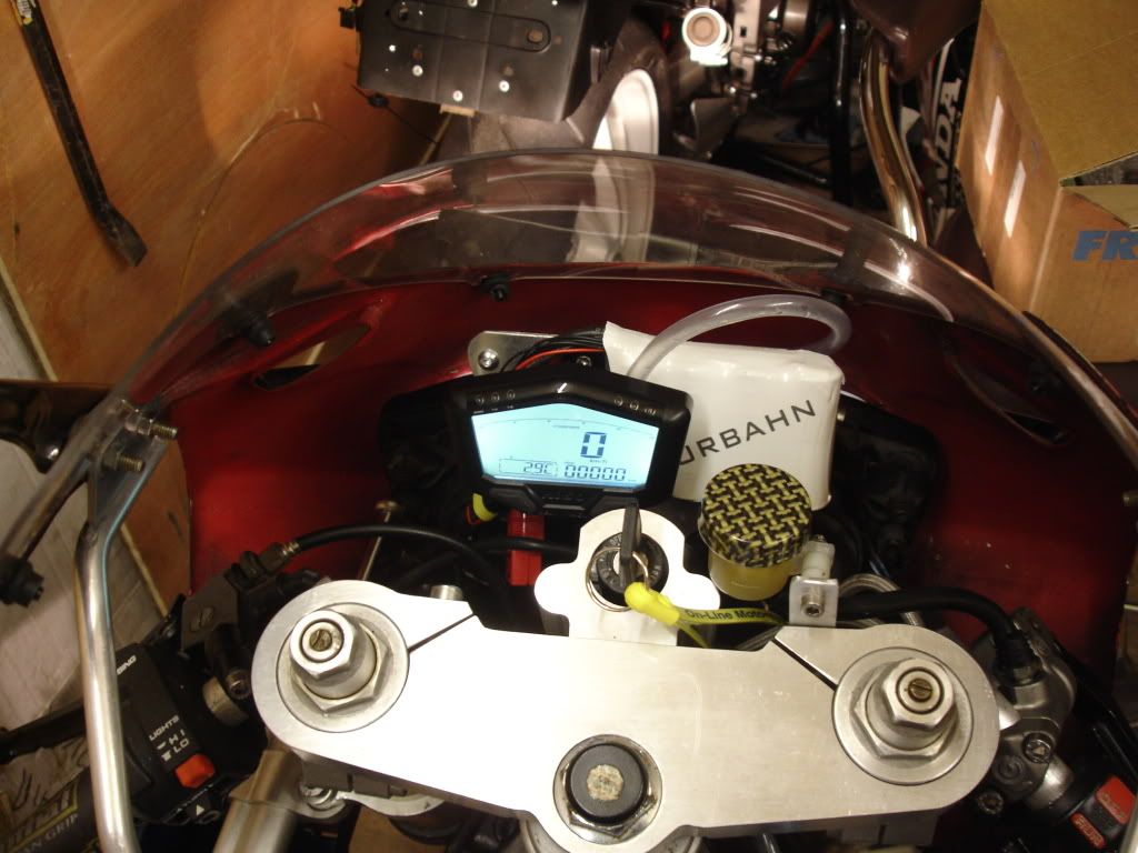

Oh and one other thing received my digi dash, but that's definatly a winter project when the bike is fully stripped.

Re: Project NC29 spangly bastard!
So the full HRC ram air setup works well then mate.
Digi dash is easier than it looks, 1 plug is +12v, +12v ign and earth. 1 is the temp, and the only other connection you need is for the tacho. Where does your current tacho read from?
its standard mate so I assume the CDI.
I really am a electrical douche...one question you had to keep your standard idiot lights (oil and neutral right)?
and the lap timer thing on it is there a switch you can buy to fit on the clip on or something?
Easy then, just connect it to the cdi. You may need to change the pulse settings or something as its a IL4. Tacho display can also be changed to 20k if you need anything above 15ktanuki wrote:its standard mate so I assume the CDI.
cool cheers.....gulp!
its definatly a winter job mate as i want to strip some of the unused crap out like the indicator circuits and tidy the whole loom up, also need to make some sort of back plate for it to mount to as well.
chuffed with it though
