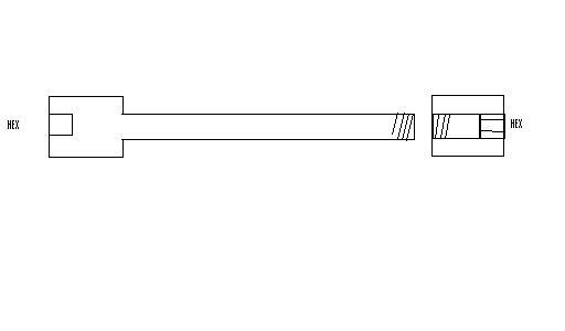

Yes thats what was concerning me to start with but i forgot to ask, im not sure i understand how a spindle can be made smaller in the middle than it is on the outsides where the fork bottoms clamp it? Can oversized bearings really open it up enough for it to work?

You just make the spindle with a screw on collar in one end, screwed on by an internal hex,
I have a similar arrangement on the rear suspension lower framemount, I can grab a pic so you can see
http://i557.photobucket.com/albums/ss12 ... MVaxle.jpg
I just did a quick mock up in ms paint, to show you the principle, hope it helps
Ronni
Ronni

Yes that does help ronni cheers, well if your contact is willing to do the work on the yokes and spindle with a little input from yourself to make sure ive got all the measurements correct that would be great. Probably wont be till winter tho, i wanna get some use out of the bike this year instead of just looking at bike in bits again.RonniB wrote:You just make the spindle with a screw on collar in one end, screwed on by an internal hex,
Ronni
