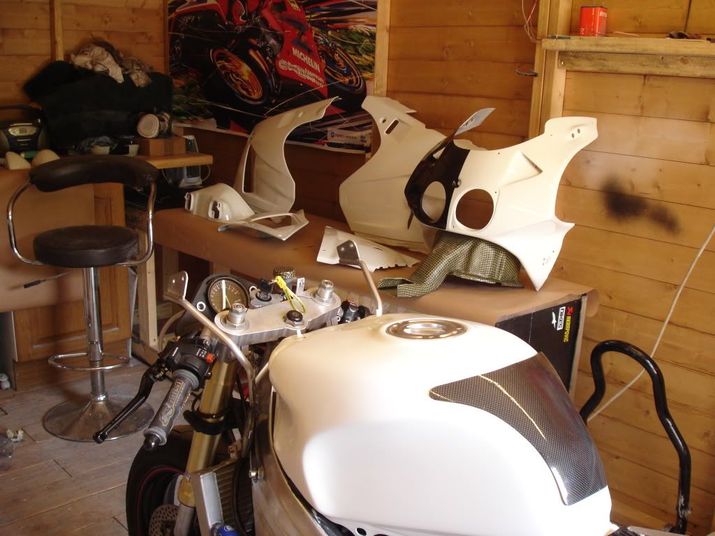

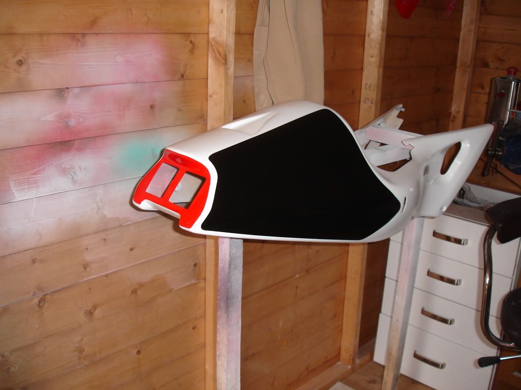

Other than that im fed up with looking at the multi coloured panels on the bike and im no closer to finding these elusive pictures of the am-pm bike i want to replicate so for now ive painted it in what i call the 2011 test bike scheme.
[img]http://i275.photobucket.com/albums/jj29 ... C04155.jpg[/img]
[img]http://i275.photobucket.com/albums/jj29 ... C04162.jpg[/img]

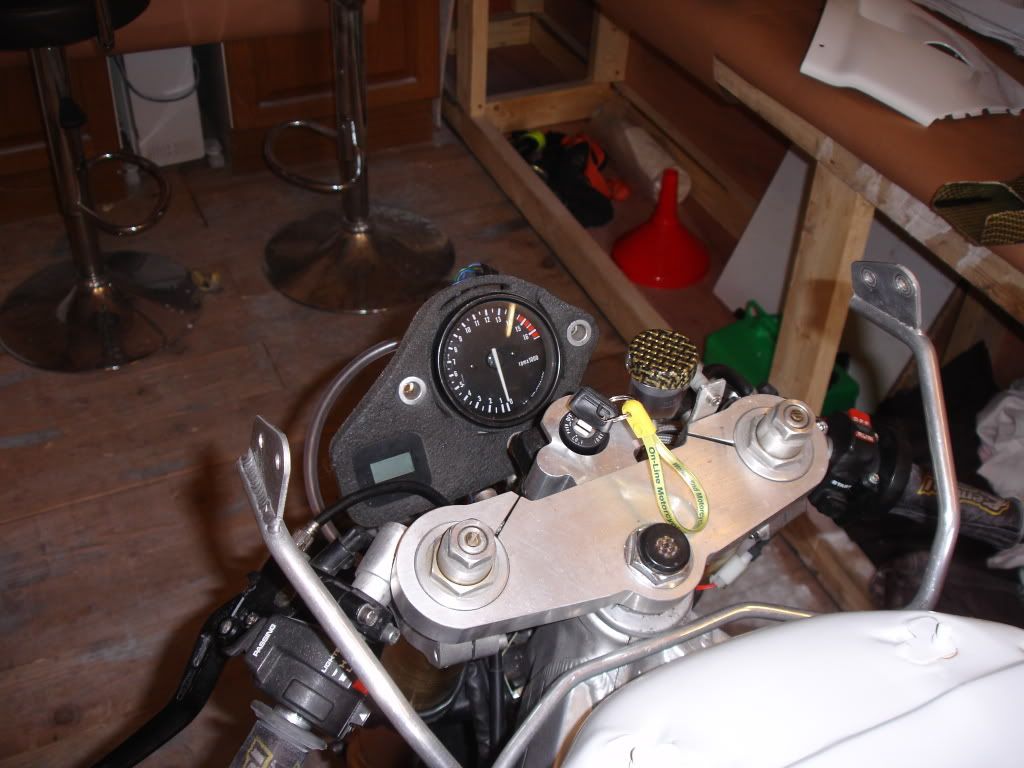

The front fender and V piece not pictured here are in black. Have also fitted a RC45 style dash
[img]http://i275.photobucket.com/albums/jj29 ... C04151.jpg[/img]
Needs a tidy up and a new foam panel made but its more authentic than that digital setup that i had. I might actually finish this bike one day

I'm guessing early MV showas, you could run almost any late-ish supersport 6 wheel/brake combo (they all run 310mm discs, like the early MV's) with the sixpiston MV Nissins and a custom axle and spacers. This is made easier if you go with custom yokes as you can accomodate whatever disc offset you need, without shimming or machining of the disc or caliper mounting faces. But I guess you want the look of a honda sixspoke which none of recent supersport bikes have.
On my bike I run 07 R6 forks and calipers with NC30 wheel and discs, made possible by custom yokes, axle and spacers (and some machining on the calipers).
I considered the MV forks, they look the business and have fairly good damping, but I think the 49mm stancions is to stiff for the NC30 chassis but your NC35 chassis have slightly better torsional stiffness, so they could/should work well. Looking forward to hearing more..

Spot on ronni, i quite fancied the bigger 58mm is it??? versions but now you've said that i think the 48's will be a better option. I was going to use custom yokes anyway or do you think i could get away with shimming the yokes i have to fit the 48's instead of the RVF's 50mm ones.
So using the 3 spoke PVM that i have already wont work then? id settle for a 3 spoke off a supersport bike for the mean time but eventually i want to source a set of 6 spoke magteks for the bike.
