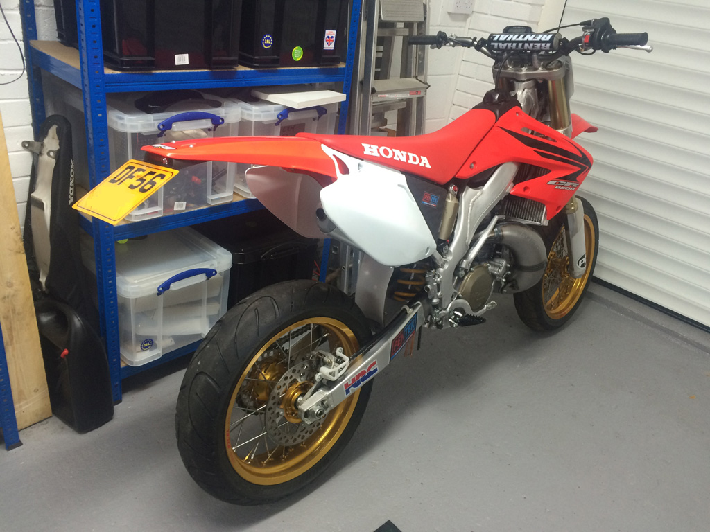

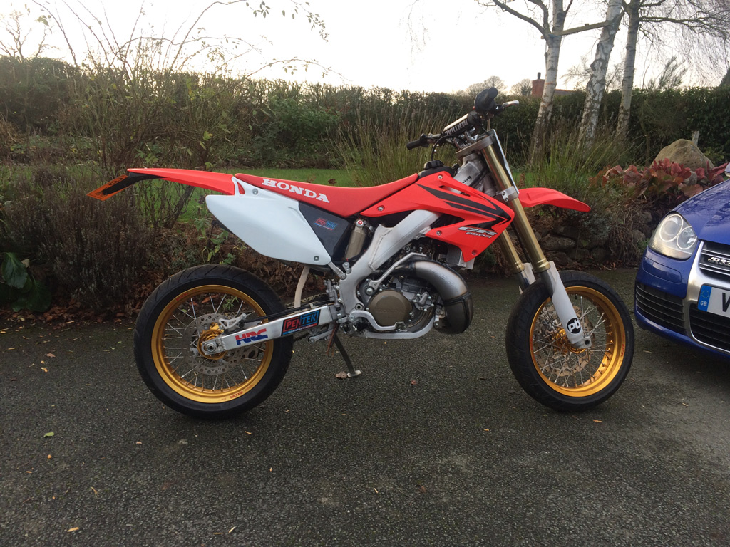

Well a bit of an update
Both bikes are now fully road legal.
The 03 bike is going to be the developed track bike. Reasons for this are simply because its a bit older and not quite as new looking as the 07. and also it makes quite a bit more power up top too. With the like for like setup, it made 52 at the wheel which is 5bhp more than the 07 series bikes. Also it handles the over rev better which i feel is more suited to being held flat out for any sustained period.
The 07 bike as shown here will get all the bling just as you see it now really, but will stay as is and be used for local road use and playing in the summer locally.
I secured another set of wheels in black which are not as nice as the gold, so coupled with some new tyres i can make 2 nearly identical spec bikes and the 03 will get the custom pipe and custom primaries
Roll on a trackday shakedown test. i can't wait to see how this puppy feels out there.
Will post pics of them both side by side once completed.

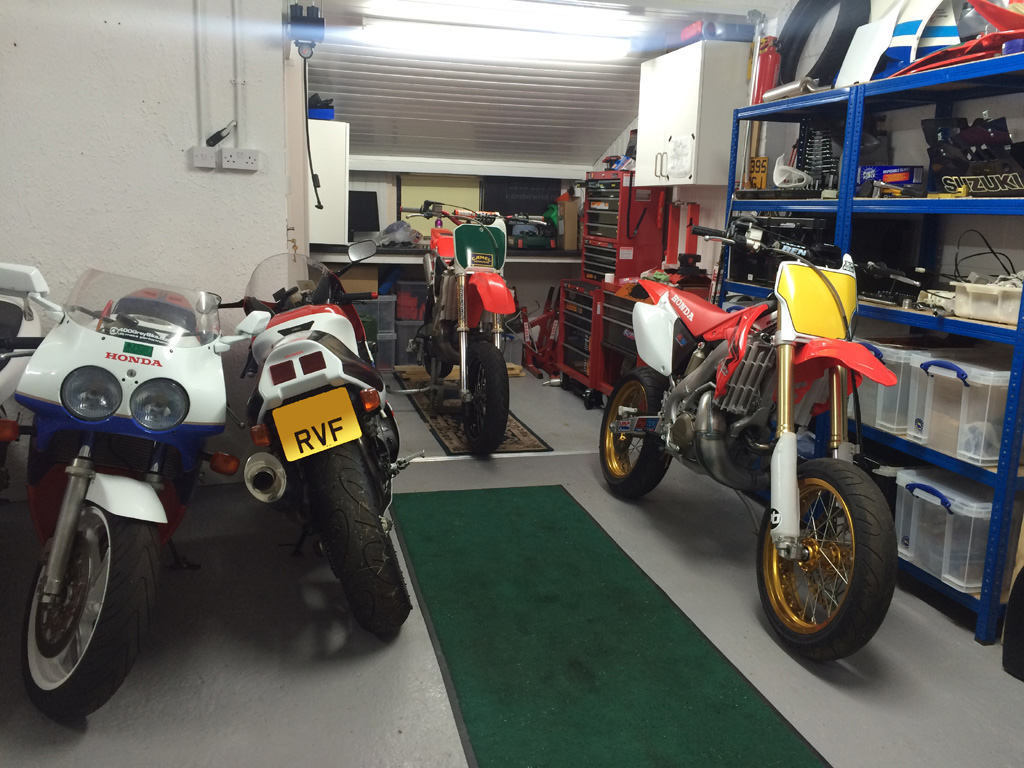

So the 07 bike is now fully built again and sat at the garage door waiting for the rain to fuck off.
The 03 bike needs some finishing like, new tyres, wheel spacers, chain and sprockets, bodykit, loom, head bearings and general fitting of everything up and taking apart, cleaning then final fit up.
Keep me occupied over the xmas break i think. Be nice to get them both out when it finally dries up and get some good pics of them.

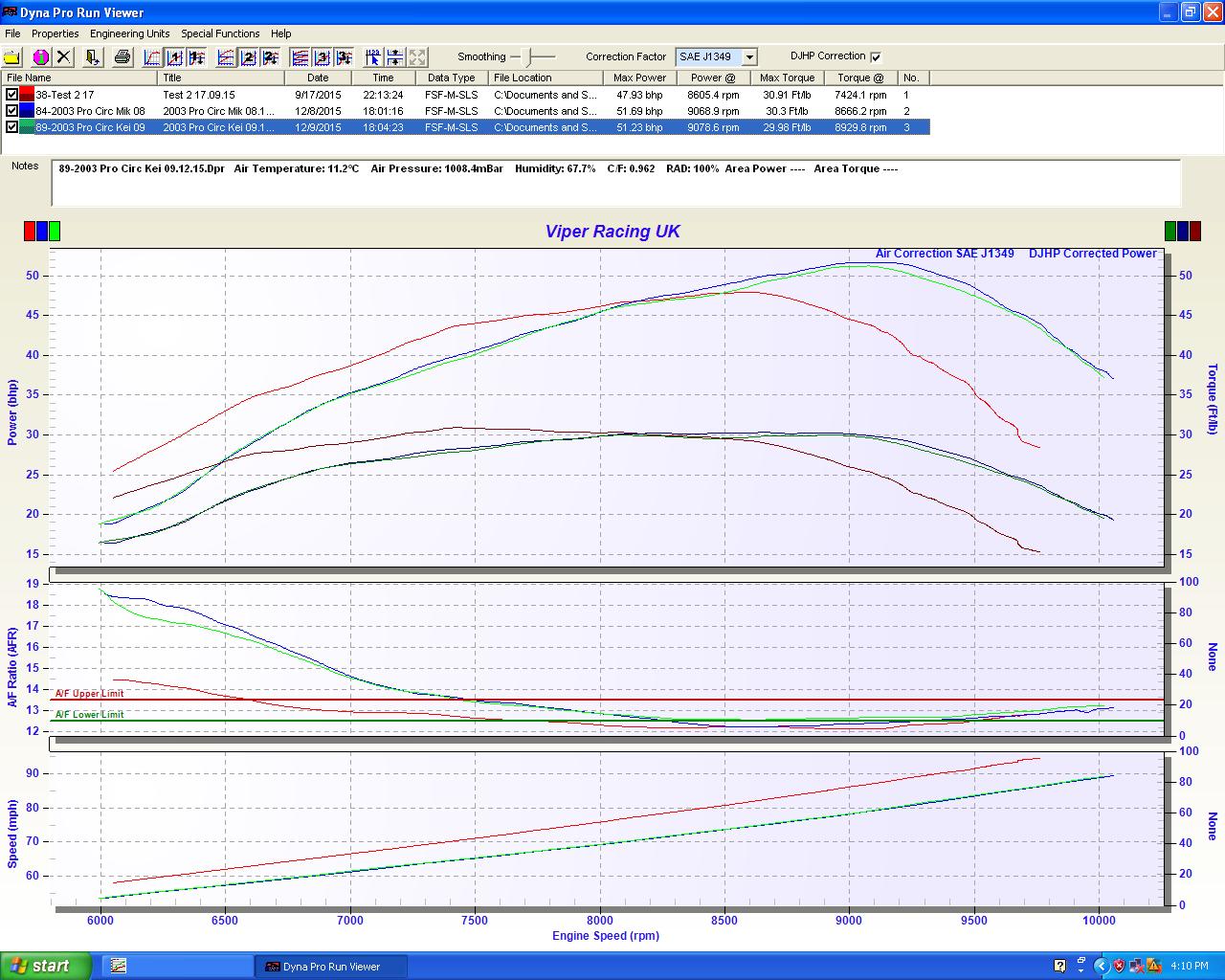

Dyno print out of the 03 bike, not bad eh for something that weighs around mid 90's kilos

ha road manners, it has no manners, its uncivilized and down right violent
Re: Project A&E / OCD
Shit the bed mate ive just seen that dyno chart, what does it weigh?
Edit: ill read it properly next time. Thats feather light, must be lively to say the least
