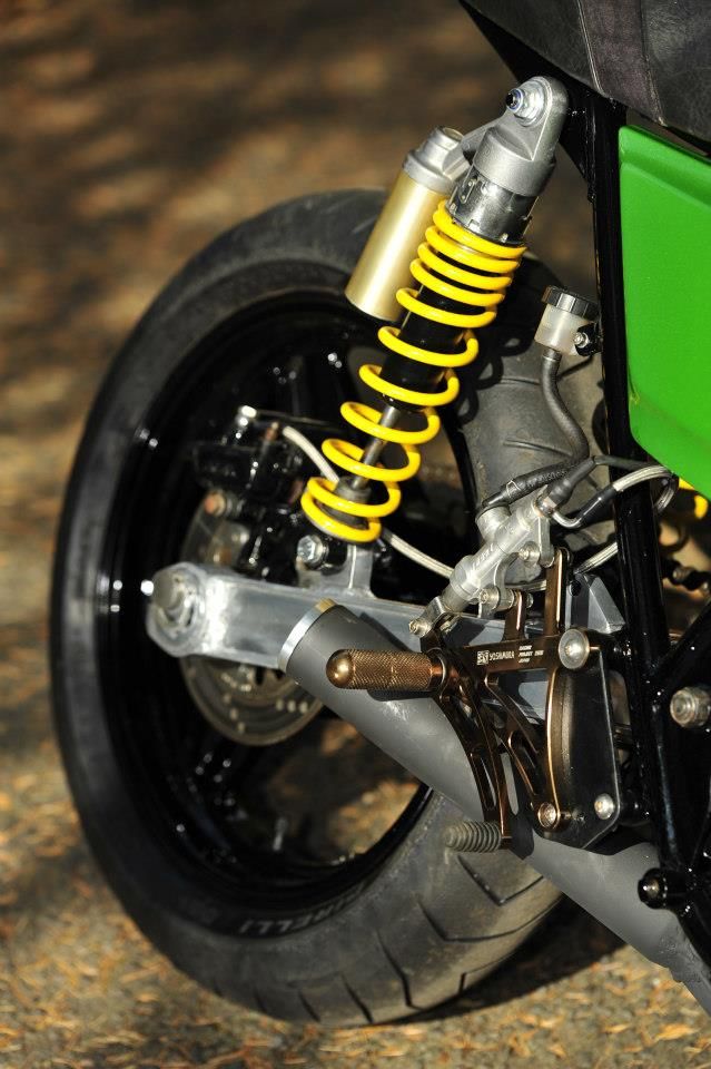

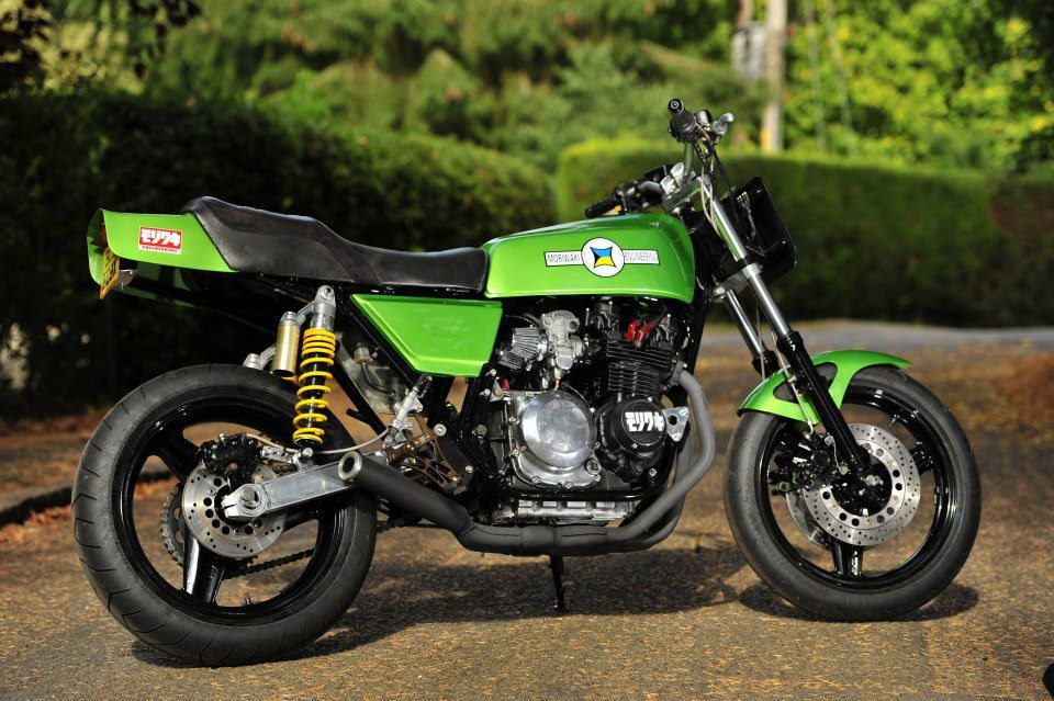

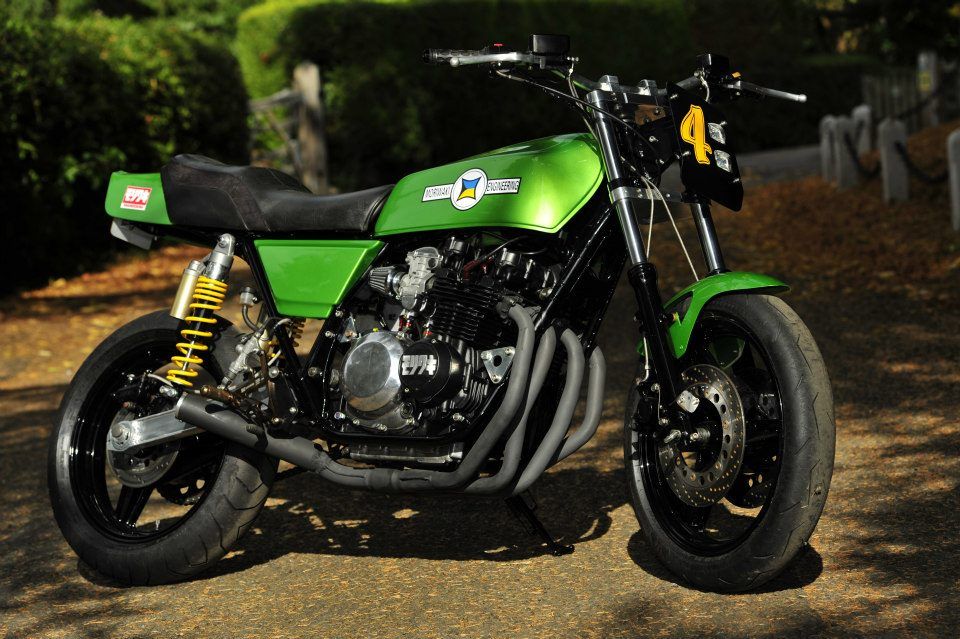

A bit of digging on the tinternet and ive found some old sites relating to the bike and found some rather nice pics and more details as to what bits from other bikes are fitted.
Gpz 750 Unitrack forks (anti dive blanked off)
CBR600 3 spoke front wheel and brakes
GPZ750 Unitrack swinging arm converted to twin shock
CBR600 rear wheel and brake
I always thought the brakes were GPZ750 which might be why i keep mismatching master cylinders
