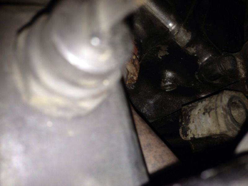

Has anyone had one of the cylinder coolant drain bolts shear on them? Mine went like chocolate today, it went tight on the way out so I used loads of spray and slowly worked it back in but eventually it snapped on me. Hopefully it won't leak but as its a steel m6 bolt and ally cast then even dobbing a weld over it is out of the question. No access at all for easy outs. Sounds terrible but maybe a smear of high temp silicone or liquid metal might do the trick. It's obviously pretty tight in there now.

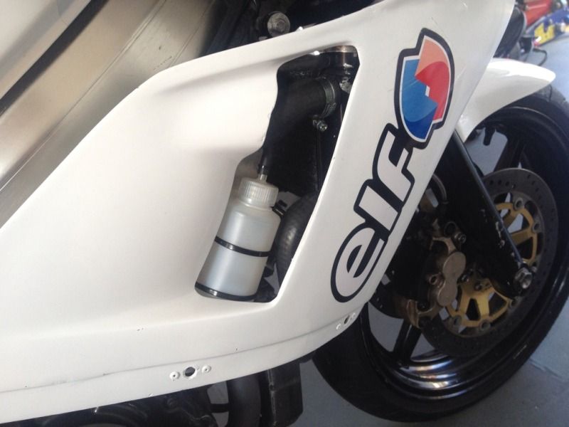

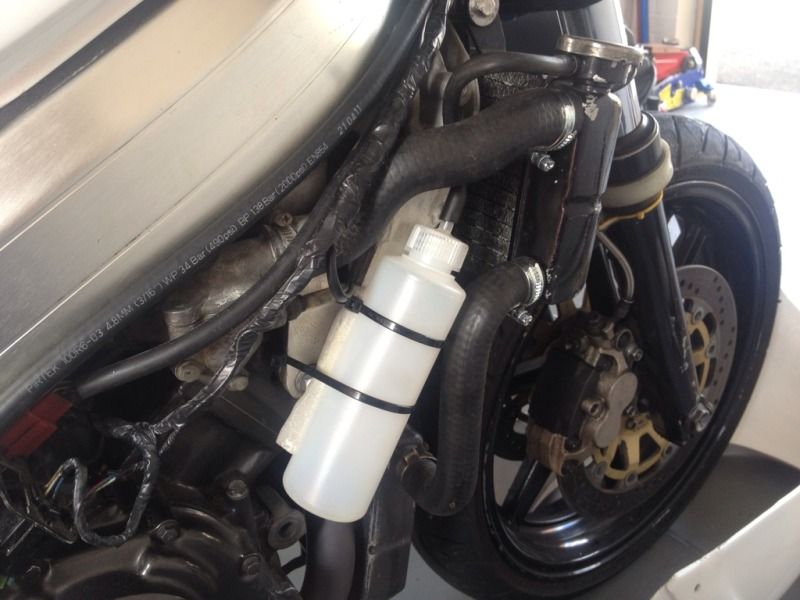

Put some of the body work back on made a coolant overflow bottle.
