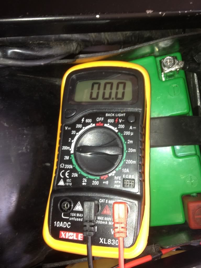

So I got back into the garage, I started testing from the battery lead to the frame in series, and couldn't get any current readings at all, no matter what way round I had the leads on my mulitmeter or which current setting I had it on.
But I did get some readings when my multimeter was set up like this :
The voltage readings fluctuated from 4-10 volts constantly rising and falling slowly.
I then bumped into the starter solenoid?
And this somehow when nudged or moved about triggered and turned off the alarm, so I took a further look and noticed that the two wires leading away from it had screws holding them down that were not tightened properly so I tightened them up.
After tightening the nuts up I took the readings again, but had the change the scale on the multimeter, with the leads still in the same sockets I turned the dial to 20 on the white scale and it read 13.2.
Then I tried again to get some current readings, I changed the red (positive) lead on my multimeter to the 10ADC hole and switched the dial to 200m Amps. It read - 49.9.
