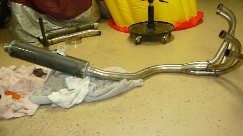

The rebuild continues. I scored a set of pipes off Yahoo Japan. They are an early Yamamoto design. I know you guys said they weren't the best but the price was too good to pass up ($250!). Welds sure look nice to an amateur like me. I gave them a good cleaning and they look damn near new. Muffler is tweaked but I have a buddy who wants to cut it and shorten it and change the mount. If it doesn't work out I'll get something more modern but I like the old style look. It is just aluminum with a carbon wrap.

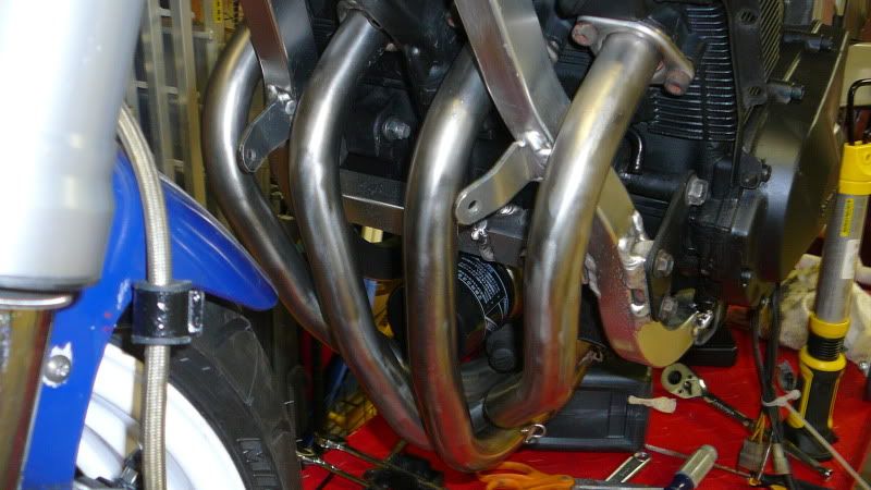

Is this what you guys mean by Yamamoto's not fitting properly or I am missing something here? I'm using the crush gaskets in the manifold. If I don't, the pipes don't seem to seat properly and you can rock the pipes back and fourth a bit.

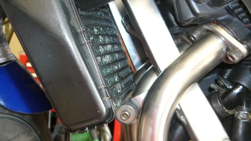

The inner two pipes sit right on the radiator.

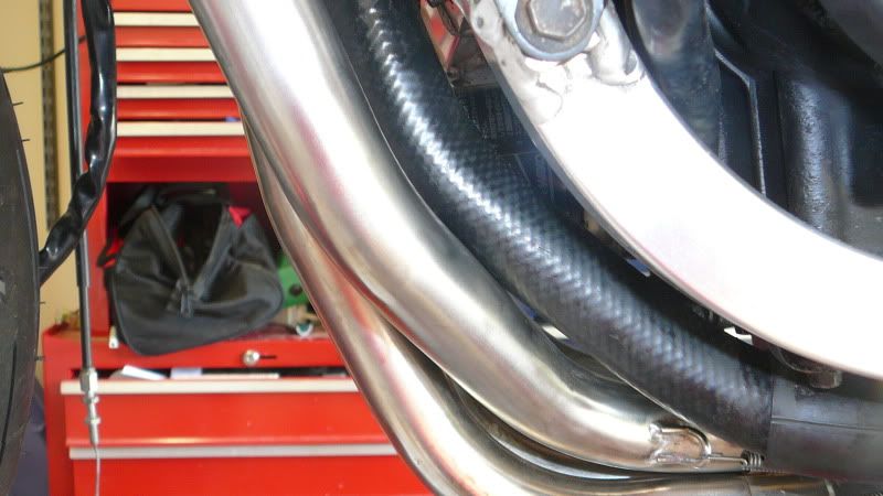

Lower rad hose sits right on the pipe.

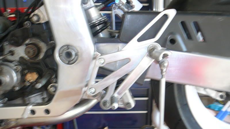

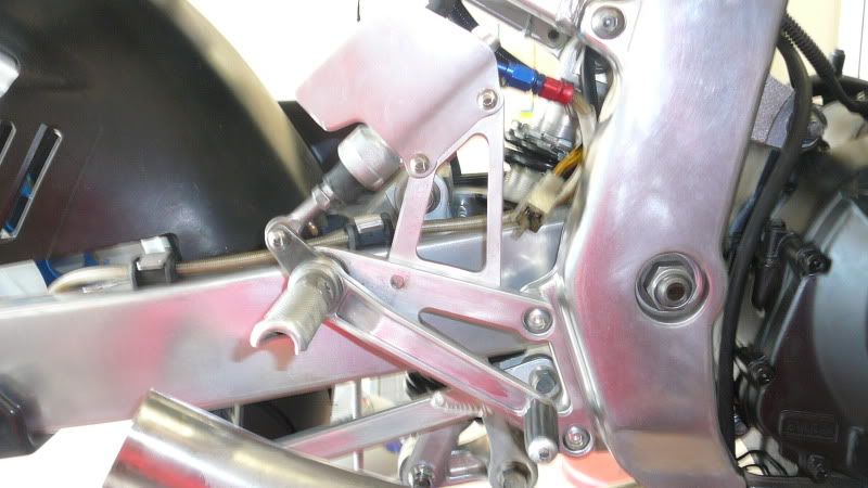

On a brighter note the rear sets I picked up from someone on the forum cleaned up nicely.
