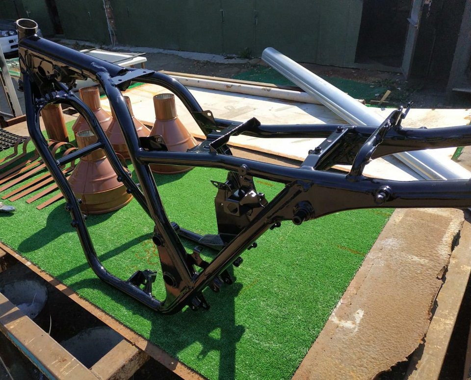

My beloved 1993 production year NC31 became some kind of a "project" for me last year.
I've teared it down to a single bolt.
First things first. So I completely repainted the frame, rims, forks etc - sanding plus powder coating
The front rim - original 3" NC31, the rear one - 5" NC42 for ABS rotor
The front rim was also slightly modified for installation of front ABS rotor.
NC42 swingarm was also installed - it took some time to machine some parts, it won't fit by itself.
Fuel tank, fenders was painted in Kandy Apple Red
Side covers were made from scratch with carbon fiber.
The seat was altered and gel-pad was added
Engine was fitted with tunable EFI on original NC42 throttle bodies. CBR1000RR COPs etc
The work is in progress at the moment
And some items for next year
