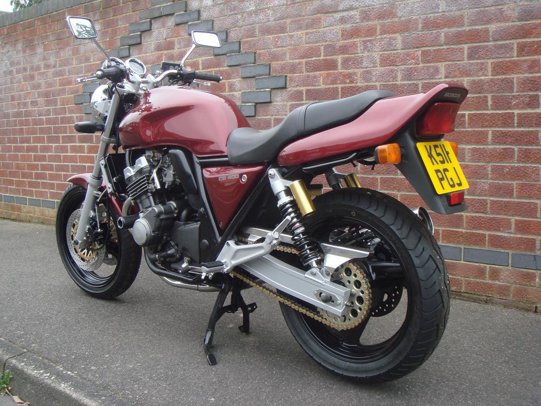

The red bike runs! I put the fuel tank from the yellow bike on it, filled it with coolant, fitted a new battery and it fired and ran first attempt. I rode it up and down the road until it died.
Here'a a list of faults and what I think their solutions might be:
- can't find neutral. new clutch cable
- front right indicator lit with headlight - change the wires I've obviously connected it wrongly!
- one rear light bulb inoperative - change both bulbs, may as well while in there
- exhaust blowing from cylinder head join - fit new copper gaskets, they have arrived already
- won't idle without choke - strip and clean carb needles and float bowls, probably gummed up
- speedo needle doesn't work - find replacement clocks (?)
- front brakes spongy - try another master cylinder repair kit
Any suggestions welcome with regards that list!

Carb cleaning, ultra sonic works wonders but before trying one removing diaphragms and any fibre washers is a good idea
