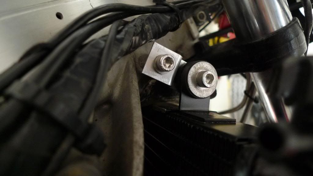

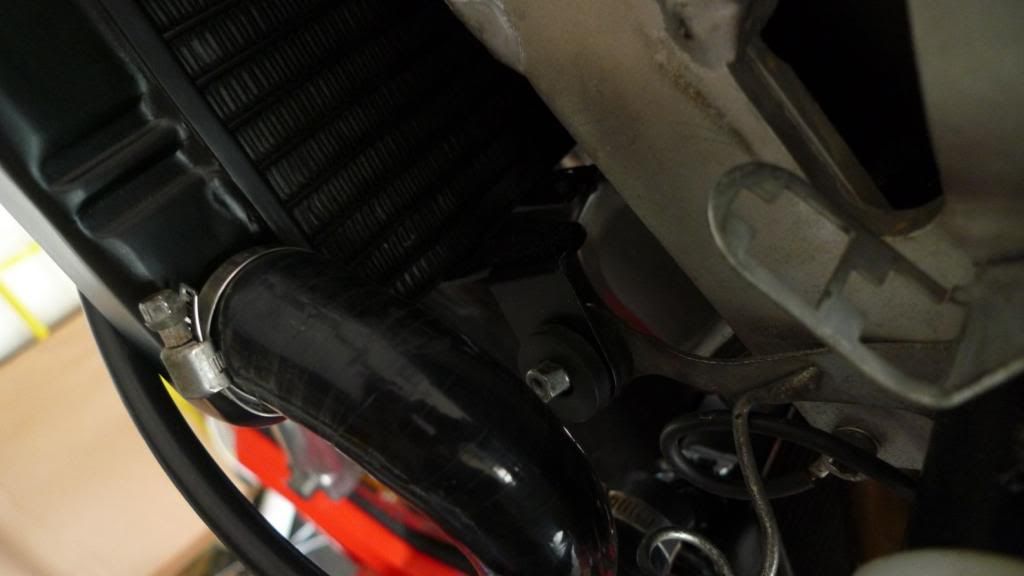

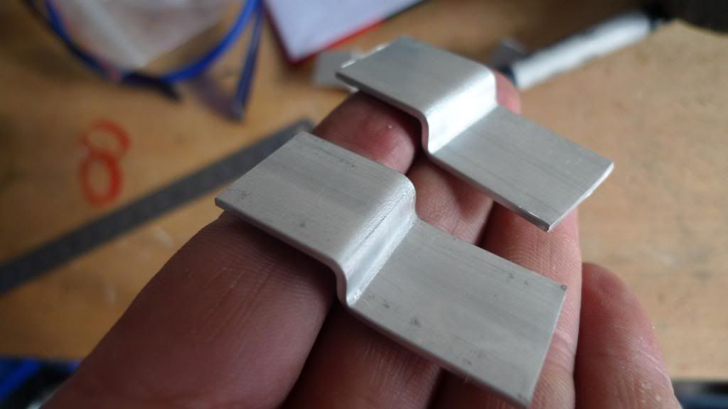

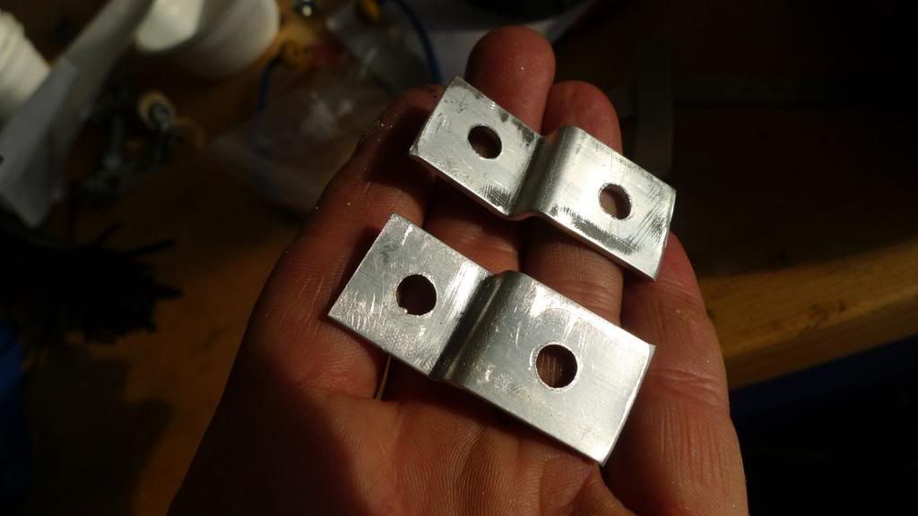

Let's get these radiators mounted properly then. Not so interested in making them beautiful for now, there are larger fish to fry, so my tin-snip engineering 'skills' come out again:
Not pretty, but it fits and things are held firm:
And the lower mount fits too, it didn't fit too well with the GPI upper rad:

Are the hoses you're using those Chinese silicon ones? I can't justify spending $160-170 on Samco hoses and was wondering about the Chinese knock-offs.
StrayAlien
- Posts: 361
- Location: Melbourne, Straya
Yep, I got the hoses from GPI. Pretty cheap, they fit, and I've no complaints so far.

Just had a thought, you checked fork to rad clearance lock to lock? Mine were close without having to move the rad like you have.
