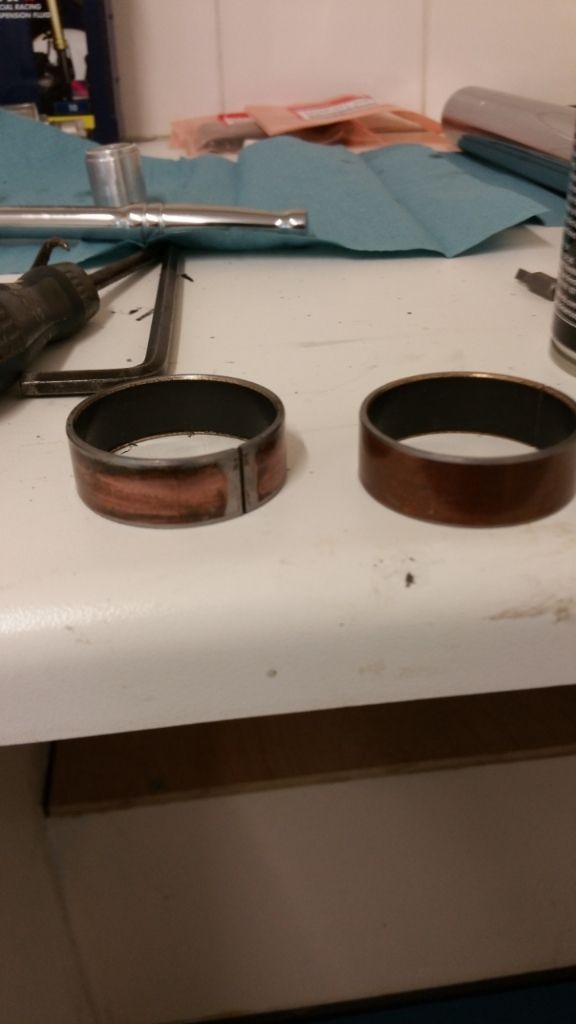

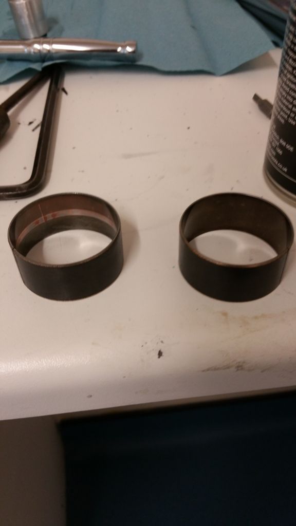

The oil was all grey and metallic and minging, more proof they needed doing....
The bushes were quite worn but I was going to replace them anyway along with the seals and oil.

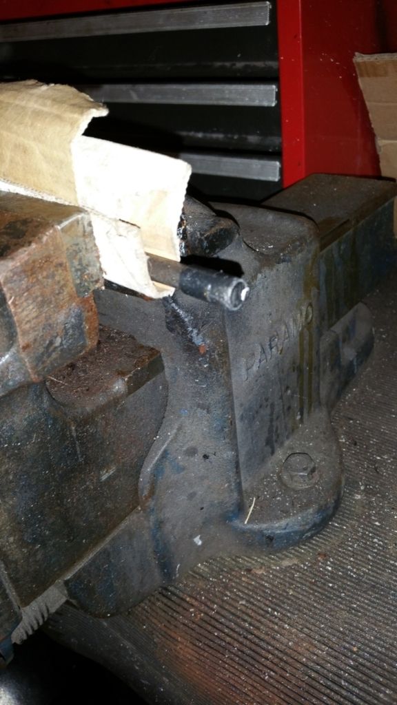

So back to using the pillar drill again....
I unbolted one of the vices from the bench and just about made it work under the drill.
All drilled out I pulled some of the thread spiral from the nipple out but had to tap the rest.
Next job was to shorten the VFR750 clutch push rod I had to 339mm as per the clutch conversion thread.

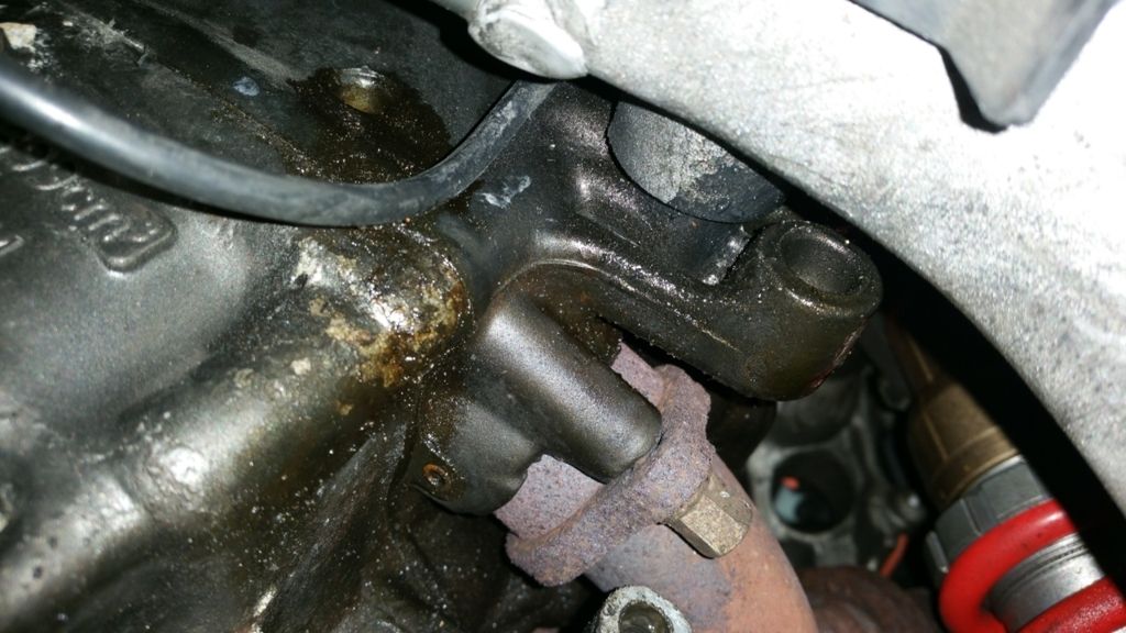

When I first wheeled the bike around the club garage to get it onto the ramp I noticed it had been leaking a small amount of oil on the floor over Christmas, bummer. On investigation it looks like the waterpump seal has gone and is very slowly leaking.
It also looks like the rear cam cover gasket is leaking a bit too, so I'll whip that off and inspect it. Hopefully it just needs re-seating.

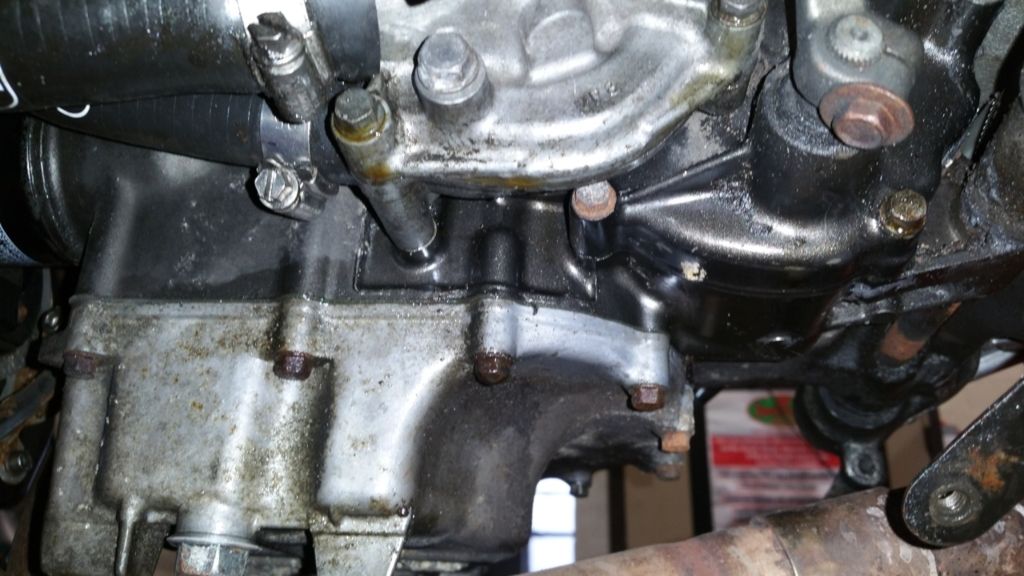

Next was to change that leaking water pump seal. Off with the sprocket cover, drain the cooling system and out with the water pump.
I got the pump body into the parts washer as it was fairly grubby and then had a good look at the seal, which as you can see was pretty buggered. Flattened, brittle and hard. Not what you want an oil seal to be!
So off with that manky seal it was, and on with a nice flexible fresh new one. Plus a new pump cover seal too.
Back in with the pump and I finally realised after 4 years of ownership.... that there was a bolt missing on the waterpump not allowing it to be properly held into the engine.
So in went a nice shiny stainless bolt with some of my new favourite graphite grease on the end of the threads.
