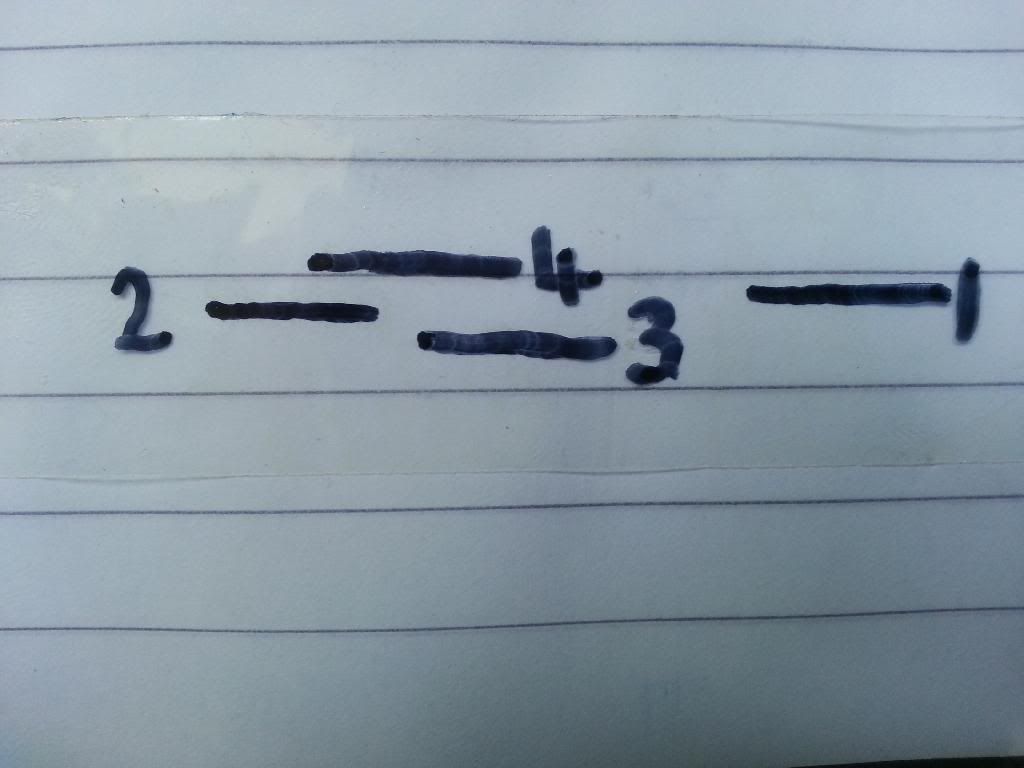

Drained float bowls into a half pint glass and marked the levels on some tape I stuck to the glass. See picture below:
arsey30
- Posts: 1218
- Bike owned: ftr223 650 bros
- Location: Surrey
Re: NC30 running on 3.
If 2 and 4 work, so should number 1.
Number 3 is low, [the faulty one] but difficult to say how much, what capacity difference is there between them.

RC, not sure about the difference prob 15ml from top to bottom.
