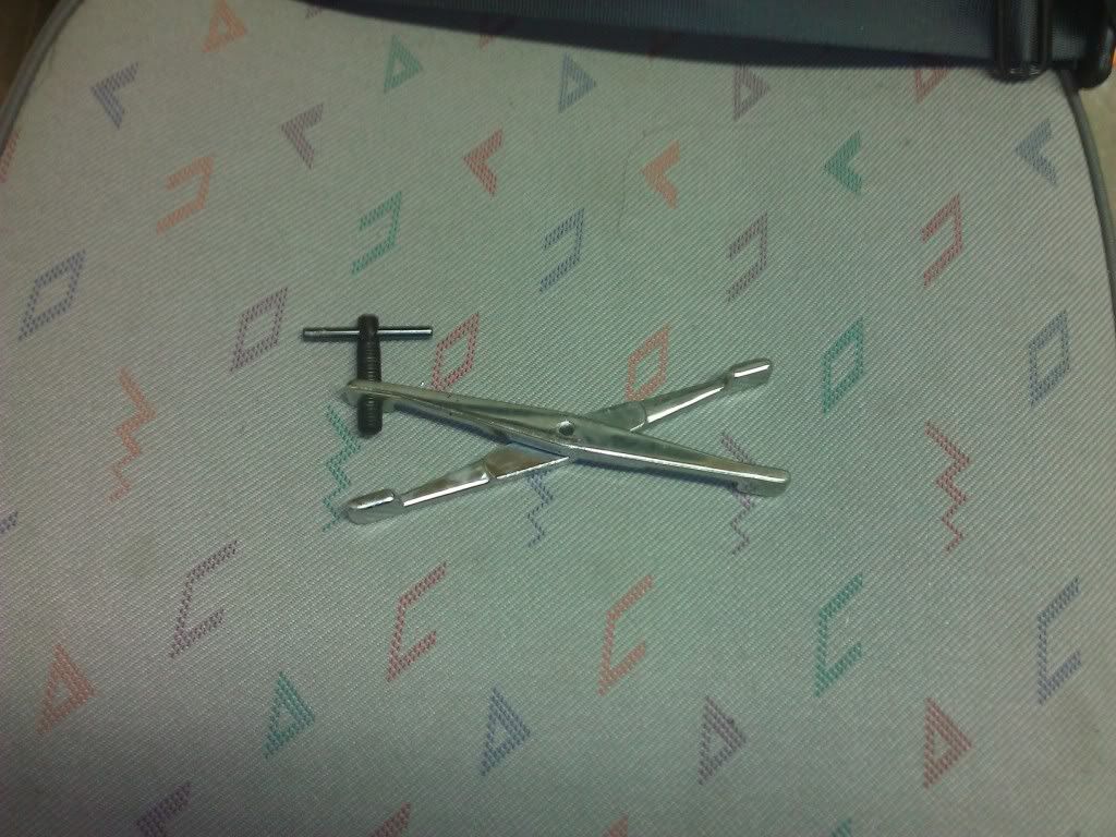

Something like these?Drunkn Munky wrote:Ive got got one thats not meant to be a piston removing tool but it does the same job and was dead cheap off ebay. I couldnt even tell you what its meant to be but i'll grab a picture of it later, looks a but like a pair of scissors with blunt ends that go inside the piston then you wind them out till it grips. Ive never had a piston defeat me yet and ive overhauled some rotters with em.

Here you go
Dont ask me what its called tho

That looks like a Munky fuker to me! LOL.
Seriously...how do you use it to pull a caliper piston?
