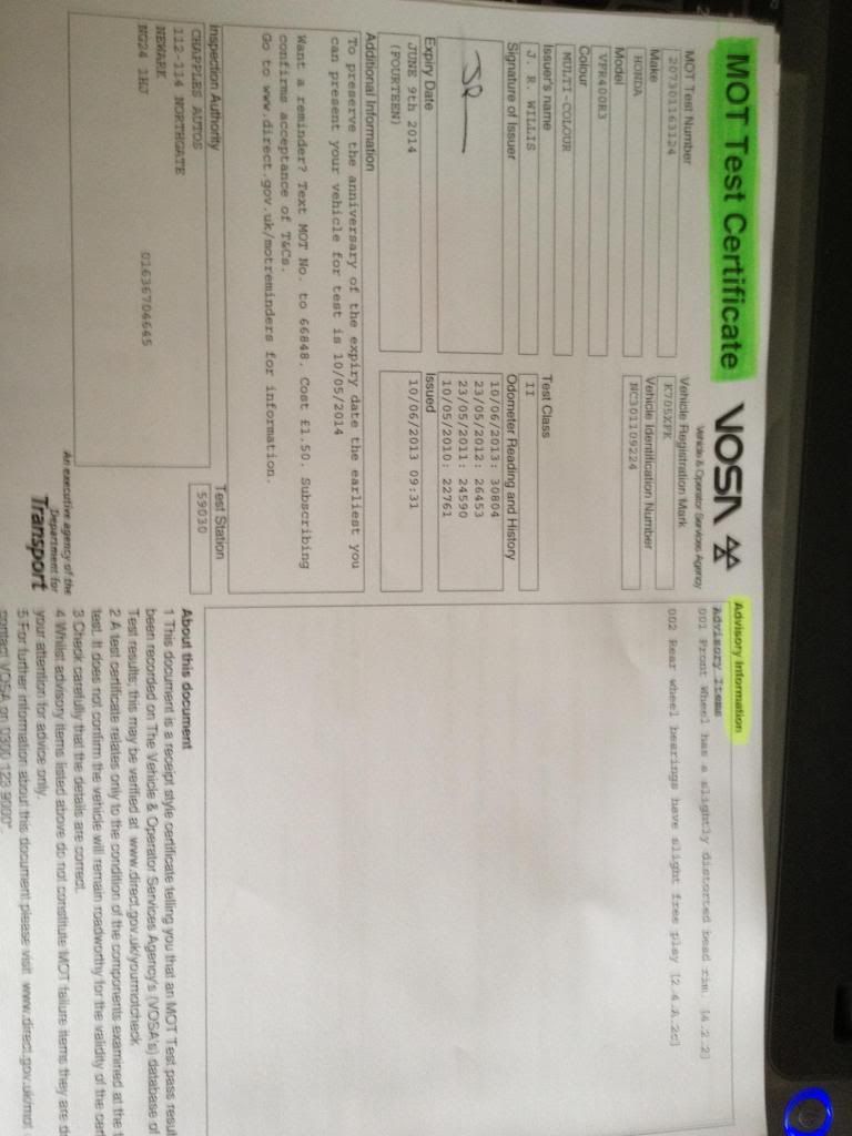

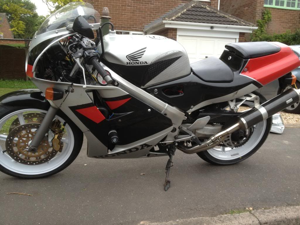

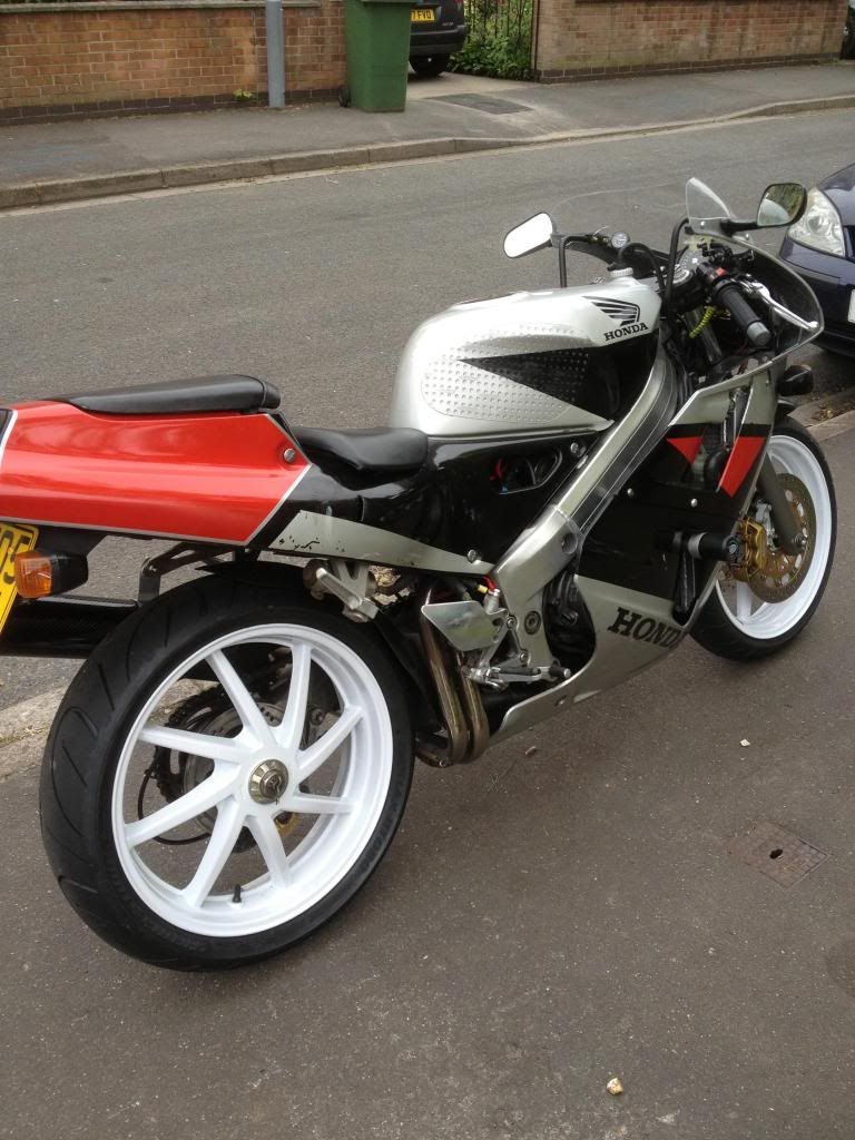

MOT PASSED
The rear wheel bearings are wiggling a bit, I asked the tester to show me.
The front wheel bead is obviously something I cannot ever escape as it's a different front wheel....
Then I went out on the busy bypass to start scrubbing the tyres in. The difference in grip is amazing.
My old mis-matched tyres really were shit. The new forks with Rick O's kit has transformed the front end, so much smoother and I finally have full confidence in the front end. Just the rear still feels a bit vague with the shitty original shock on there still....

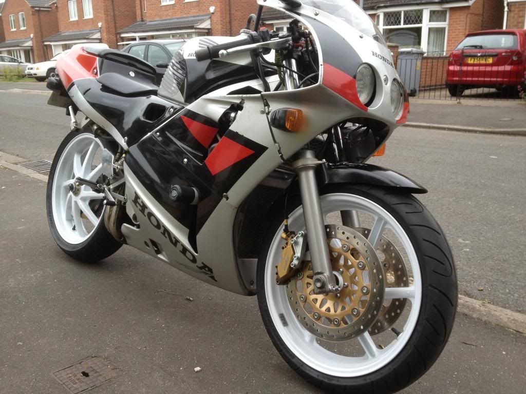

Looks really nice. There's something sweet about freshly powdered white wheels on an NC isn't there.

Yeah classic coatings did an awesome job, cannot fault it whatsoever, looks fecking awesome

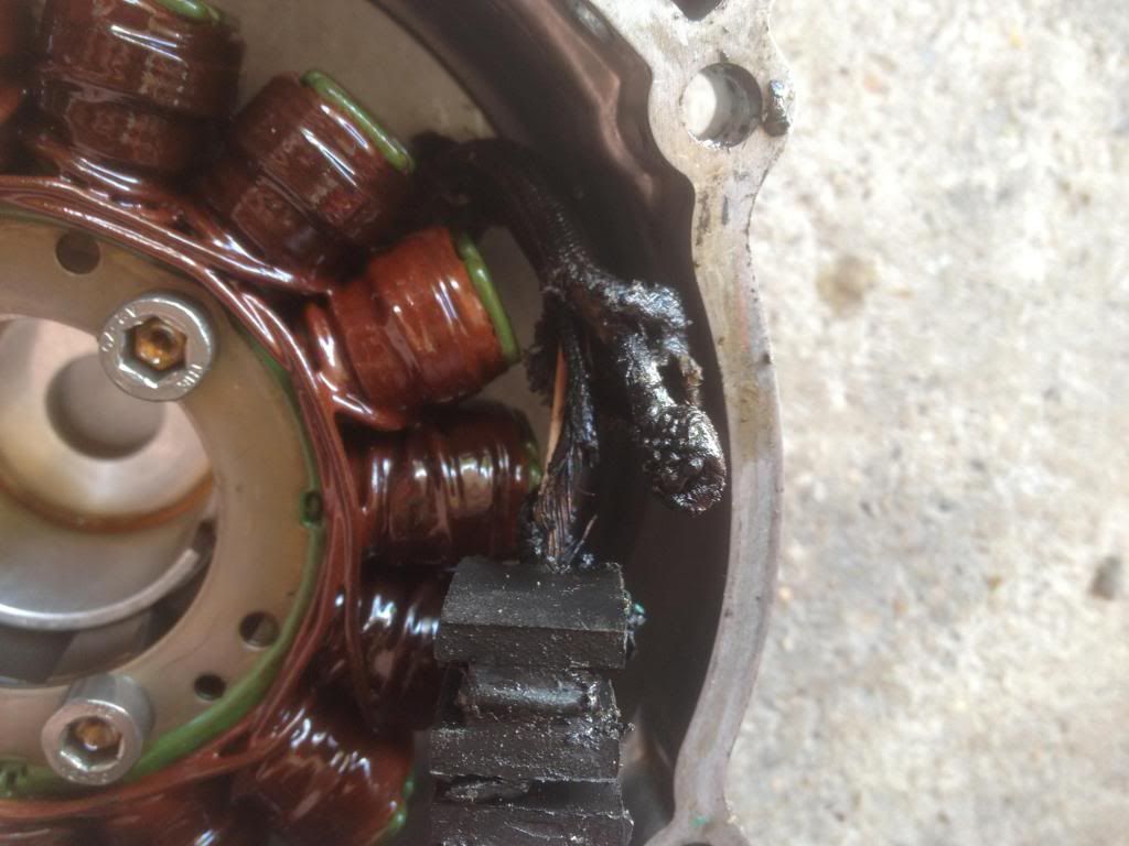

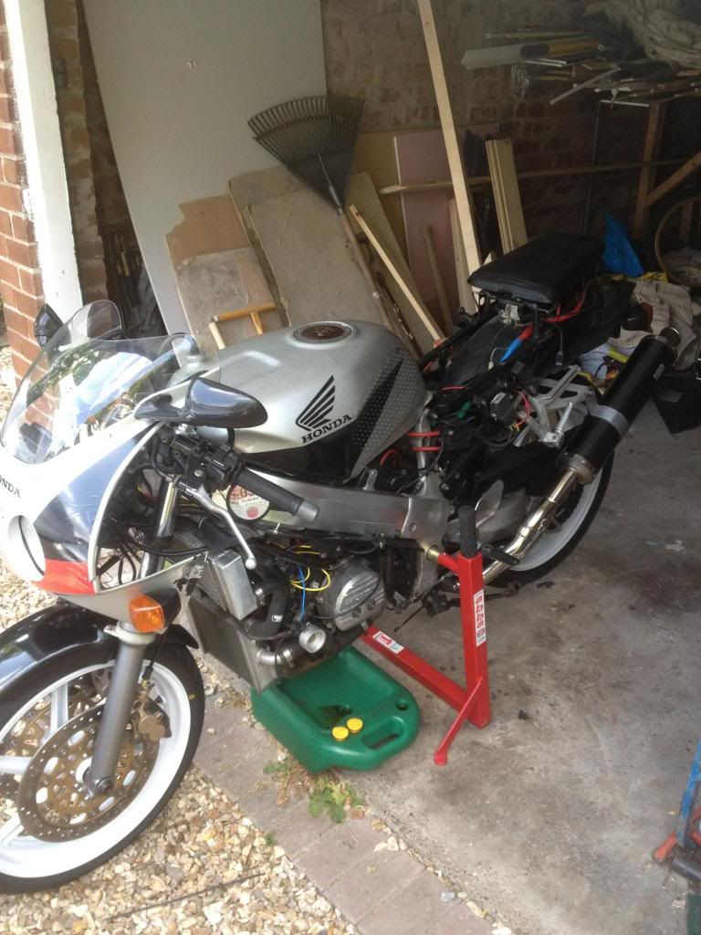

So available time to work on the bike is now a lot longer due to it having an electrical mis-hap just coming off the A1 a week ago tonight, then me finally forking out for a car I don't really want but know I need.....

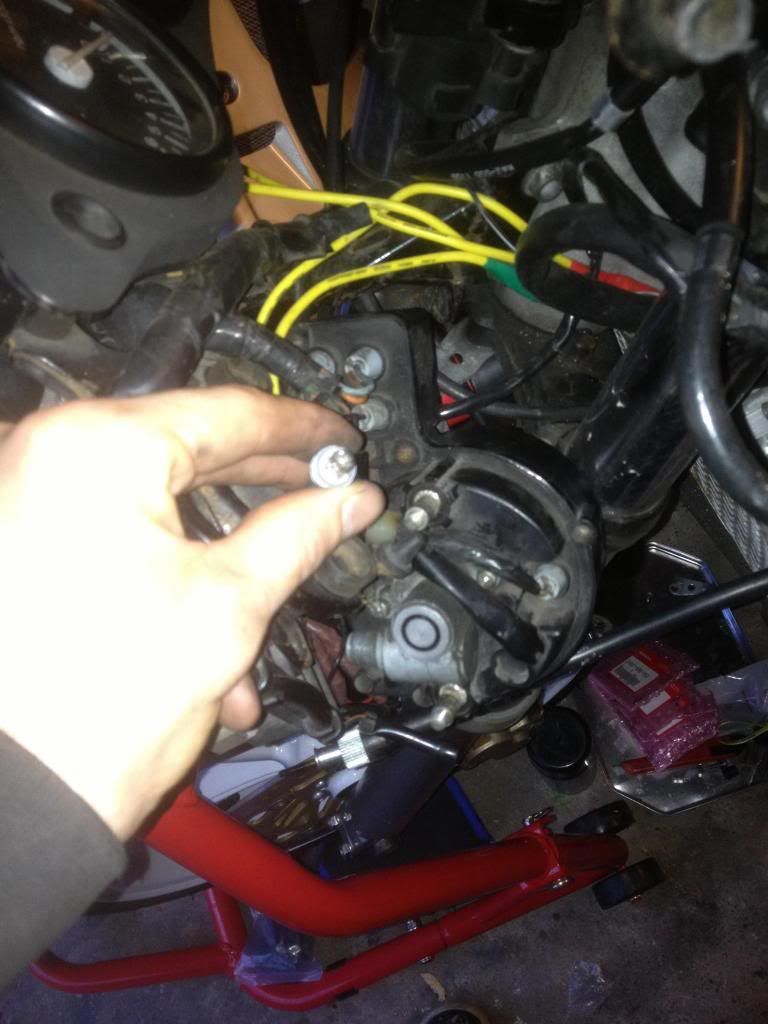

Anyway, electric mis-hap turned out to be the generator wires had been slowly cut by the rotor because they had slipped from behind the metal bracket keeping them from harm causing this mess.
Got all that cleaned up and re-wired, ordered a new gasket and fitted it back on tonight.

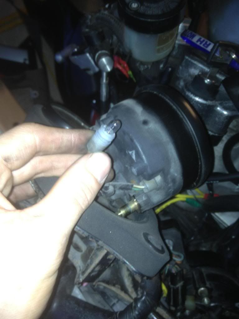

Also ordered a new sidestand rubber as mine made a bid for freedom in Louth while at Cadwell, 6 speedo bulbs (3 for spares) as I could hardly see my speedo at night and the tacho was dim too, 3 more oil filters and got a new seat lock from MattUKNC to replace the one that buggered off whilst riding to work. Matt also sent me the retaining clip thing that I didn't have before so thanks for that Matt, your a star!
That's better.

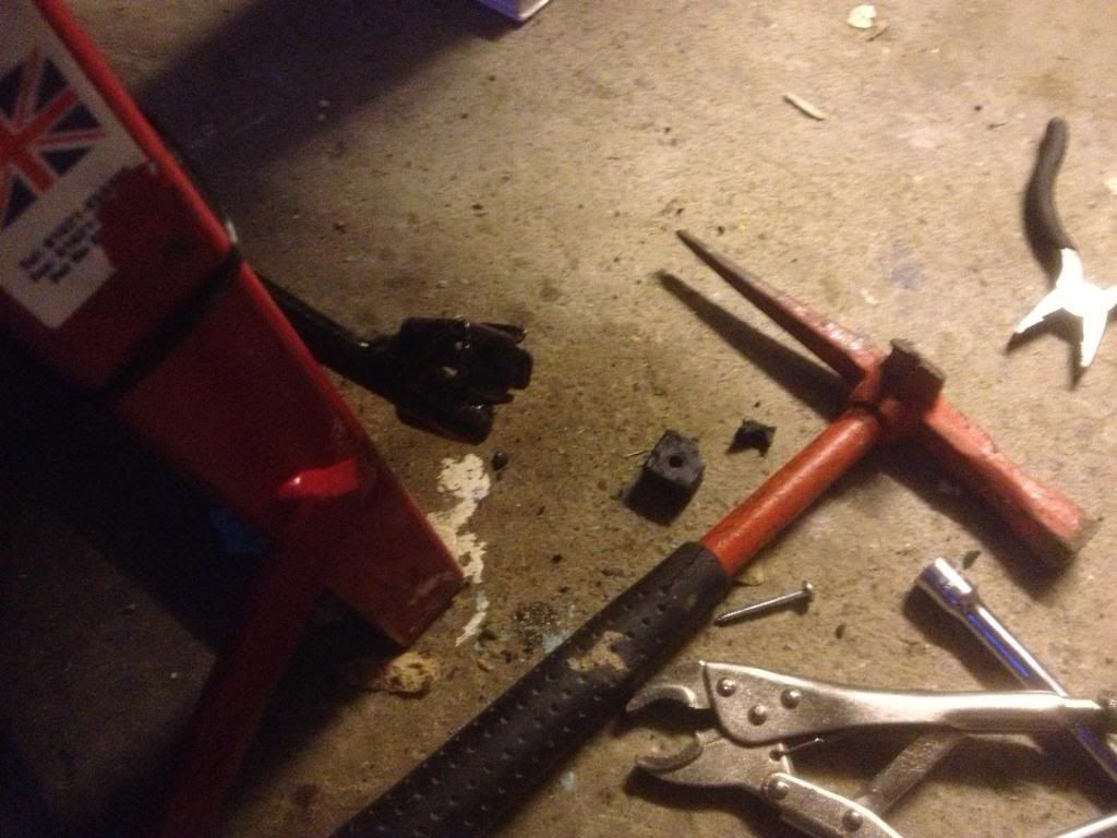

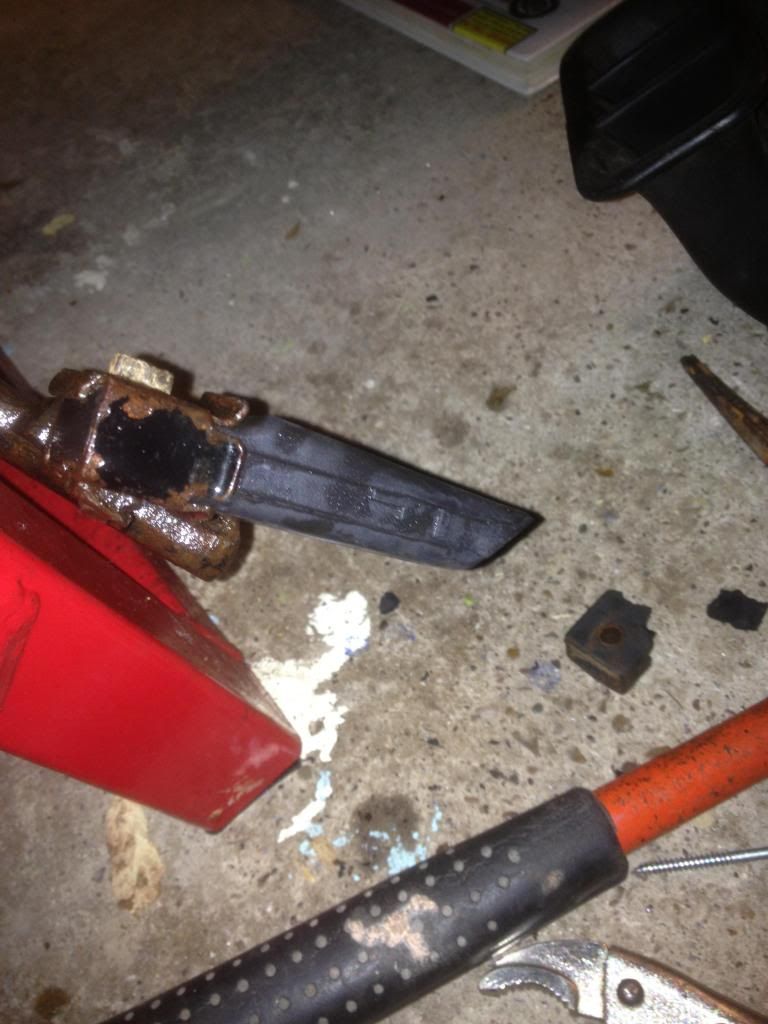

Had to hammer the shit out of the old sidestand rubber to get it out, took bloody ages and had to zip-tie the sidestand to the abba stand.
Also had to re-position my exhaust, as after dropping the bike in Cadwell's carpark the sidestand was hitting it again....
Bike is now back to usual work duties for days where it's above 5 degrees C and not lagging it down! Plus the good weekend blasts for when I'm not riding BMX.
That's better.

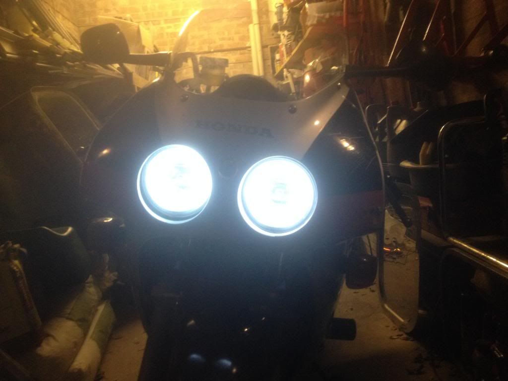

Another thing I haven't posted up either was that I changed the LED angel eyes to some CCFL rings as the LED ones were melted by my high beam, whoops. The CCFL are glass and have no plastic so hopefully they hold up well. Again, pictures to follow later.

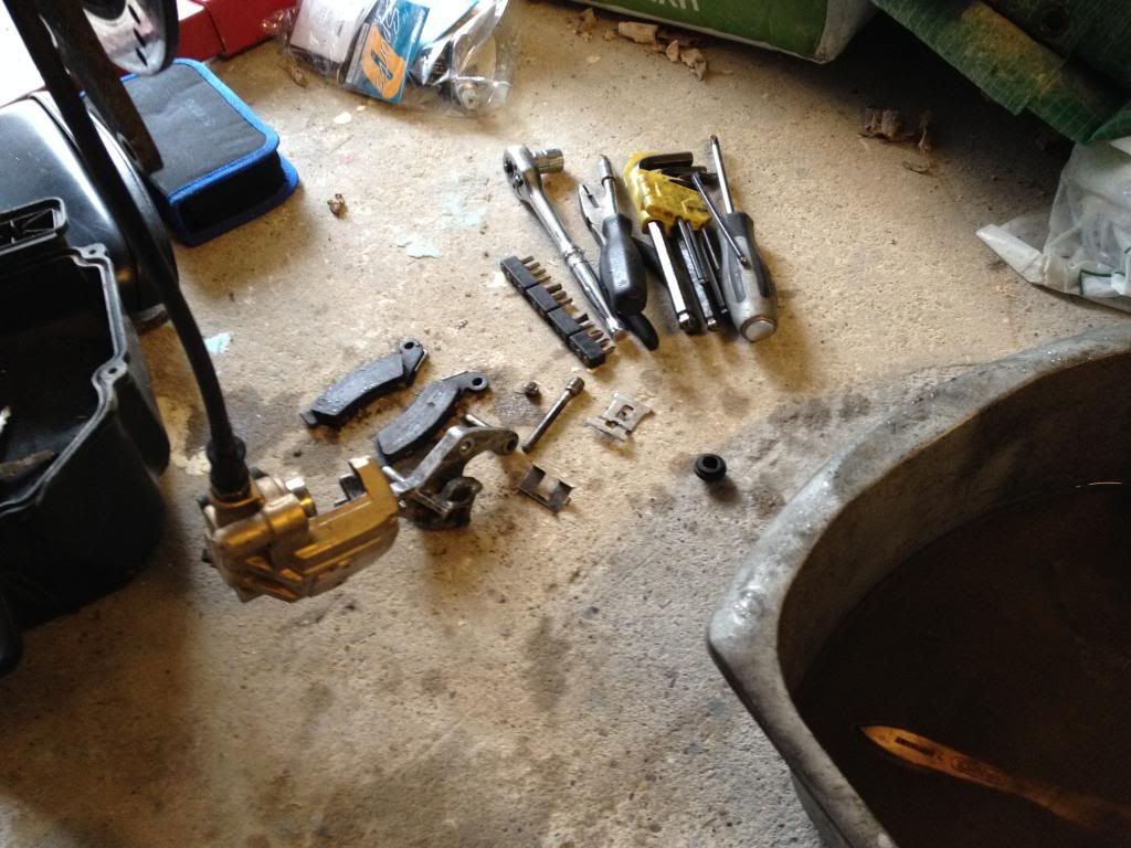

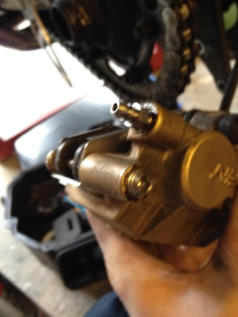

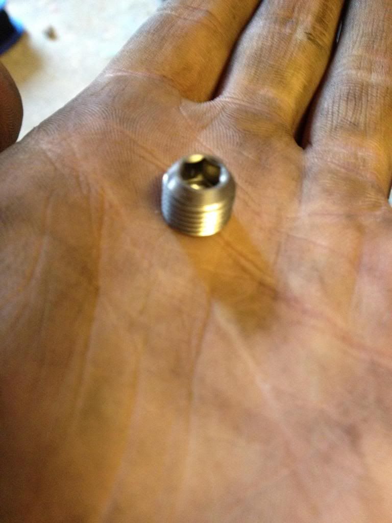

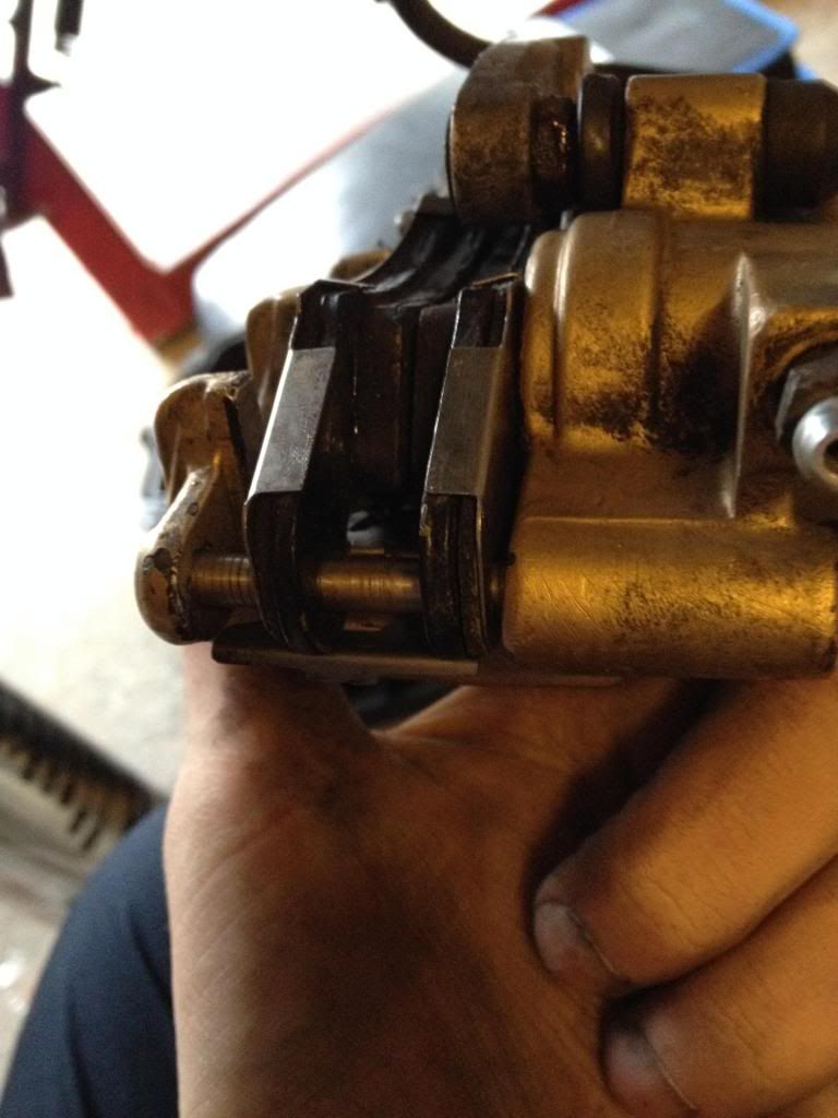

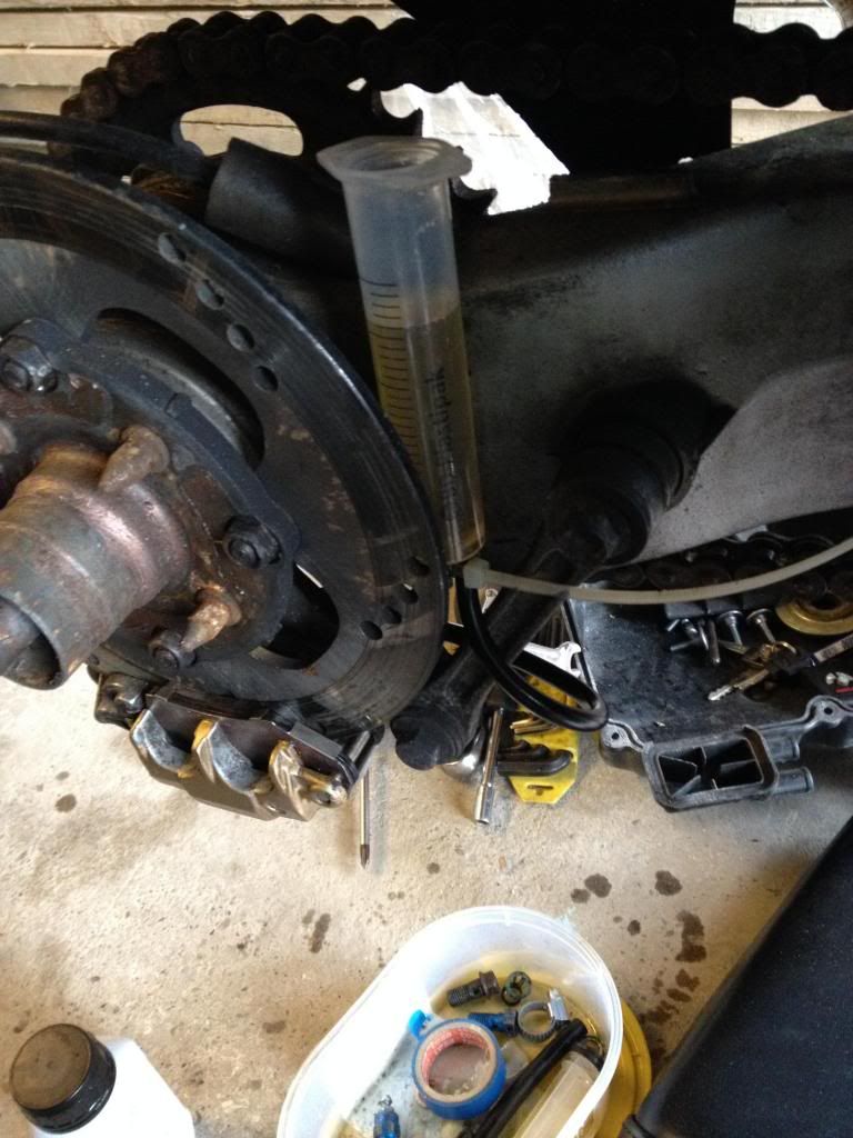

First off was to give the rear brake a good clean and swap the pad pin and bleed nipple for stainless items
Filthy it was. Then just a quick bleed after swapping the nipples over.

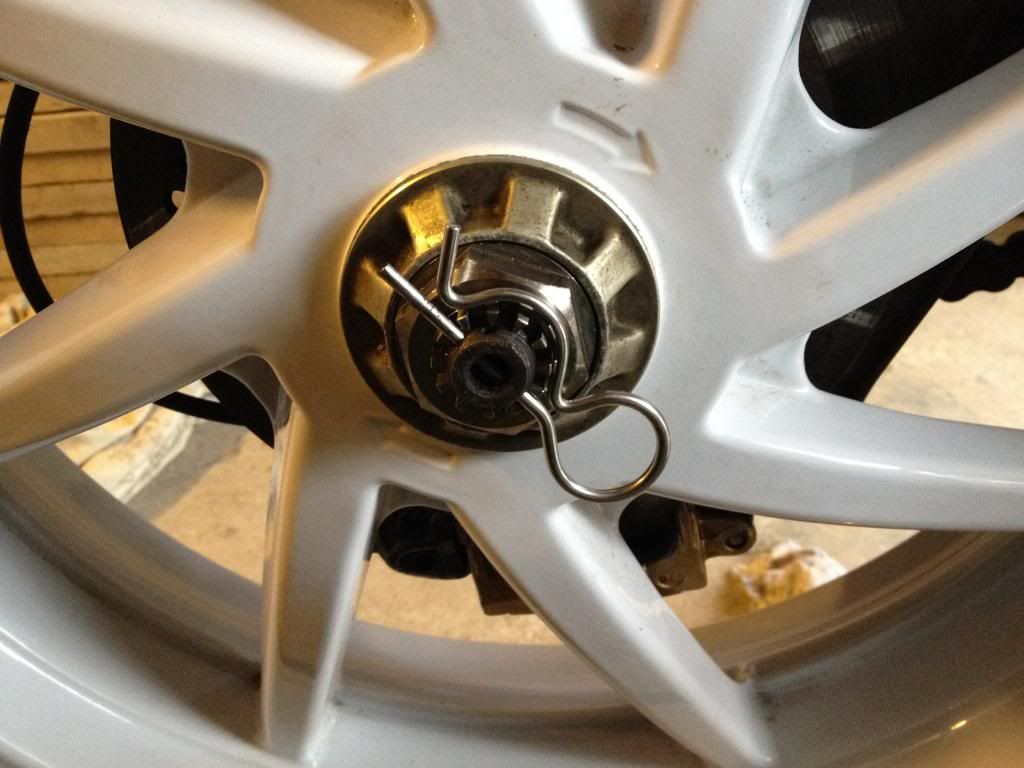

Then back on with the rear wheel and a fancy new POSH R-clip

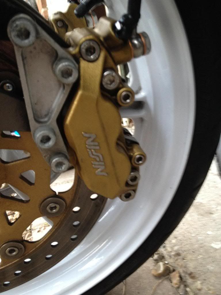

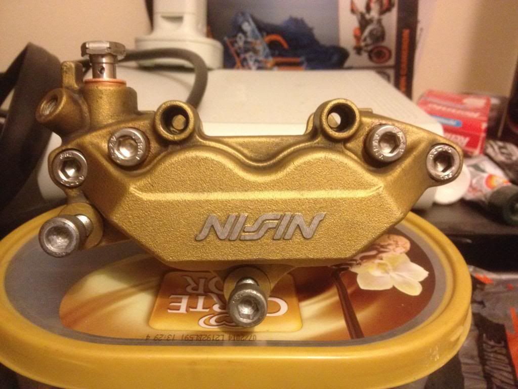

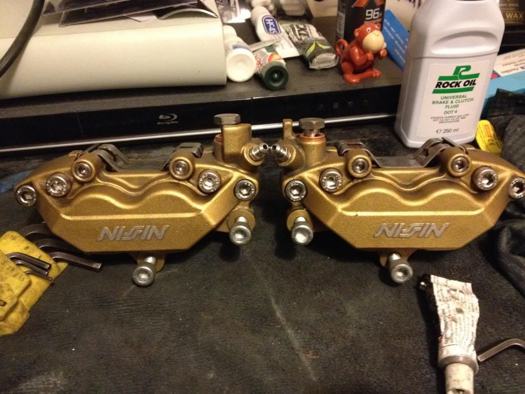

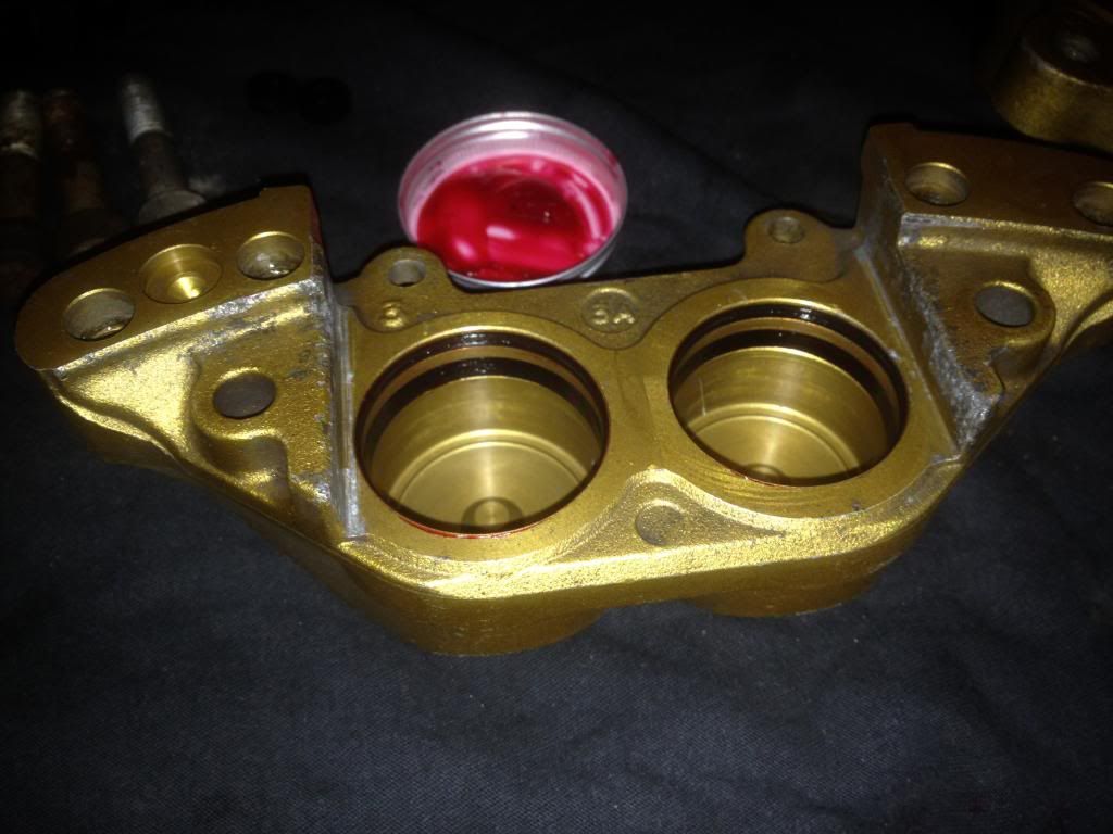

I mentioned yesterday that I had been tinkering with my front brakes, so here's what I've been doing.

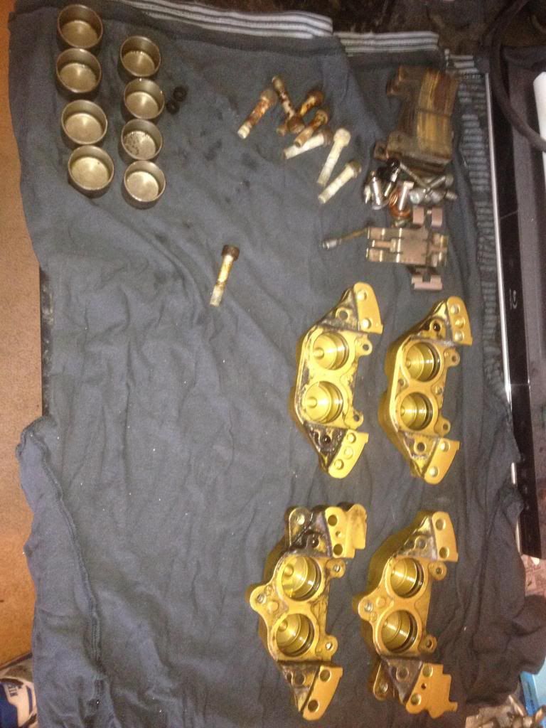

Full strip and clean in the seal grooves as they were binding slightly, yet they were pretty much clean......

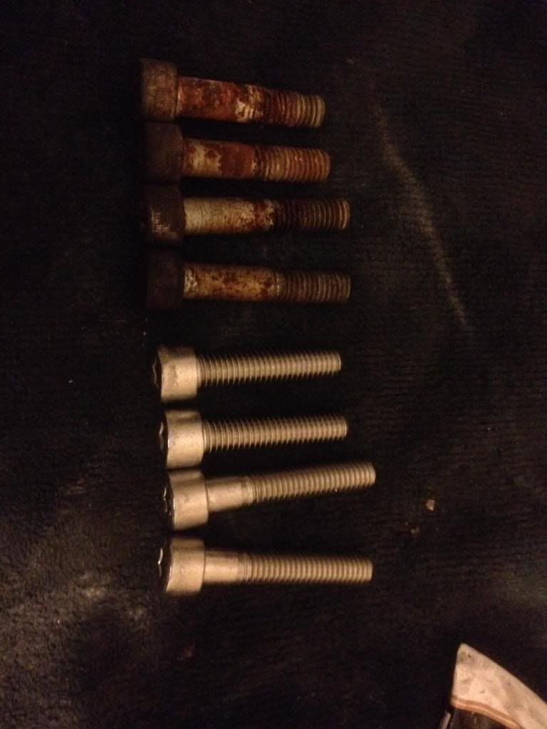

Then some new caliper half bolts turned up, stainless steel to replace the originals of course.
The loosely back together to wait for some goodies from Japan.
Goodies from Japan

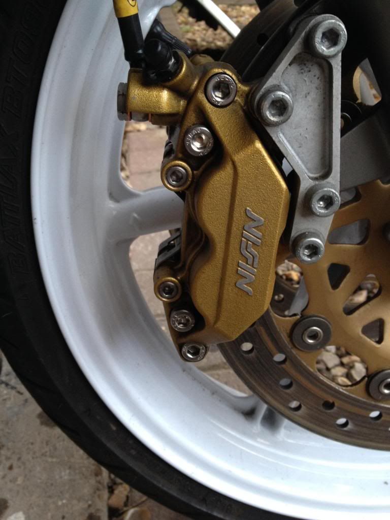

And a picture of the calipers full of shiny stainless.
Then earlier I fitted the calipers back on the bike and started my least favourite thing, twin 4 pot brake bleeding.
I hate bleeding the front brakes, it's a nightmare, and I'm still not convinced they're finished. Might just take it to the local garage and get them to have a try because I'm really not sure I've got all the air out. I can still pull the lever back to about 4mm away from the bar.
Also a quick pic of the CCFL rings I mentioned.
Goodies from Japan
