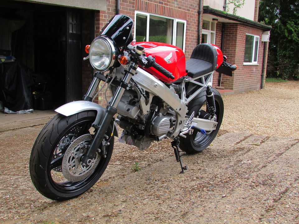

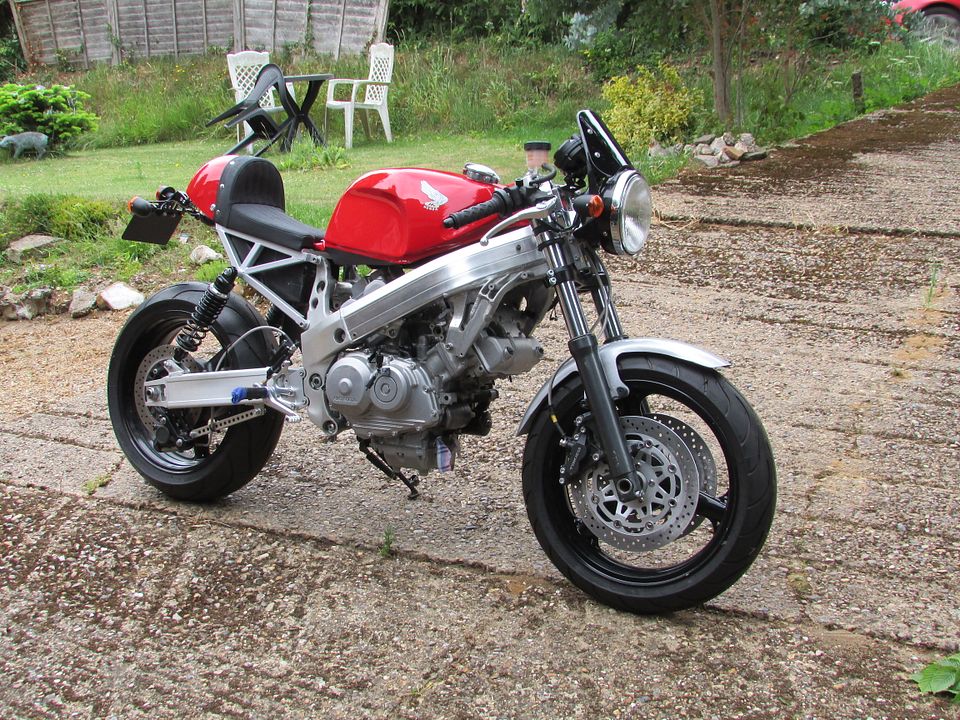

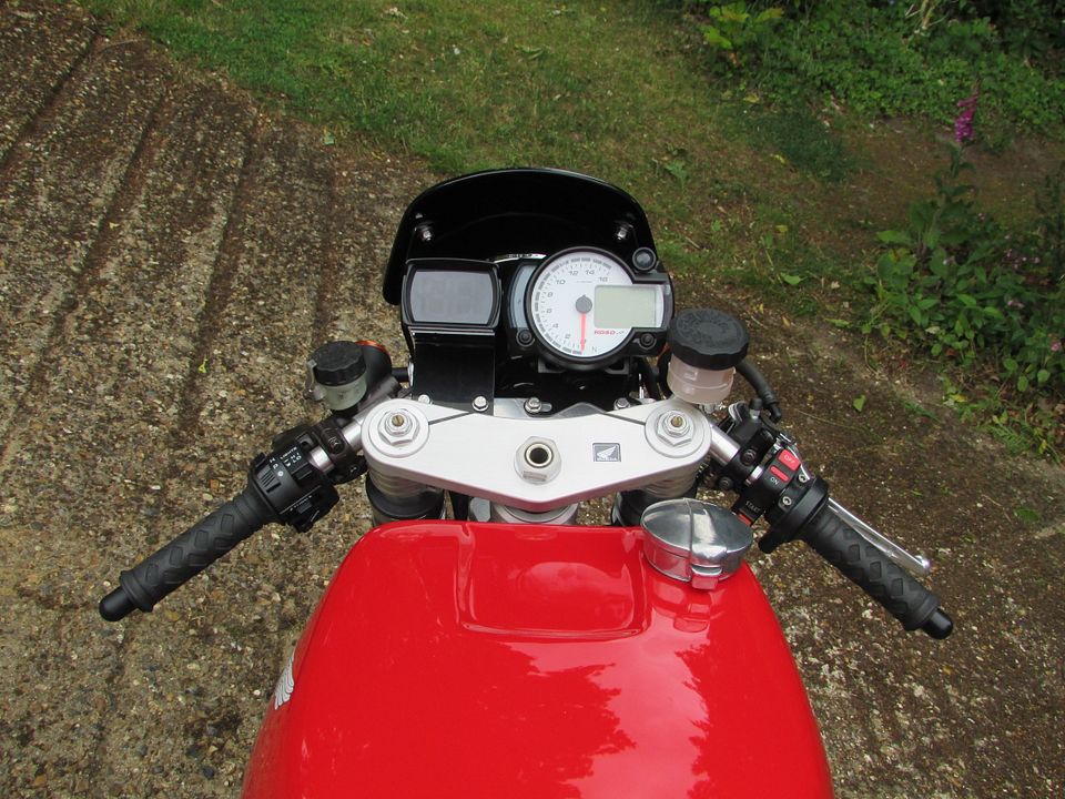

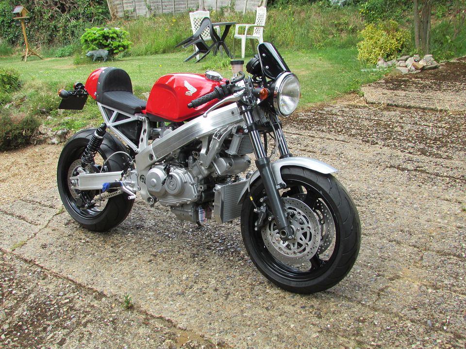

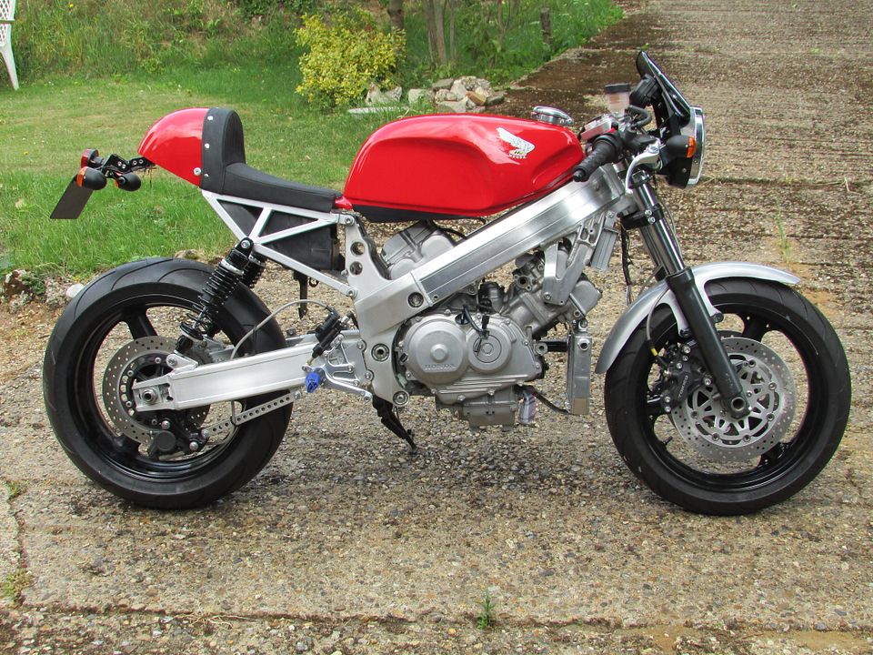

Looks a lot better with a bit more "meat" on it. Ha ha, you've got the same GPS speedo I use on my bikes :)
- RickOliver
- Posts: 492
Re: NC30 Cafe Racer

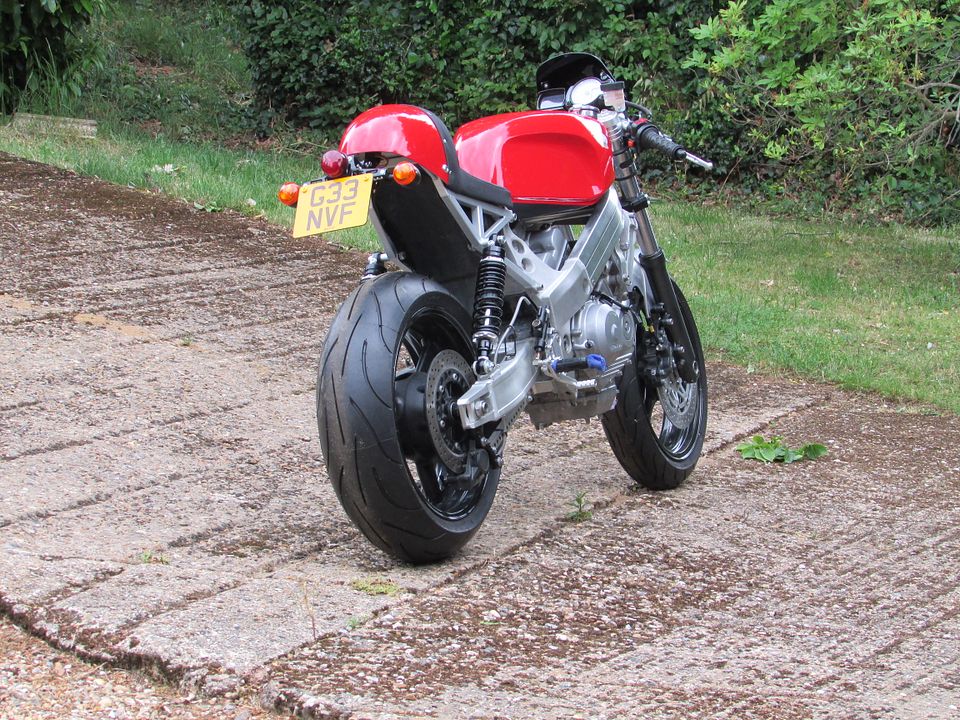

Yes - the NC24 sprocket cover plus hydraulic clutch means there`s no speedo drive and that GPS speedo is the tidiest solution - I`ve just got to make up a warning light panel to go in the gap immediately below it.
The ambition is to keep the look as `clean` as it is now by hiding all the electrical components and 90% of the wiring. You`ll see that there`s a cut down stock undertray/battery box inside the rear subframe - that leaves a wedge shaped cavity behind the battery which will contain the starter relay, flasher unit and the vacuum sensor for the `full synchro` 4-channel Ignitech ignition. That ignition system uses four CBR600RR stick coils so there`s nothing that needs mounting externally on the subframe or front engine hanger.
There`s a shaped horizontal mounting plate on the back end of the subframe which forms a floor in the seat hump and the ignition module, reg/rec and fuse box will all be mounted on that.
I`ll build a custom wiring loom and clip it along the inside edge of the frame and subframe so it will be completely out of sight.

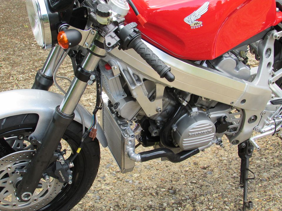

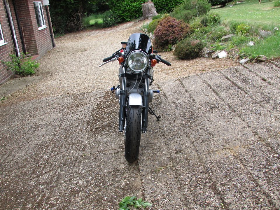

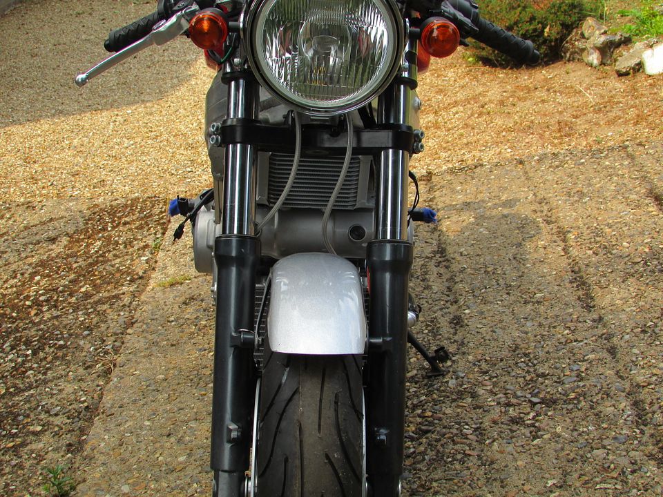

OK, here`s the first test fitting of the cooling system -
The custom built radiator won`t have the top left hose fitting and the top right one will be vertical and connected to a VFR800 filler neck which will be mounted at about the same position as the filler on the stock top rad.
The custom oil cooler will have the mounting brackets built in and the hose fittings will be on the side, not on the top.
There are front wheel clearance issues which will need addressing -
- but a change from the current 120/70-17 tyre to a 120/60-17 and a couple of inches trimmed off the back of the mudguard should take care of it.
The rad is currently on stock mounting brackets - if I can move it closer to the engine I will but I think that once the exhaust front pipes are on that may not be possible.
The idea of keeping a slim profile certainly works -
- the radiator is no wider than the fork legs and the oil cooler sits dead centre in the cool airflow between the mudguard and the headlamp...
