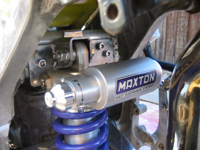

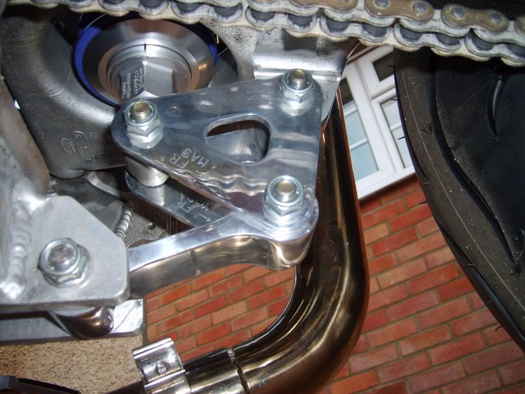

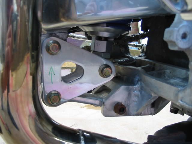

Re: single side swing arm
Sorry for the delay. Here's a few of the shock linkage, the top mount has been modded slightly from what you see here, just to neaten it up a bit. The bottom mount required some welding work as you can see, but the rest of the bottom mount is standard 3TJ
If you want any more, send a me a pm with your email and i can send over as many build pics as you like!
