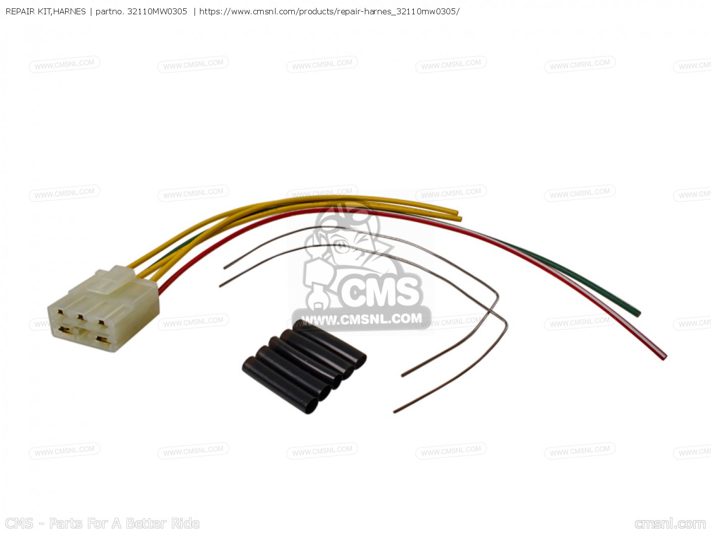

- JZH
- Posts: 249
- Joined: Mon Oct 27, 2008 7:02 pm
- Bike owned: RSCBRRVFVFRST
- Location: London, UK/So.Cal., USA
Re: Loose connection
That connector block is available. Honda Pn. 32110-MW0-305 is a repair kit that includes a wired plug, solder and shrink wrap.
Auto-electric places like http://kojaycat.co.uk/epages/950000457. ... nectors%22, Vehicle Wiring Products, Pole Volt and others also sell the connectors for reg/recs.
