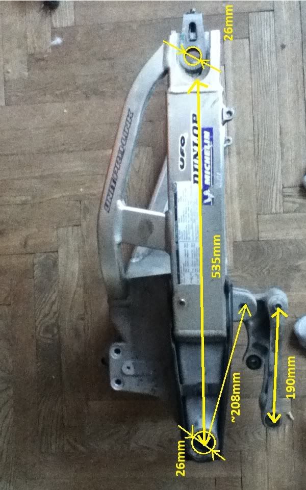

Unfortunately the earlier ones are 610mm long too.
That plan has just been filed under B1N

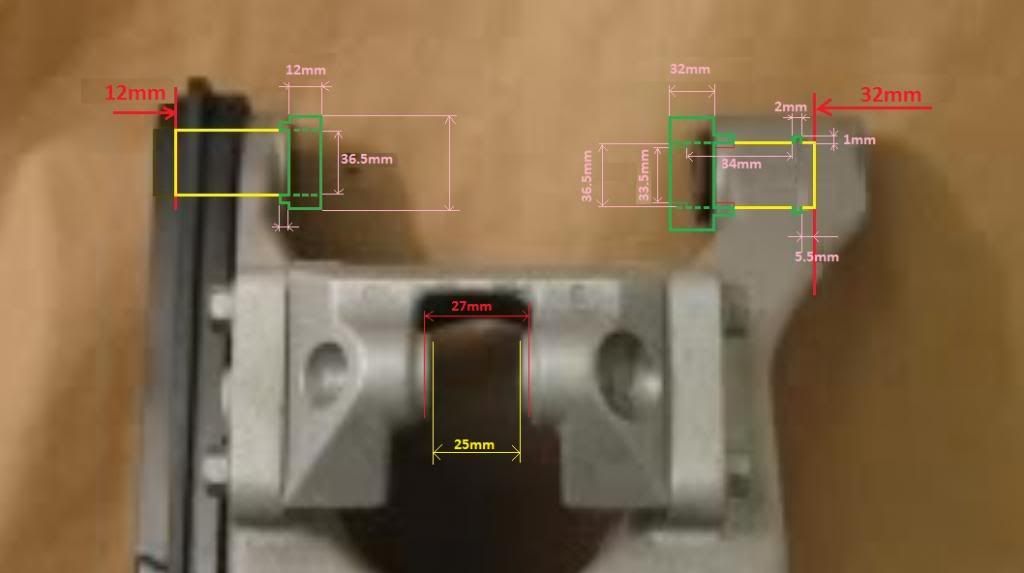

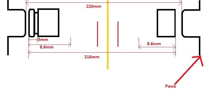

1. Red lines show how much need to be cut from each size to fit cbr600 swing arm to NC29 frame.
2. Green is extensions you need to fabricate to fit beating into the holes.
3. I'm recommend make extensions first, weld them and only after than cut from each side.
Here is measurement of NC29 swingarm in NC29 frame.
