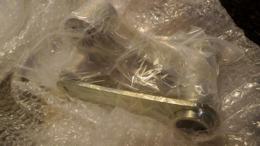

Well, guess what arrived yesterday. Hmmm ... mysterious eh ...
russle russle .. unwrap ...

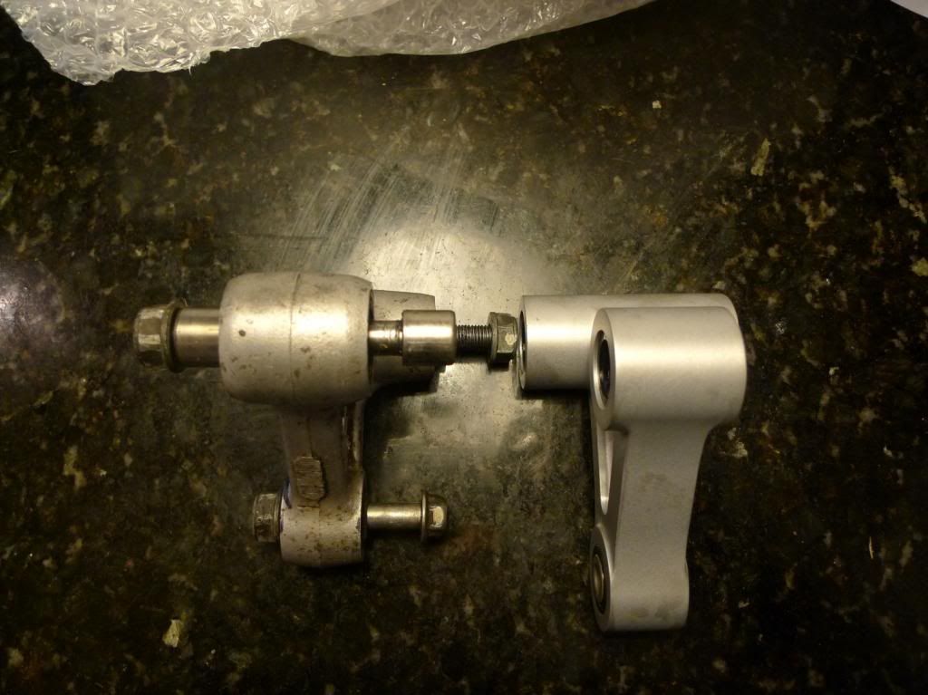

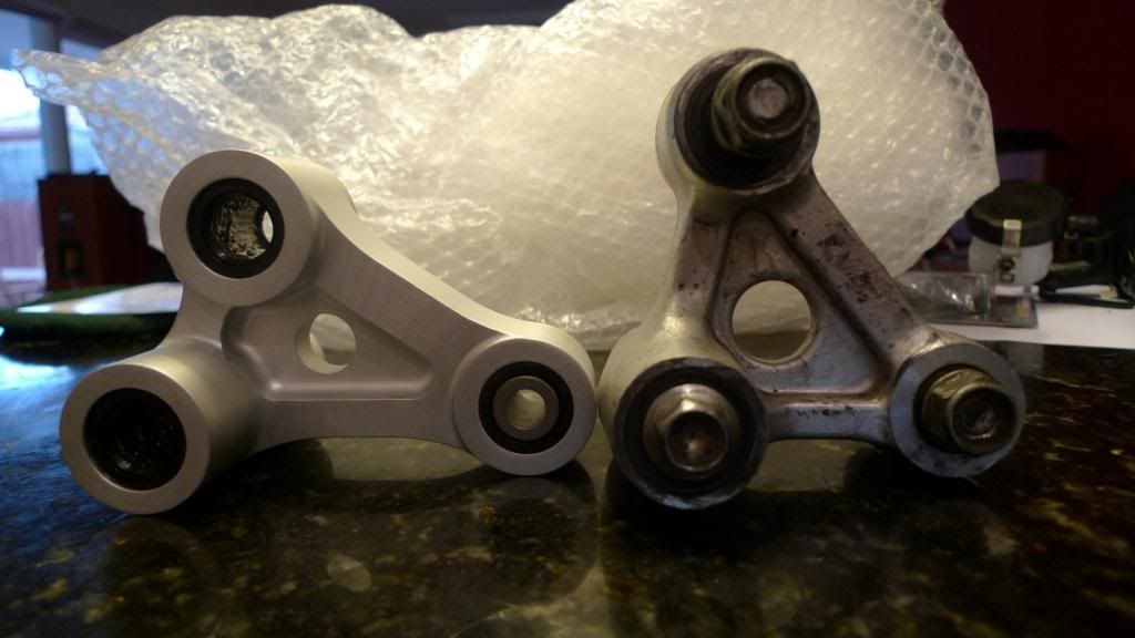

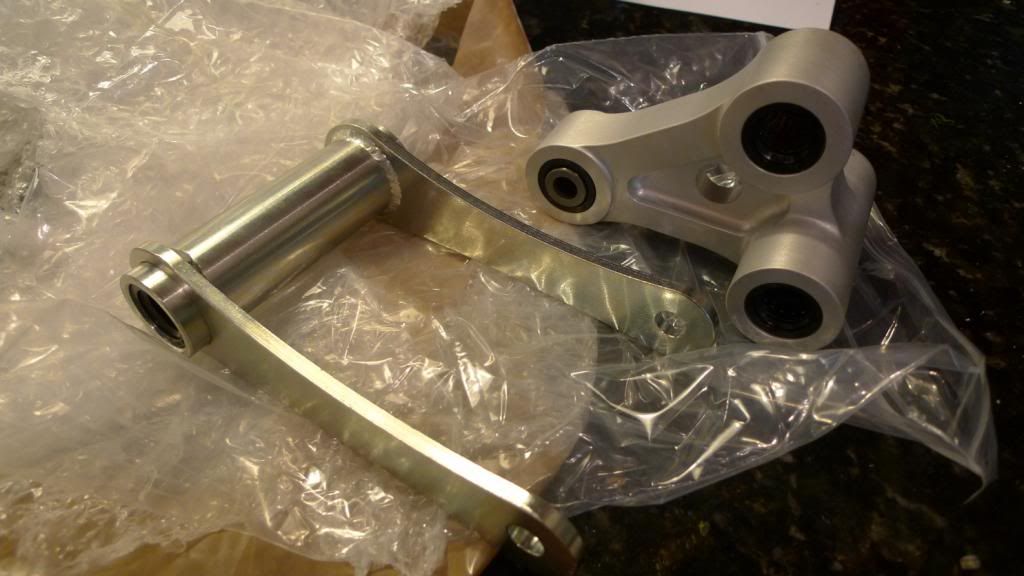

Bingo ... a Rick Oliver HRC replica linkage!
You'll need to sell your grandmother .. again, but I have a feeling it'll be worth it. Maybe.
Now, this kind of screws with my pic chronology but I thought as I'll be doing work on this in the next few days so I'll get some pics in.

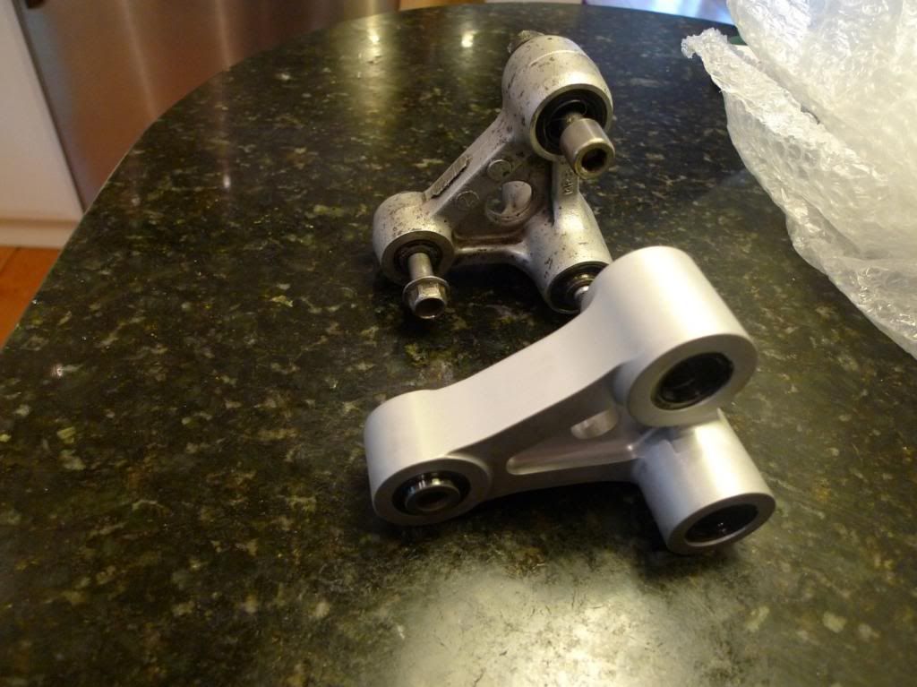

So, if you are like me, and just love this stuff, then you'll agree this baby is a work of art.

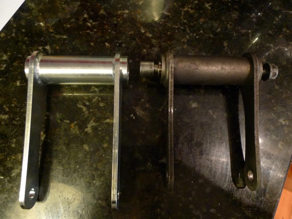

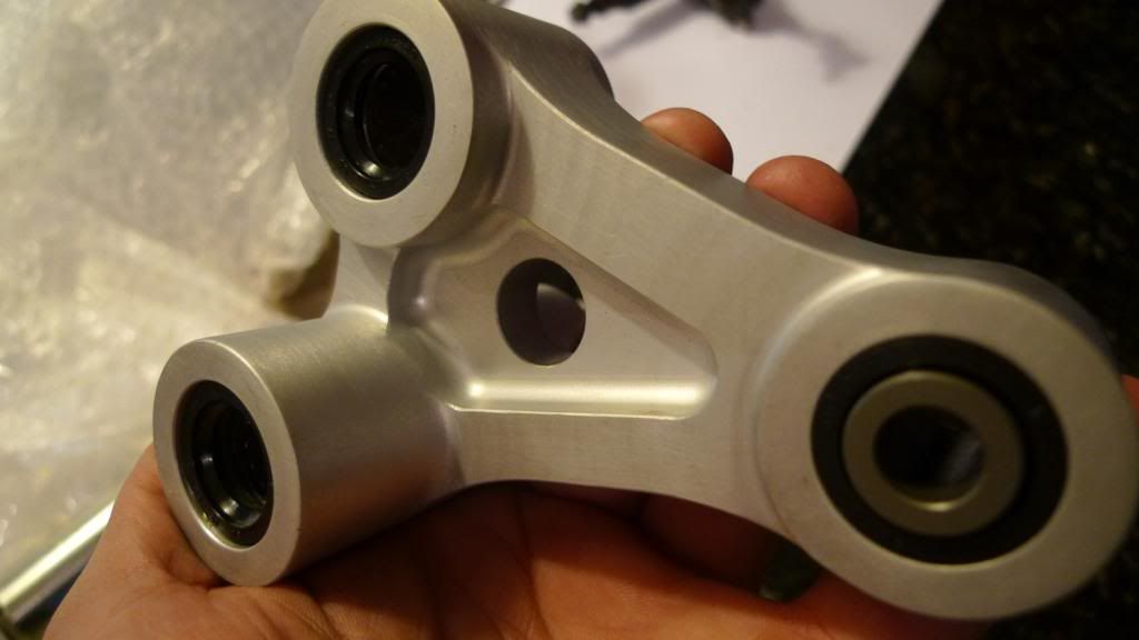

Comes with bearings installed.
It is clearly very different to the stocker. They have three holes and the widths are the same, but everything else is entirely different:

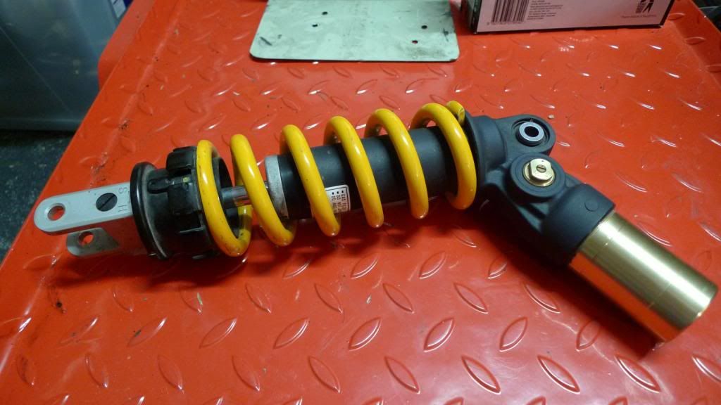

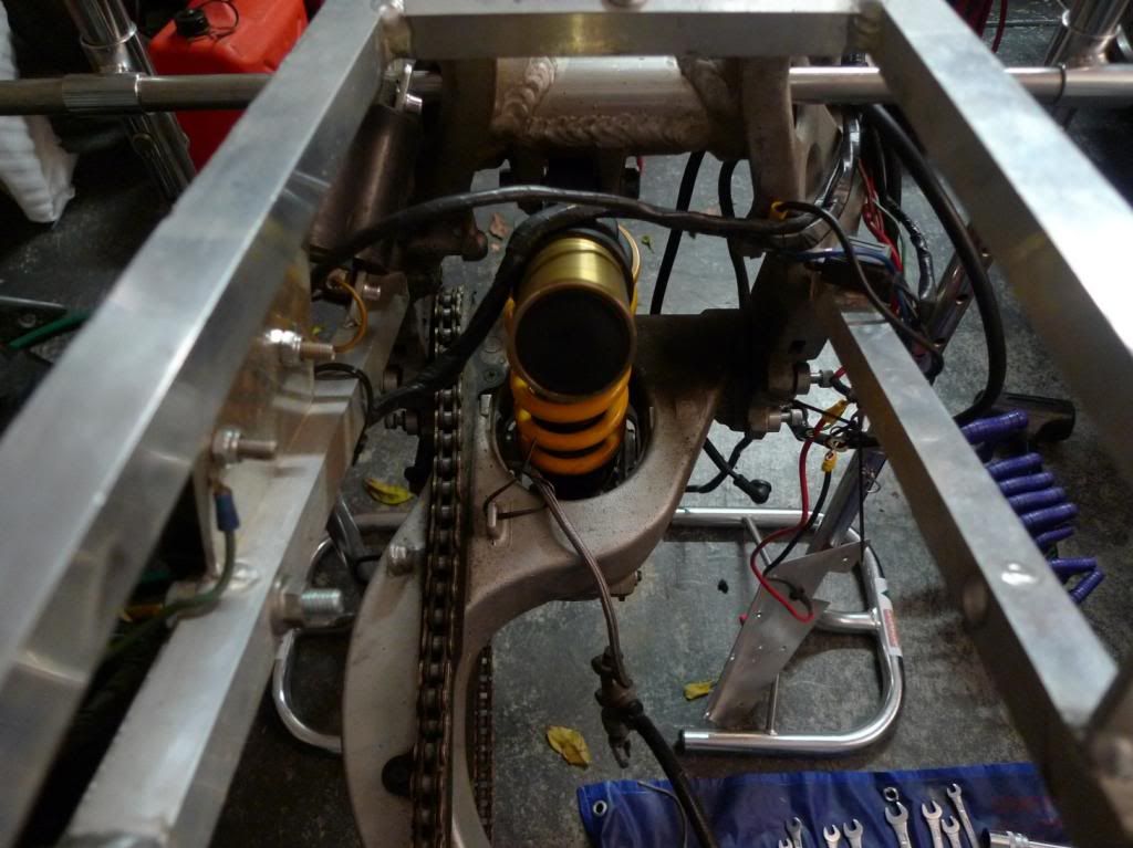

Here is the candidate:
It is a 2006 CBR1000RR fireblade shock. I got it for free. :-) Quick shameless plug: Thank you Ian Rider of Rider Brothers training VIC - he was happy to get it out of his shed and I was waaaay more happy to get it into mine! If you've not done their 'Knee Down' course - you are missing out. I never had my knee down before the course - simple afterwards. Nice one Ian.

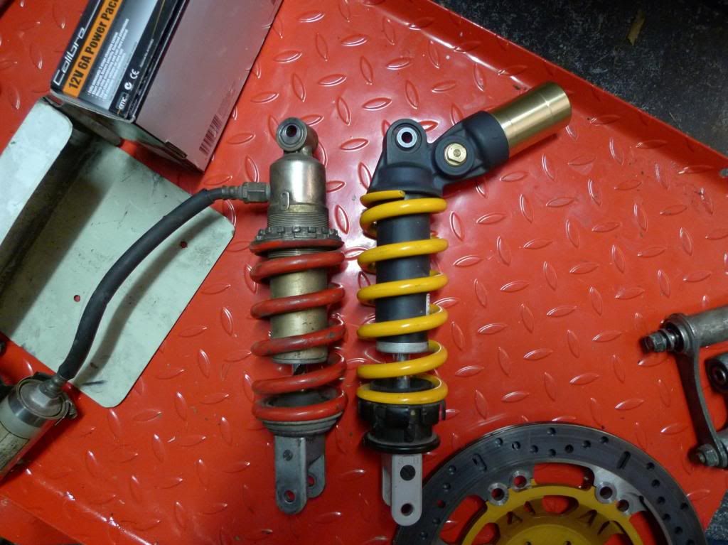

Ahem: back on track. Check it out in comparison to the OEM:
If you look at my OEM you'll see it has had every extra mm of height sucked out of it. See the eccentric at the top? This gave about 4mm extra height over stock. What an effort!
The 2006 CBR shock is 213mm in length. That is the north end of the HRC spec for rear shock length but better than the south end. :-)

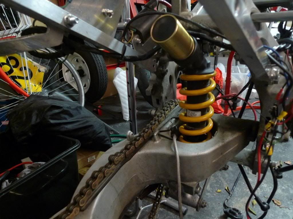

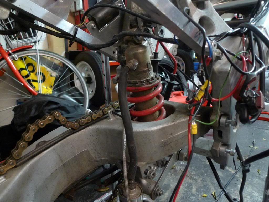

All bolts fit and it does go in. So from this:
to this:
Note this is an initial fitment without the HRC linkage. I was just stuffing around with 'would it fit?'.

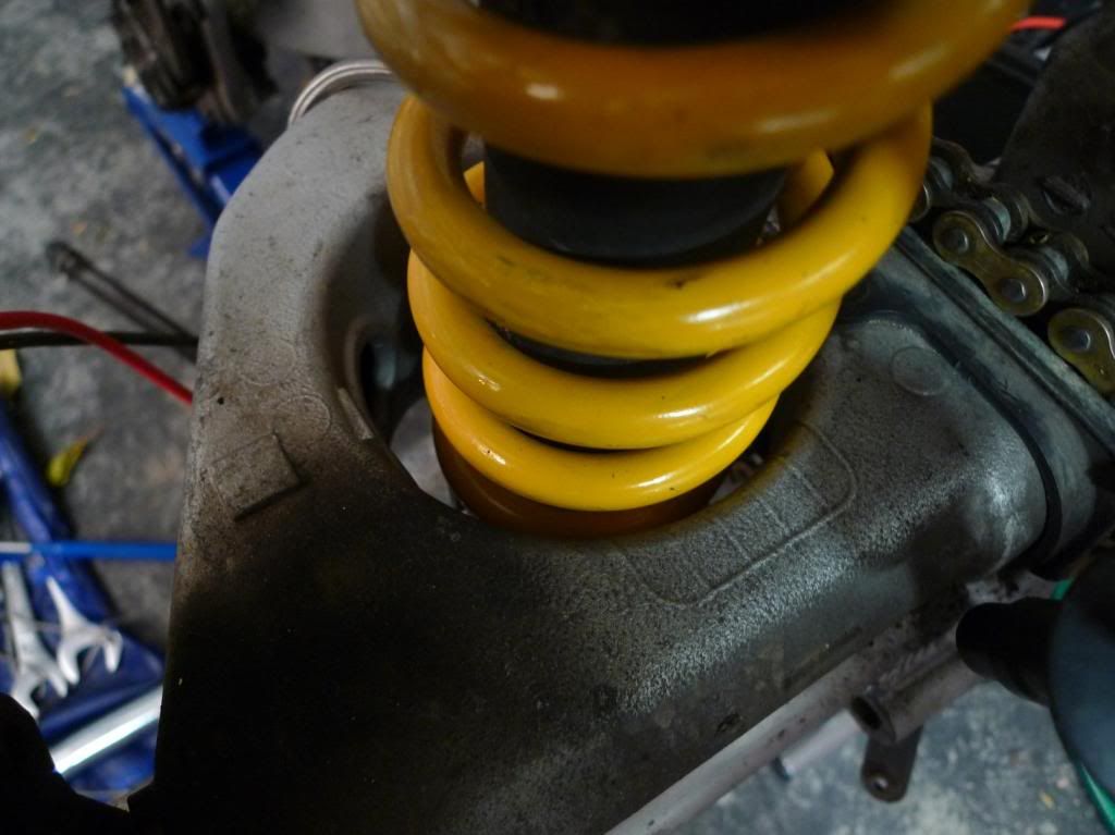

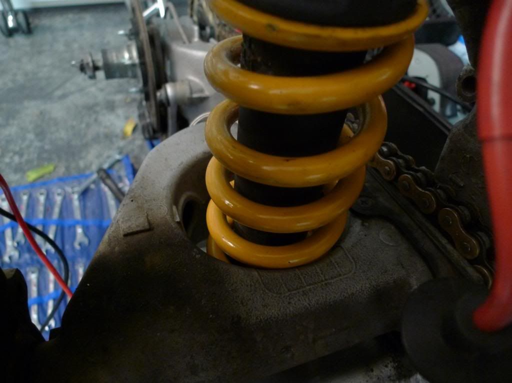

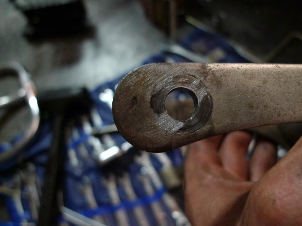

The first experiment was with my shortened pull-arm ('dog-bone') that had been welded up and moved (I think) 8mm in - to raise the height. This guy:
I undertand this is a common mod to get more rear end height. But .. the shock spring fouled against the swingarm:
Fitting a standard NC30 pull arm got it okay again:
Looks good:

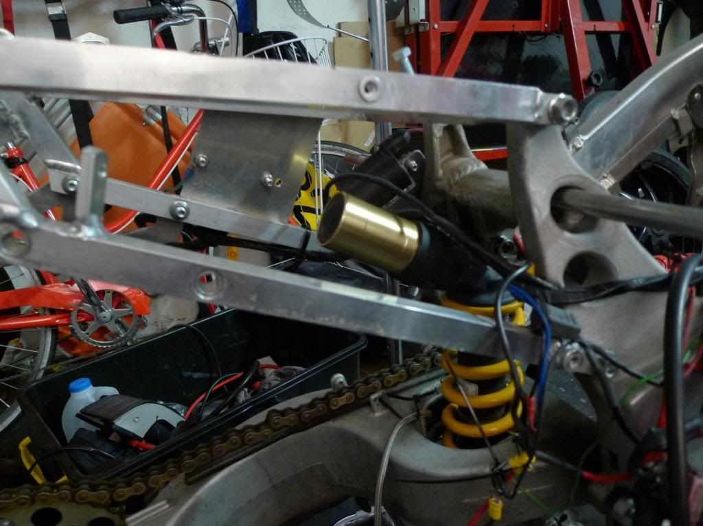

But ... (and there is always a 'but' or two):

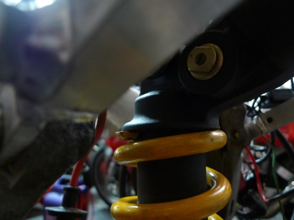

Compression adjustment is obscured a little:
and probably more important to most people out there is that you'll need to build yourself a new battery box. I have a RO race subframe but I imagine it is the same for EOM subframes. The gas reservoir sticks into the space where the battery would normally be - so that has to be moved back a bit:
I'll be building that with my 'tinsnip enginering' skills and posting it here. Wish me luck.
to this:
