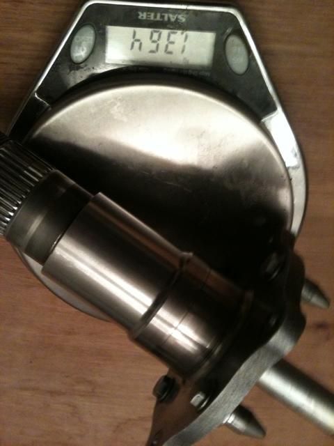

JC120 wrote:Just weighed my RS250 axle and it's only 1364 grams so I'm not sure now.
I miss something on this pic. Both nuts and wheel spacer
Michael
No nut or spacer, just the axle.

1440 grams include both nuts and spacer!!
