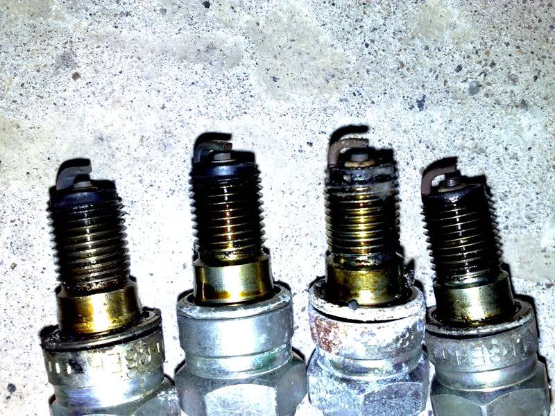

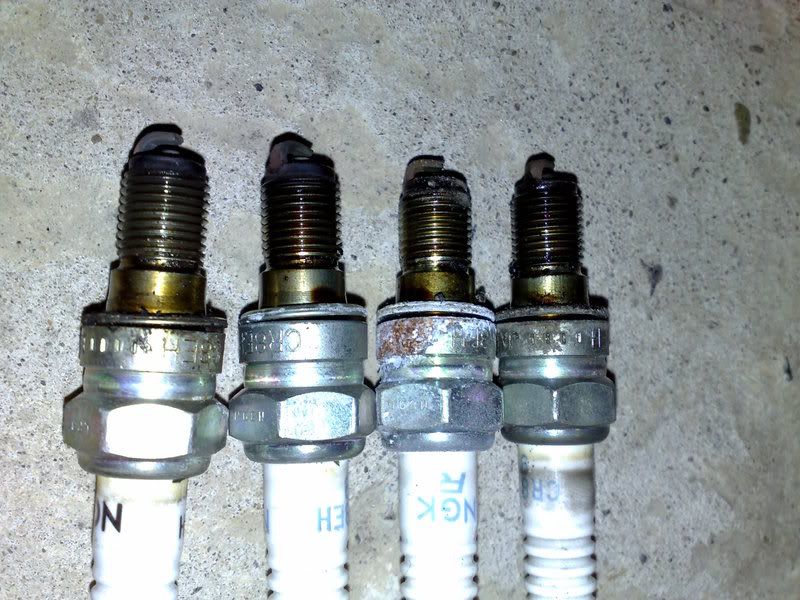

Well I have taken the old plugs out ready for the news ones arriving saturday (i hope). Ive taken some photos of the old ones in cylinder order, do these look like normal worn plugs? 2 Have some corrosion.

If number 2 is exactly as you removed it, then its not good at all. The gap is far too small. Regap it to 0.7mm and try them again. Better still, regap them all to 0.7mm and try them again.

3rd from left doesnt look healthy eighter.
agree on 2nd from left.. looks like its touching there..

Thats what I thought. got new plugs now, do they need to be adjusted or can they slot straight in?

Wow..you must have bought the bike with those plugs in it and have never checked them untill now?..
i have never seen an electrode do that to itself before! its a wonder that the engine was able to start up and run at all lol!..was the previous owner a school kid or a monkey perhaps? did you notice a slight hunch of the back or his arms scrapping the ground ever so slightly?
Seriously though those plugs look rooted i wouldnt re-use them, i'd say it would pay to go over that bike with a fine tooth comb just to make sure that there are no other hidden suprises..
