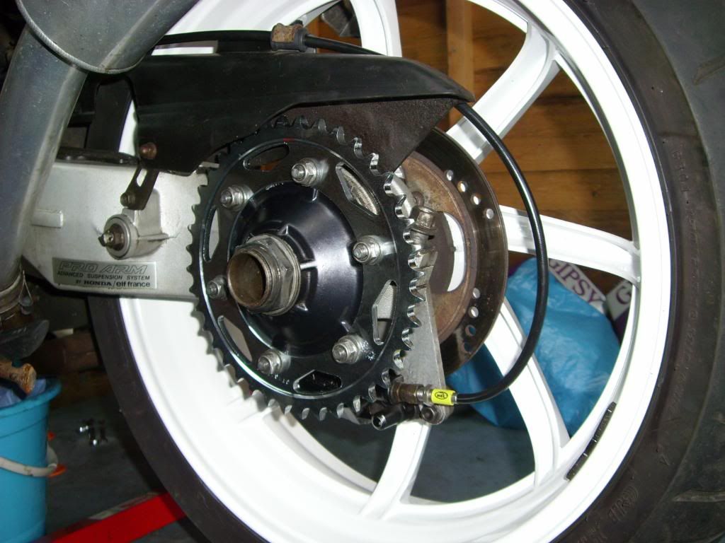

lizard821000
- Posts: 903
- Location: portsmouth
Re: HEL Rear Brake Line - Too Long?
ill get some pic, 10 mins.
Thanks mate, I reckon I have it right, I'll go measure it now.
By the way, the rear sprocket is fitted back to front.lizard821000 wrote:thats not the right one, iv got hel back line and its no were near that length lol
lol, is it!? will it matter
One difference I noticed was the number of rubber grommets or boots on this one compared to mine, I only have the one fitted, which is what the HEL line came with.
So I fitted this in the centre clip on the chainguard, which means its a bare line on the rearmost clip and the front clip of the chainguard, also bare where it runs through the clip on the top of the undertray, where I went wrong though was not running it through the U clip that the hose from the master cylinder resevoir goes, putting it in there as well seems to have taken up a lot of slack.
So do I worry about the lack of rubber grommets or not?
