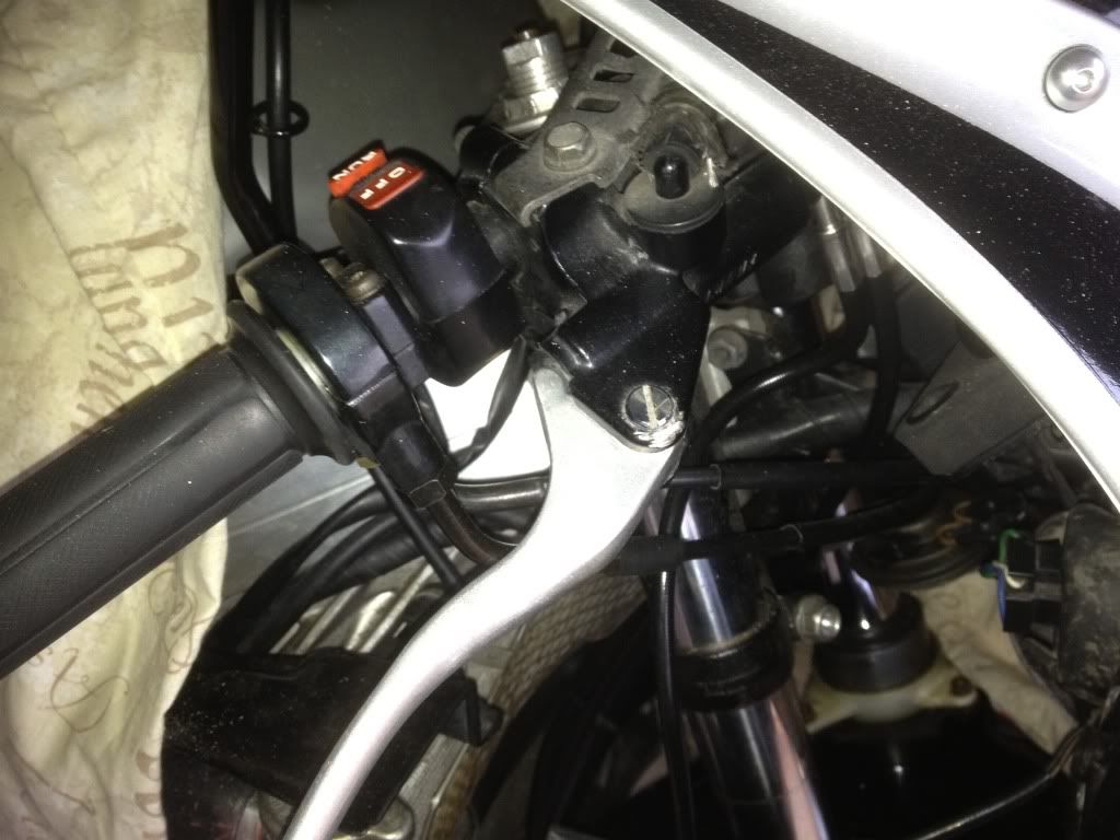

Have you checked that the brake lever free play adjuster is not screwed out too far?

Gadget wrote:Have you checked that the clutch lever free play adjuster is not screwed out too far?
The clutch is fine, I have tested the brake binding with my bike on my ABBA stand with my Dad standing on the back wheel and me trying to rotate the front.
I have re-bled the brakes and anything I can think of, all seems to be pointing towards the calipers, which I will be dealing with on tuesday/wednesday.
Thanks for the input though ;)

my bad...i meant brake lever free play adjuster

I didn't know there was one?

It's that big knurled washer on the brake lever.....if it's screwed out too far the brakes won't release properly.

I'll take a look, won't be til later though, off to work now. Damn retail job.

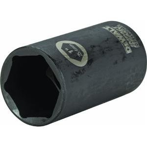

you can use a 10mm 6 point socket on the torx to split the calipers...

CMSMJ1 wrote:you can use a 10mm 6 point socket on the torx to split the calipers...
A 10mm hex socket?
Took a picture of my brake lever and master cylinder etc, can't see a big knurled washer myself :/
A 10mm hex socket?
Yes, an Across Flats one like this:
as opposed to this crappy type:
Yeah got one of those, cheers ;)
