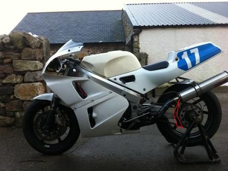

a bit like this, only well a lot better but it gets the basic idea across better than my half arsed explanation above.

For racing thats not possible i dont think, my understanding is the brakeline needs to be moved away from the chain and supported by a bracket, a bit like this.
it cant really be zip tied to the swinging arm as it will be too close to the chain, and would risk being severed.
That was my first rough rear brake bracket, Ive altered it to look less agricultural since.

Then yes, there's no reason why the rear brake line support can't be integrated into a shark fin. If you send me a drawing I'll make a prototype up. Would you mind checking it works ok?
