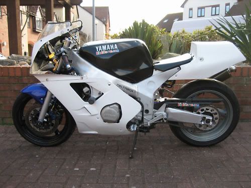

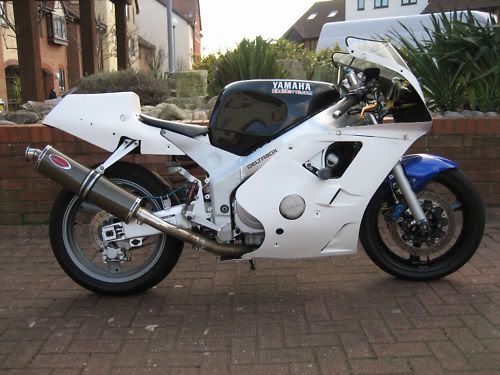

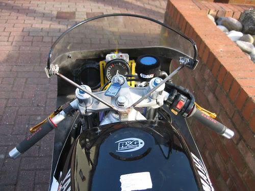

Here's some pics of the bike i spotted on the 'bay
Not the clearest but it looks like standard yokes with R6 forks, wheel, discs & blue spots......
Re: R6 front wheel options
Fit it all up and see what you get then, but you might need some different spacers for the front wheel.
