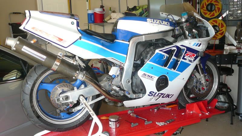

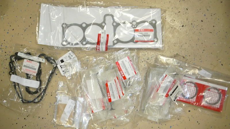

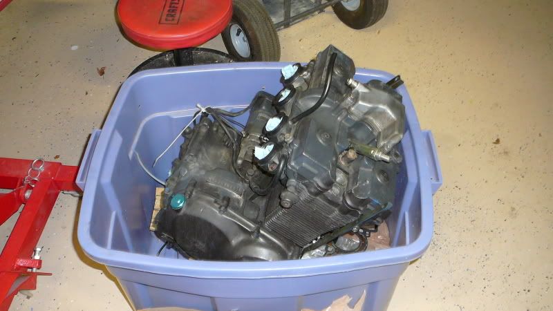

Since the bike is in Fred Flinstone trim I thought I'd give an update. A couple of months ago to took the egine in to be looked at. Everything was going good until we discovered very little compression in one cylinder. Once fully pulled a part the egine needed a whole new set of valves. So, $800 in parts later she is buttoned up and ready to go back in the frame. I'd like to thank the US governmnet for devaluating the dollar to not much more than a damn peso. Since it was apart I couldn't resist letting the mechanic do some mild head work.
The frame got new bearings all around. The shock was rebuilt and the forks freshened up. The brakes were a mess so I rebuilt those as well.
Next on the shopping list is a full exhaust system. I really blew it, there was a rare Autorimessa system on Yahoo Auctions Japan and I tried to bargain hunt and someone else got it. Anyone have an aftermarket system they like to sell? I've really been surprised how many one off parts the GK76 has and how rare parts are for them. Makes my VJ23 parts look darn right common.
This is what she looked like to begin with. She had been neglected for quite some time.

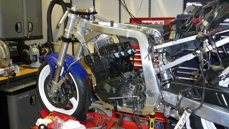

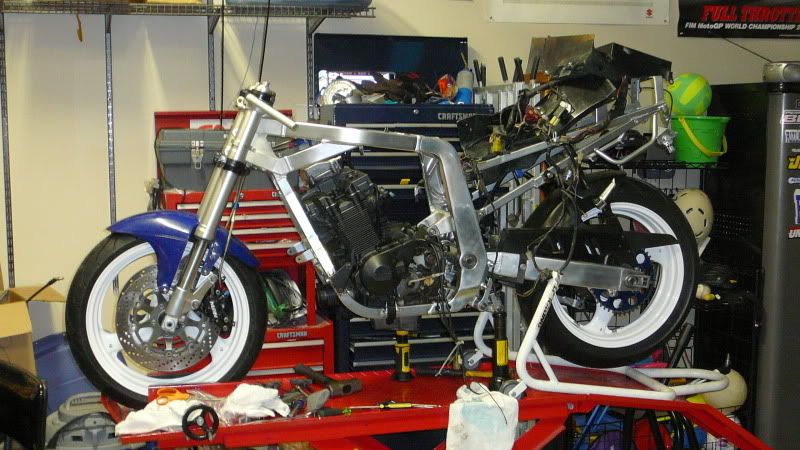

Engine went back in with minimal fuss.

The white wheels set ya bike off much better than the old color.
