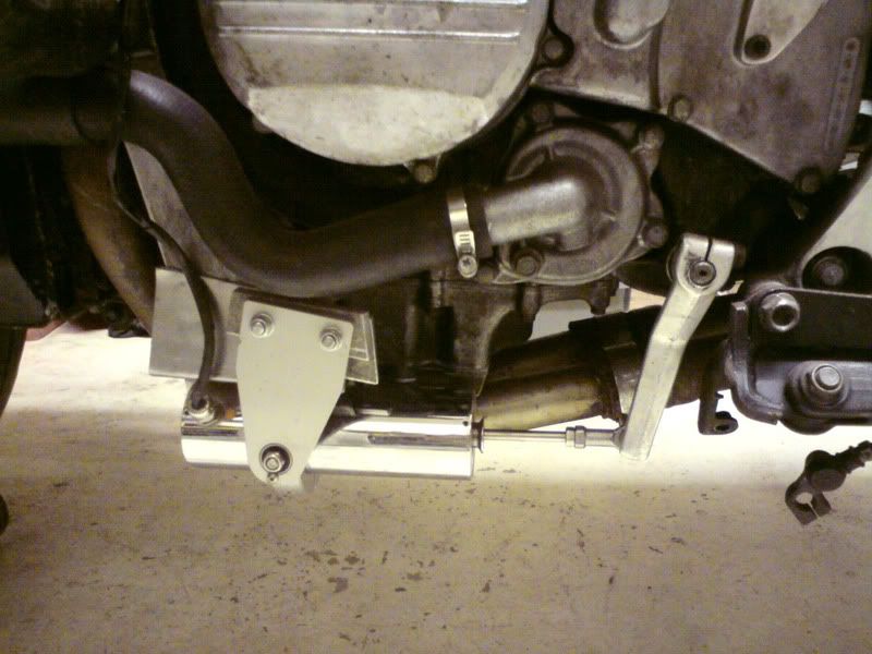

No its an electric actuator that pushes a bar in or out. I connect this to a gear peg from an Aprilia RX50 that i have mounted facing down towards the ground. I will see if i can dig out a pic.
The trouble is the actuator is catching on the fairing and not able to move so it was getting hot, and stopped.
I just need to adjust it a little and it will be fine

Pic of the actuator, it's a bit Heath Robinson, but it works once it's set rightCMSMJ1 wrote:cool - sounds good.

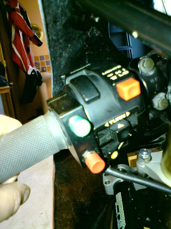

Re: nc35 struggles after 11k
Handle bar buttons pic

Cheers Old Painless, i need to get some exhaust wrap to stop the heat transfer from the front down pipes, as this can slow the unit down a bit.

Im presuming its an electromagnet / solenoid ?

Yes sure is, and that's a bit of an issue with running total loss, as the unit is like shorting the battery each time you change gear. I am going to have a run on track with the genny disconnected and see what the battery hold up like after 2 then 5 then 10 laps, and see if i can make a full race distance/weekend.Old Painless wrote:Im presuming its an electromagnet / solenoid ?

Shorting the battery ? Pulling too much current ? Shouldnt do anything but use power normally.
