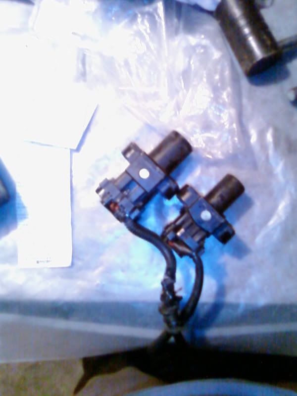

Re: CBR600RR07 forks on NC29?
Key swithc is interchangeble..

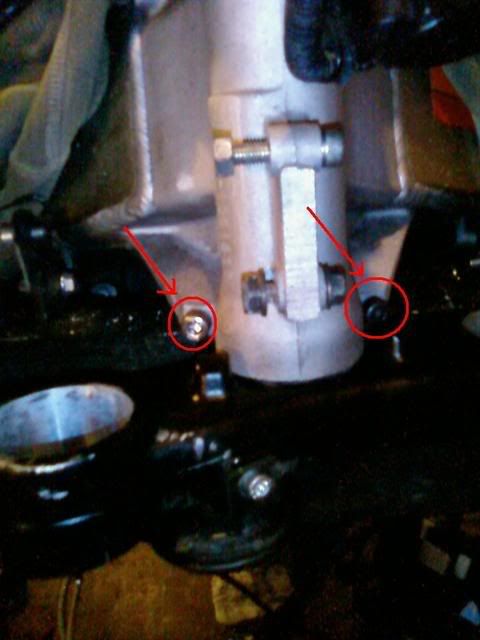

PARUS
- Posts: 1160
- Location: Seattle, USA
AND DON'T DO THIS. THIS IS NOT NECESSARY
