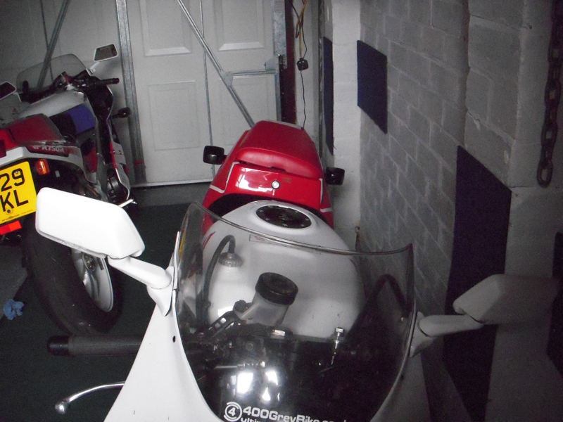

Post by CRM »
they fit pysicaly once you have ground one of the lugs off, they are the same as your nc ones (mounting wise) apart from the stud spacing is about 10mm futher.
here is a pic

Post by CRM »
i replied saying yes they do, but its academic as you cannot buy UK NC30 mirrors for love or money. they disapeared around 7 years ago and second hand ones - well i havnt seen any for 4 years odd now and they were junk
if you want white like my pic shows the only oprion you have is to buy RC30 mirrors and chop
