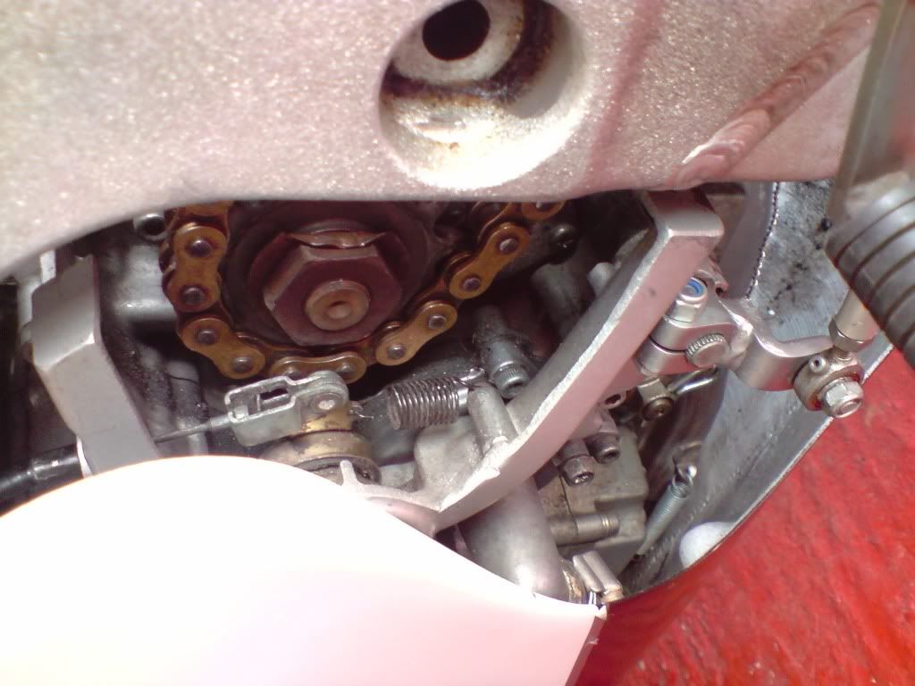

Hope this helps. You have 2 choices.
1. you need a selector shaft clamp with a step like mine so that it can be rotated and clear the sprocket cover.
2. there is no reason why you cant cut more of the cover away to allow the original clamp to be rotated.
I run a normal road pattern on my race bikes and never found it a problem.

The stepped clamp on mine is part of the rearset (expensive jap market items called Coerce)
Maybe worth a look on ebay or posting in other forums to see if any bikes use the stepped style as standard.
If you do cut it away there is next to no chance of making a balls up, there is very little behind the cover to damage.
I use a round hacksaw blade, remove the clutch push rod system, use the inset of the cover as my cutting line and off you pop.
If i was you i would just cut off the last couple of inches to leave you plenty of room for your selector clamp(i think that is the correct word)
