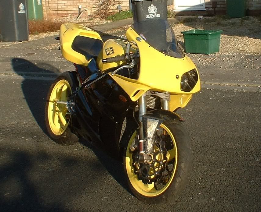

There are lots of options it all depends on who much work you are willing to/capable of doing. Personally I use a Tyga suzuka nose cone (direct fit as are the spark units) and a Mito evo tail/subframe combination but these do involve a reasonable amount of work to fit. I believe that there is a mito/nc seat conversion finishing on ebay today if you are quick.
Theres mine
Theres mine
