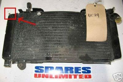

Ok. Thank you. Thinking to fit something like this.

waza on here i think uses the standard rad with the f2 lump and the plumbing was a major pain in the bum.so i would assume the hose points are at the wrong ends for the 4 lump?
- Posts: 1160
- Location: Seattle, USA
Re: Radiator from CBR600F2 to NC29. Possible ?
firebeast wrote:waza on here i think uses the standard rad with the f2 lump and the plumbing was a major pain in the bum.so i would assume the hose points are at the wrong ends for the 4 lump?
It's almost same except small pipe at the left
