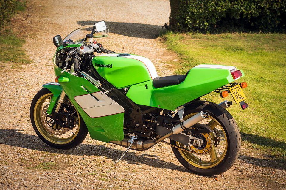

My aim is to produce something similar to this KR-1 that I built a few years ago but with 50% more power -
I have re-polished the frame rails and swingarm, polished the cradles and finished everything off by buffing with Belgom, which has wax in it and is supposed to prevent corrosion - the bike will probably never go out in the rain so I think that will be good enough.
Here`s where it`s got to as of yesterday...
- Posts: 7166
Re: NC30 Cafe Racer
That is also very cool indeed :) Loving your work Rick
