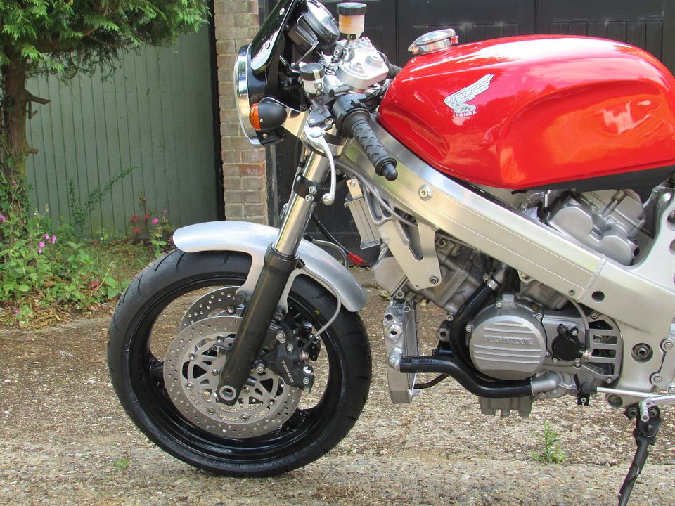

It gets a big thumbs up from me. Still not sure about the height of the rear hump in the side-on view though. If you follow the curve of the tank as it dips down towards the seat and continued it into the rear hump it would drop the height by a couple of inches...
But I guess aesthetics are in the eye of the beholder.

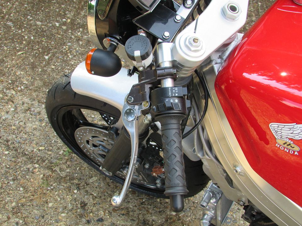

I`ve sorted the front end clearance issues with a change of tyre and mods the the mudguard - not entirely happy with the look of the mudguard but it will do for the moment, problem is that it`s impossible to find a classic styled guard which actually fits a 17" wheel, they are all designed for 18/19".

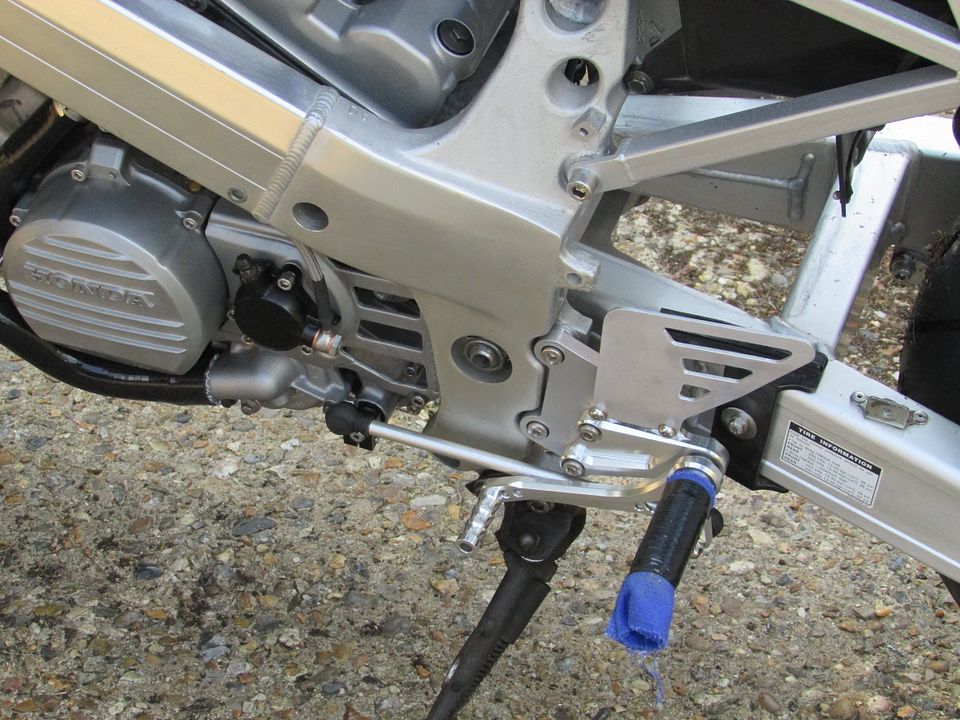

I have rebuilt and refurbished a VTR1000 clutch master cylinder and had a HEL hose made to fit, also built the gear linkage and made a new heel guard plate for the rearset which echoes the shape of the front sprocket cover as the original looked completely wrong -

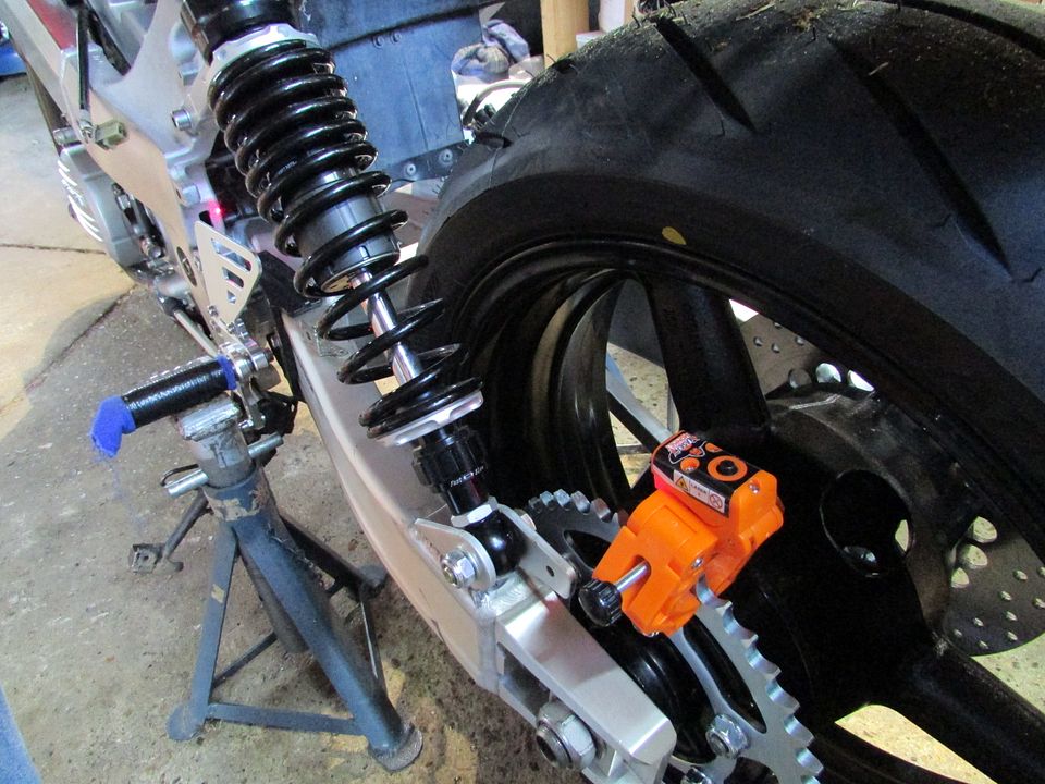

Next challenge will be getting the chain run right - laser alignment tool shows where the centre line of the 525 chain sits at the moment - happily there is plenty of tyre clearance and enough meat on the XJR sprocket carrier to allow me to machine maybe 8mm off the mounting face and move everything over to the right a bit.

One big issue I have to fix is with the chain - I hadn`t really registered until I started measuring things just how far out the chain sits on that XJR1300 rear wheel. I needed to move the rear sprocket over to the right by around 20mm to align with the front and there`s simply not that much metal available on the carrier to machine away. Plan `B` will involve a spare ZX-6R wheel that I found in my loft - it`s a 5.0" instead of the XJR`s 5.5" rim, which is better, and the hub is much narrower though it will need a bit of bearing/spacer juggling to accommodate the 28mm rear wheel spindle.
